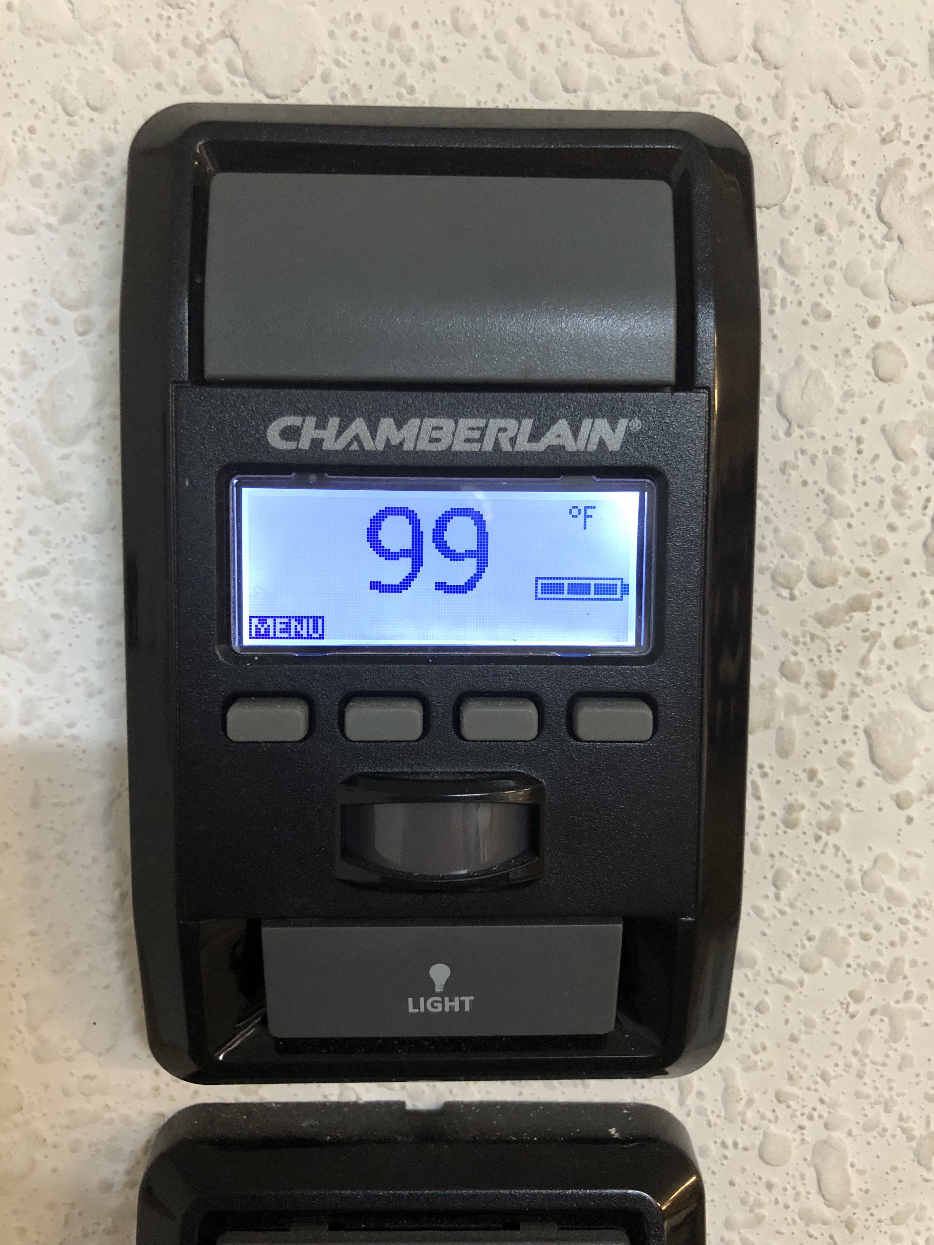

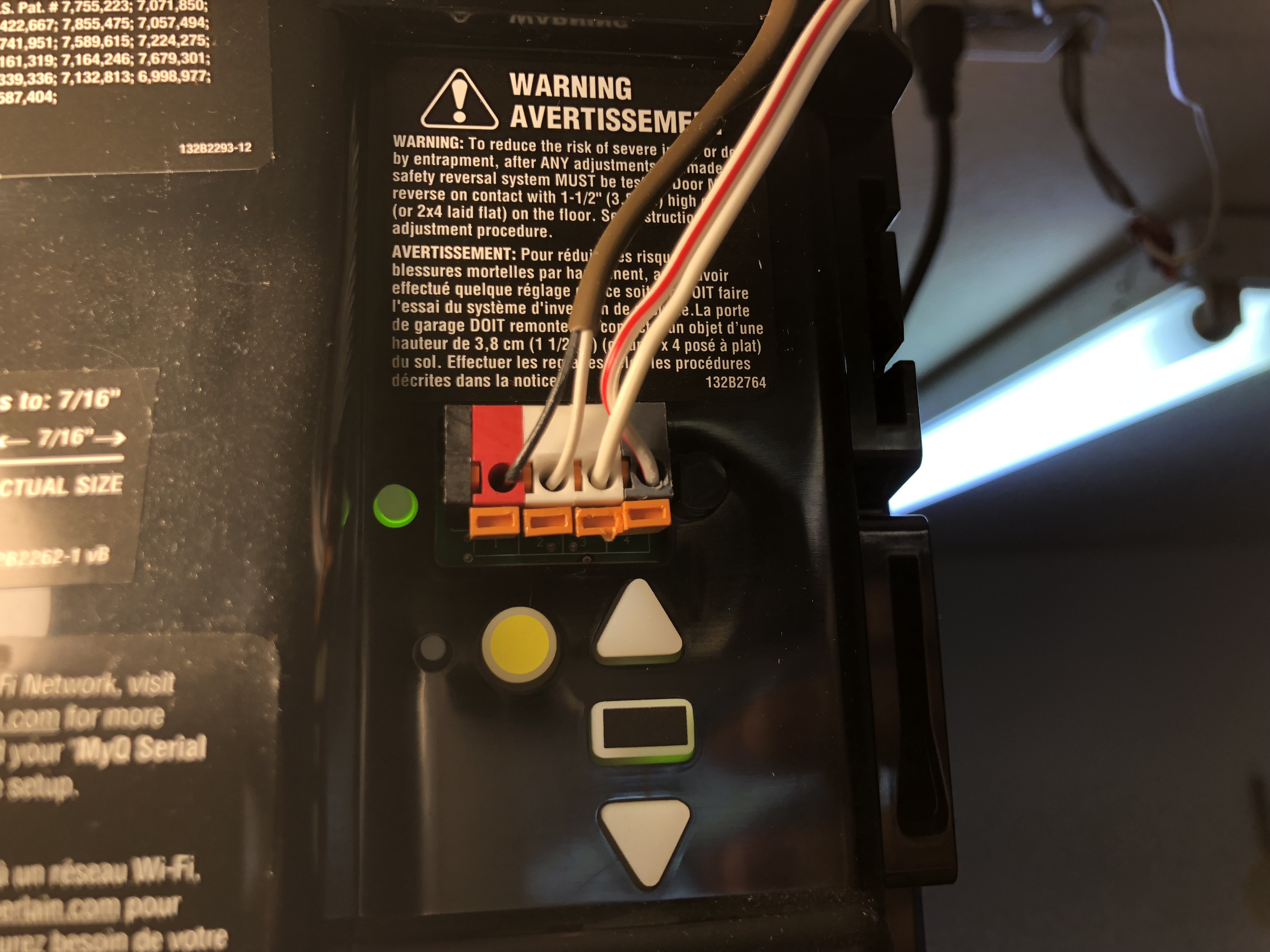

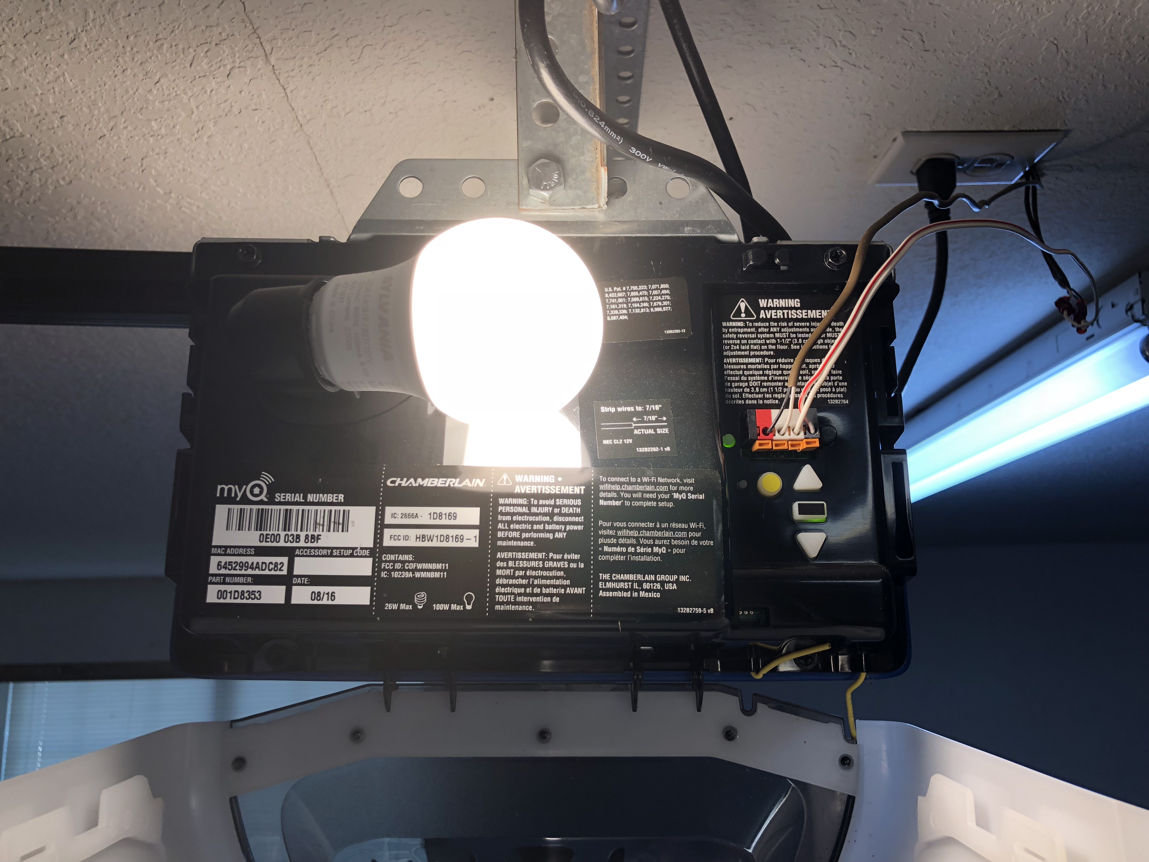

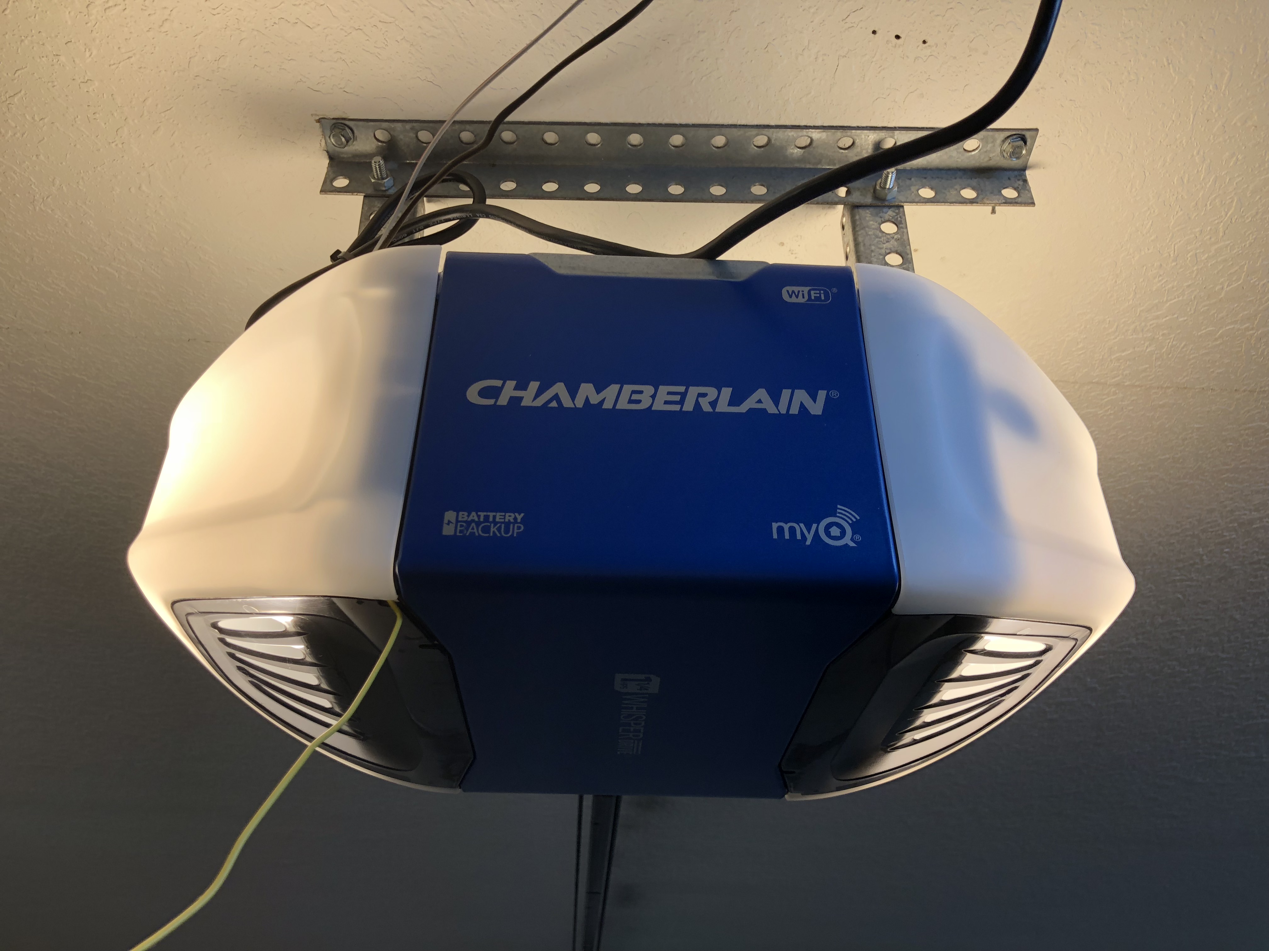

Our opener has 4 wires from each control module. Here are some pictures of ours for your viewing pleasure.
Reactions: ActionableMango

Thanks for taking the time to take and post those!
You are welcome.
