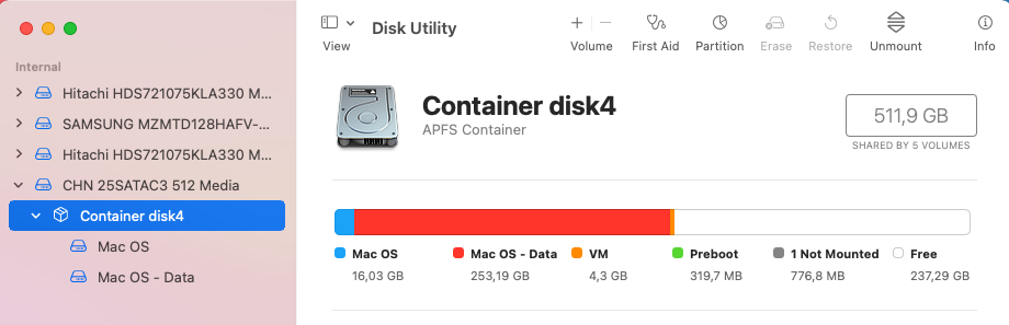

In catalina and big sur has made it that you have seperate volumes for your data and for system files. Because that is more secure. If you open disk utility you will see that there are multiple apfs volumes that make up your boot drive. I have attached an image of how it look in disk utility for me.
Mac os does this automatically with the install, since catalina.
It should not take up more space, its just that your data is seperated from your system files.

Thx for the response, but this is not the issue. My drive is split as it should be. There is basically a duplicate of most of my files on the same drive that is not visible in Finder on the invisible top level /Volumes folder.

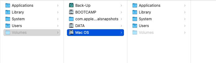

Maybe this will explain it.
Maybe what you are after below:
I think it is normal, if this is what you mean. The volumes folder should be hidden, maybe you unhid it on accident.

If I understood him correctly it was less on accident, and more a case of not understanding what he found.
Sort of like in the terminal doing cd / and being confused by it not looking like it does from the "top" in Finder.

Volumes is a UNIX "folder" showing the mounted disk volumes. It's not a duplicate but a system folder of aliases to each mounted disk. What you see in "/" is a combination of "/Volumes/iMac" and "/Volumes/iMac - Data". Other disks you plug in to your computer or disk images you mount will also appear in "/Volumes".

I get this, but something still isn't right. For example, on my MacBook, /Volumes takes up less that 1 GB, and in it are two items: Recovery and Preboot.
On this iMac, /Volumes contains the one "iMac - Data" folder ("iMac" is not the name of my hard drive, which is called the default "Macintosh HD"), and in that folder are all the content of my hard drive. It also really takes up 1 TB, and this is real storage space as best as I can tell.
WAIT, I just thought of something. Is it possible that this entire folder is related to an old clone HD called "iMac," hence the name "iMac - Data"? That clone drive is no longer active, definitely not attached, and may be literally deleted and gone.
