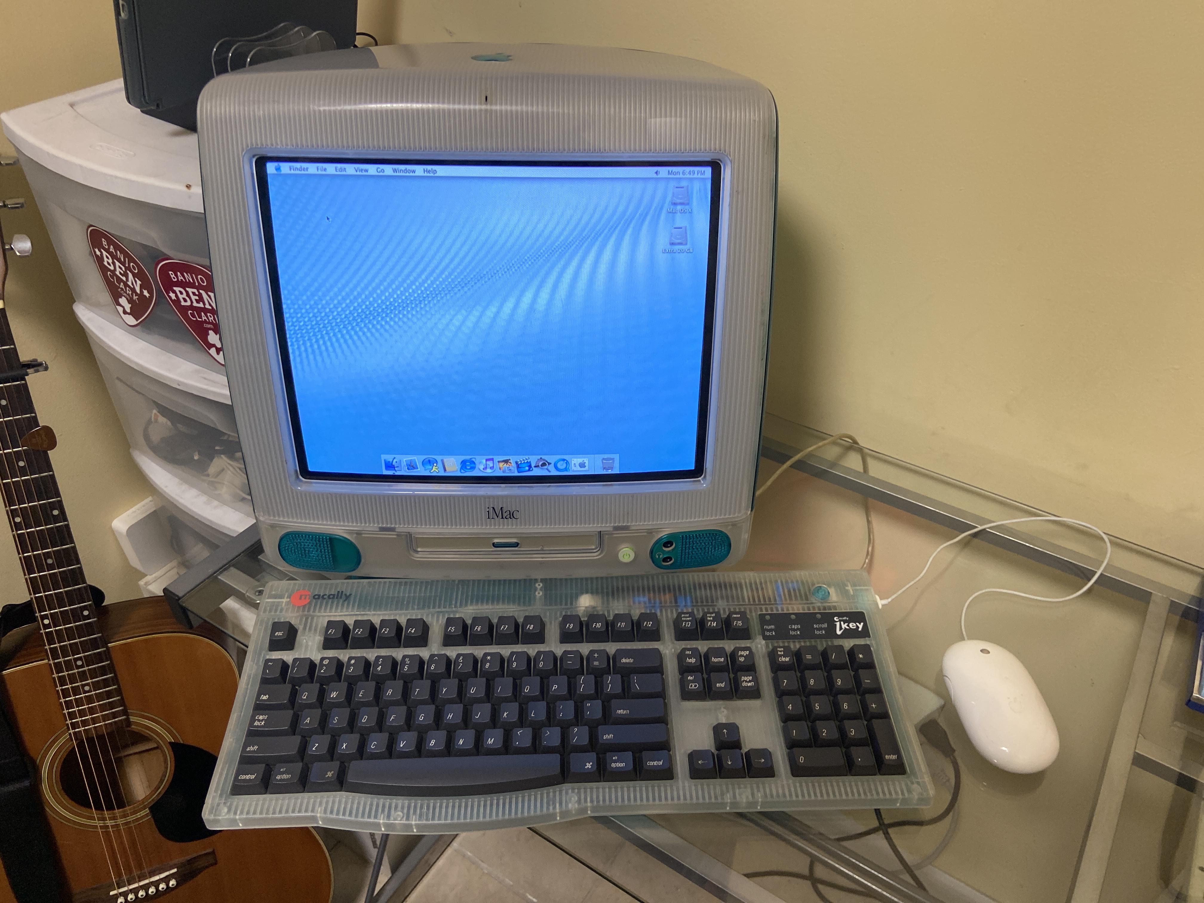

Here’s the machine question in case anybody wanted to see it. My blue puck mouse is on the way.
It also has 512 MB ram but it only addresses 256. I guess some of them randomly can’t address 512 according to some articles I read online. I have a lime slot loader as well.
