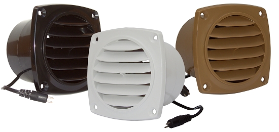

It's a thin square shaped fan. Usually seen in desktop power supplies. They come in 12v and 120v versions.

Here is one.

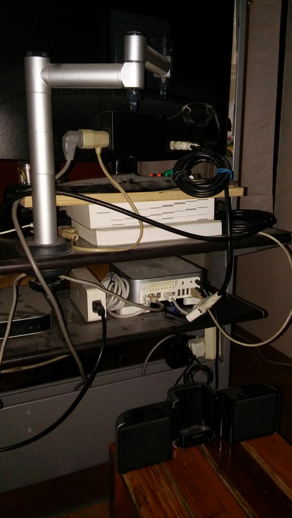

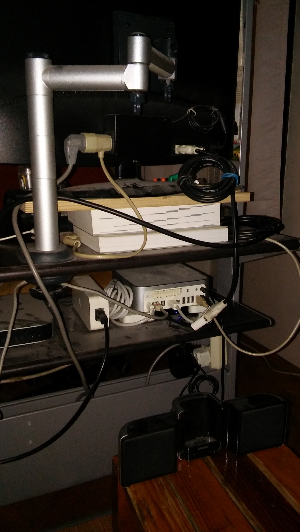

I've kept my 2012 mini in a large desk drawer for as long as I've had it. I did drill holes into the back of the drawer to increase airflow, but it's usually a little warm in there, not hot. If I do something like work in FCP or Logic it can get hot so I open the drawer to cool things off.
I'm sure it's not wise to do this, but it ended up not causing a problem in my case. It's still in that drawer right now working fine.

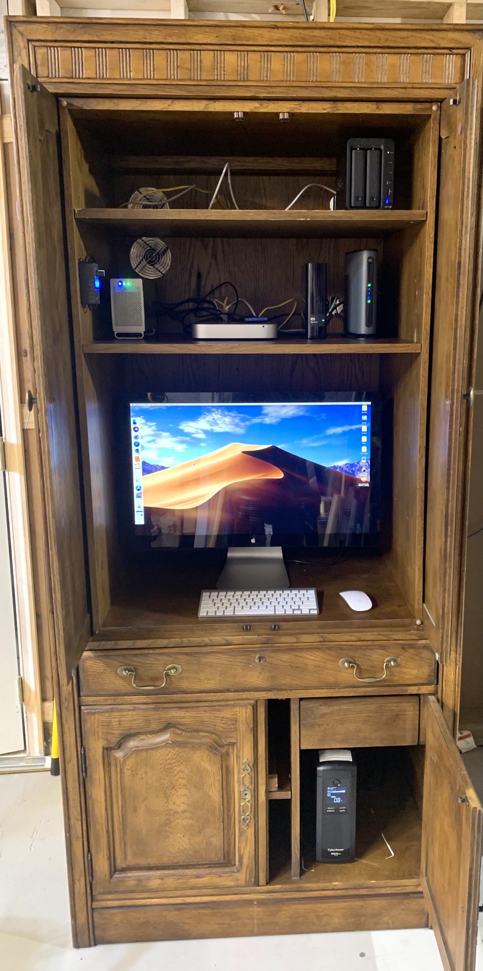

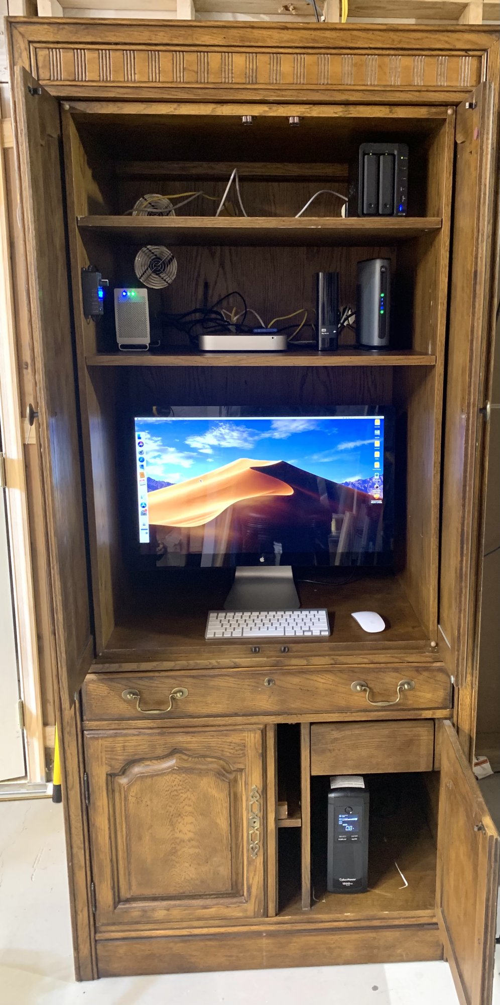

Just finished my new data closet in my basement. Bought an old entertainment cabinet from our local Habitat for Humanity ReStore. I didn't have to make any significant modifications for it, just some new holes in the back for cables and the two fans I installed. Rheostat for fans is on left side. At half speed I can barely hear them.
