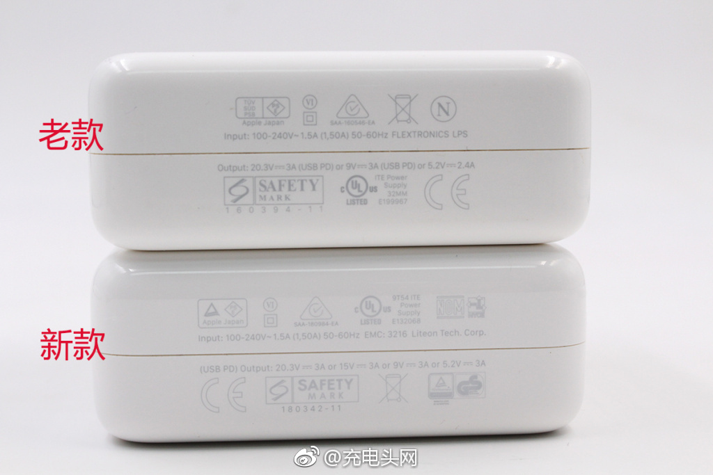

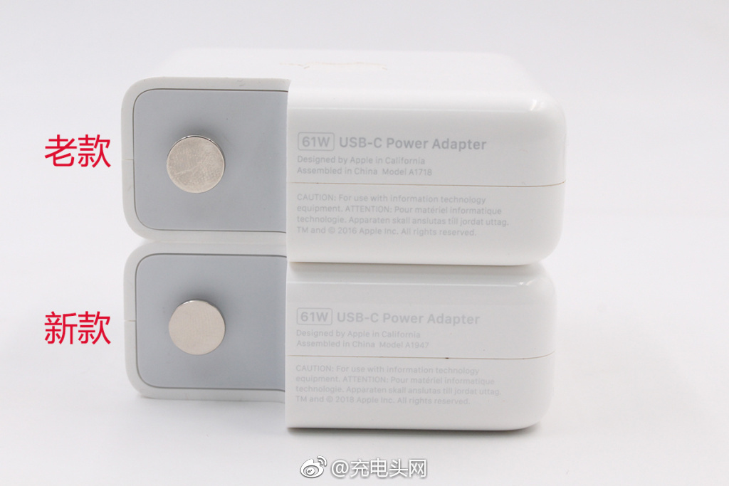

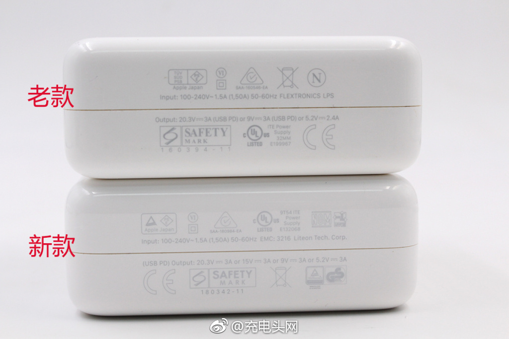

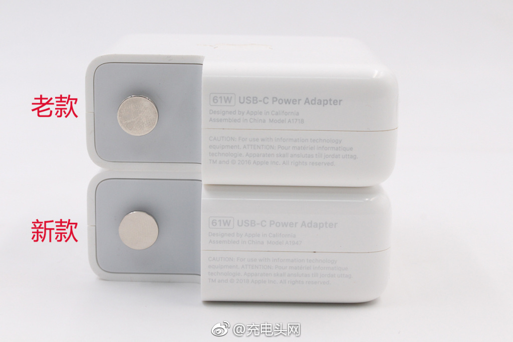

There are two different Apple 61W Power Adapters:
- Apple 61W USB-C Power Adapter A1947 (13” MacBook Pro 2018), 60,3W (20,3V/3A PD), 45W (15V/3A PD), 27W (9V/3A PD), 15,6W (5,2V/3A)
- Apple 61W USB-C Power Adapter A1718 60,3W (20,3V/3A PD), 27W (9V/3A PD), 12,48W (5,2V/2,4A)
While the A1947 will support charging at max. speed (theoretical up to 15V/3A), the A1718 won’t do. But it seems the A1718 could at least deliver 27W (9V/3A) to the new iPad Pro.

The 30W and 61W (updated version) have the 15V profile which will charge the iPad Pro faster than the 87W adapter.
As far as I know, the 87W doesn't have a 15V profile. You can check the printed text on the adapter.
Is MNF72LL/A Model A1718 an updated version of 61W? Just got from Bestbuy thinking it would have the 15V profile but it also has 9V profile just like 87W. Specs are written on charger & not on the box that’s I couldn’t check that in store.
Reactions: A.R.E.A.M.
No, the updated (2018) version of the 61W adapter is A1947.
