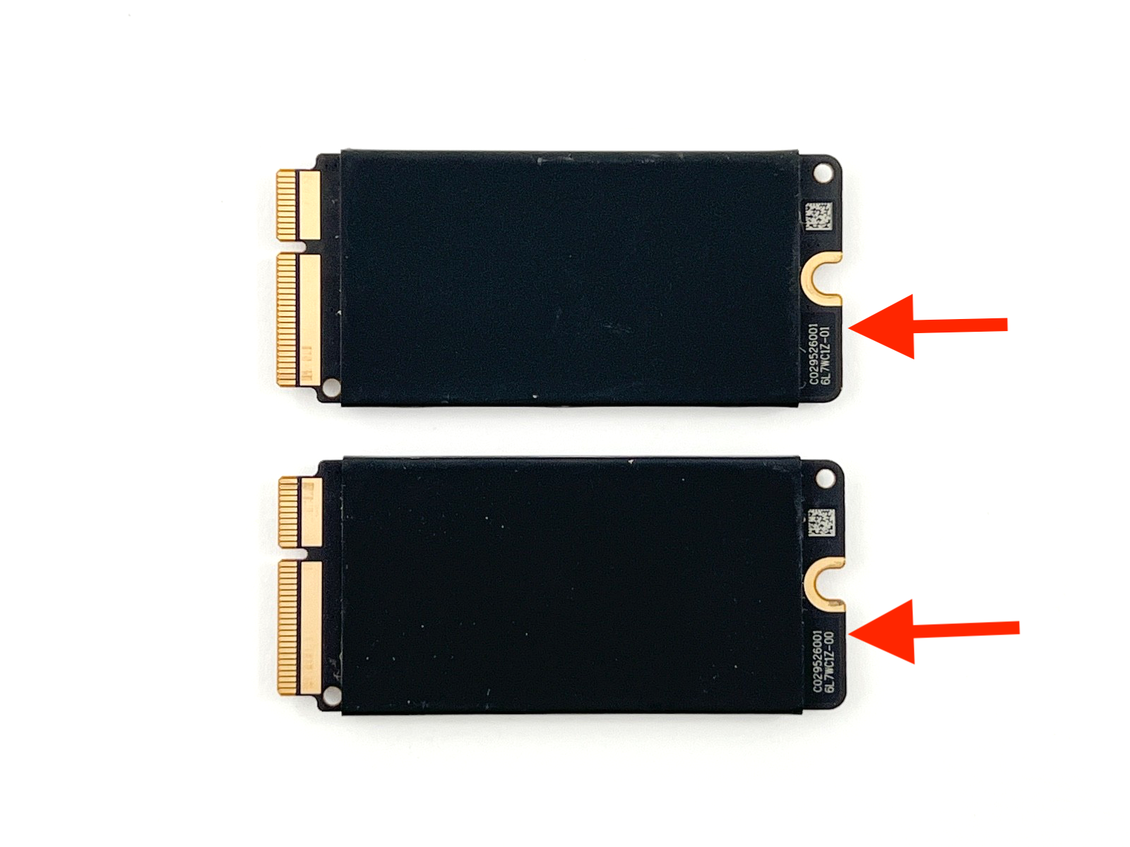

I bought a used Apple SSD upgrade kit (system pull), I'm starting the upgrade and I noticed that the two SSD's aren't numbered with 1 & 2. Apple is very specific about installing device #1 is slot 1 and device #2 in slot 2. How do I determine which is which? Can I just install them and Apple configurator will tell me if they are reversed? Should I be concerned about installing the wrong one in the wrong slot?
Look at the part number near the screw/lock hole:
  • suffix -00 is the 1
  • suffix -01 is the 2
If you should installed them in the wrong order, the Apple Configurator will abort and give an error.
Swapping them will let Apple Configurator complete the process successfully.

<Sigh> so if they are both -00's I have two slot 1 SSD's and I'm f*&%$D
This is not Apple, the seller messed up or worse, tried to deceive the buyer.
