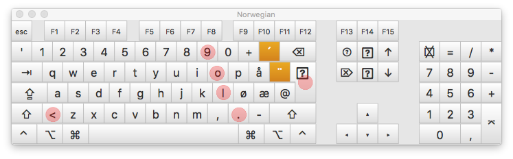

For some reason my Apple Extended (wired) keyboard (A1243) started acting up, meaning certain keys no longer work.
I tried rebooting into safe-mode, logging into another user etc. Finally I attached the keyboard to another Mac where it shows the same problems.
I've also tried using a standard PC keyboard with my Mac, and the problems aren't there, so I can safely conclude it's a hardware issue with my Apple keyboard. Here are the affected keys (marked with a red dot):
My first guess is that a shared PCB trace of the membrane inside has broken, given that there appears to be a pattern to which keys don't work (though the < and RETURN keys do away with that theory, possibly). Can someone with more insight confirm this?
Or is it more likely to be a logical error inside the keyboard (malfunctioning ICs)?
A broken membrane track can be fixed (I've done it before), so I'd like to hear what people think or have experiences with before I try to open it up (no screws as usual).

There's virtually no way to get it open without damaging it, FYI.
I'm not surprised unfortunately. Typically the way things are made these days. How much more would it cost Apple (i.e. the customer) to install a few screws underneath instead of glueing it together?
Anyway, I did come across the iFixIt Apple A1243 keyboard teardown which shows how to disassemble it and the iFixIt "I've got a few dead keys on this keyboard -any way to fix it" thread which also linked to a French disassembly page, so I'm going to give that a go. After all I have nothing to lose.
