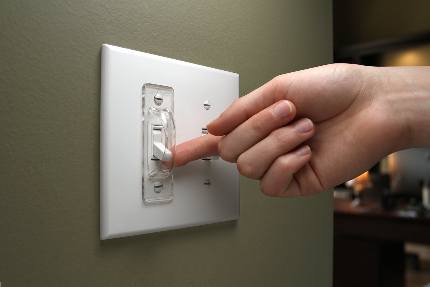

I also wouldn't recommend removing the existing switch and hardwiring it to stay always on. There are probably electrical/fire codes against this. Not to mention you can't ever turn them off for whatever reasons (changing bulbs, bridge dies, reset lights, etc). I would just mount a Hue dimmer or tap next to the switch and either label the existing switch with "do not turn off" or just inform people not to.
There are switch guards that discourage people from flipping the switch but still allow you to flip it when you really need to.
