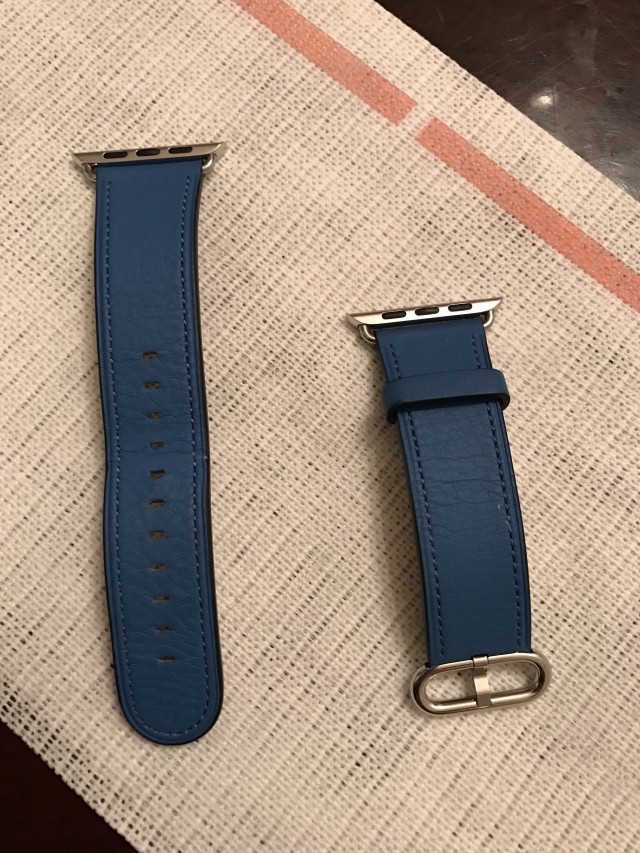

Hey MacRumors I hope the write up is helpful for those looking to do the same sort of thing. I didn't find any instructions online so I figured I would put together information I gathered from various sources together. I'll try to be clear and thorough but if anything doesn't make sense feel free to ask or message me. I definitely made some mistakes along the way but my mistakes are easy to avoid.

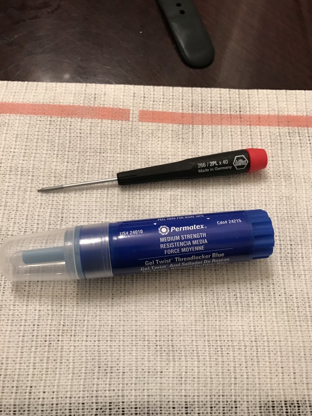

Tools:
Pictures Before Disassembly:
Steps:

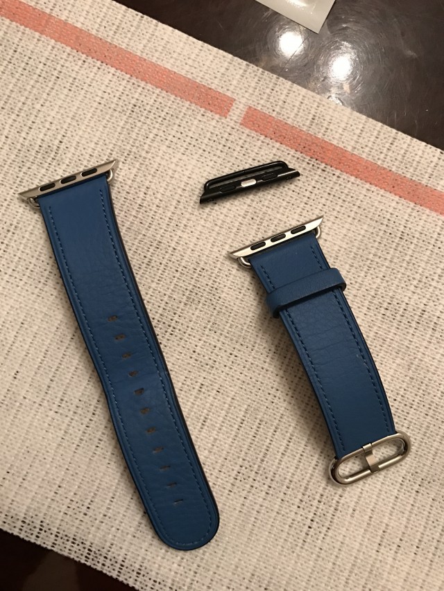

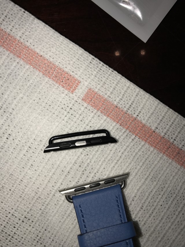

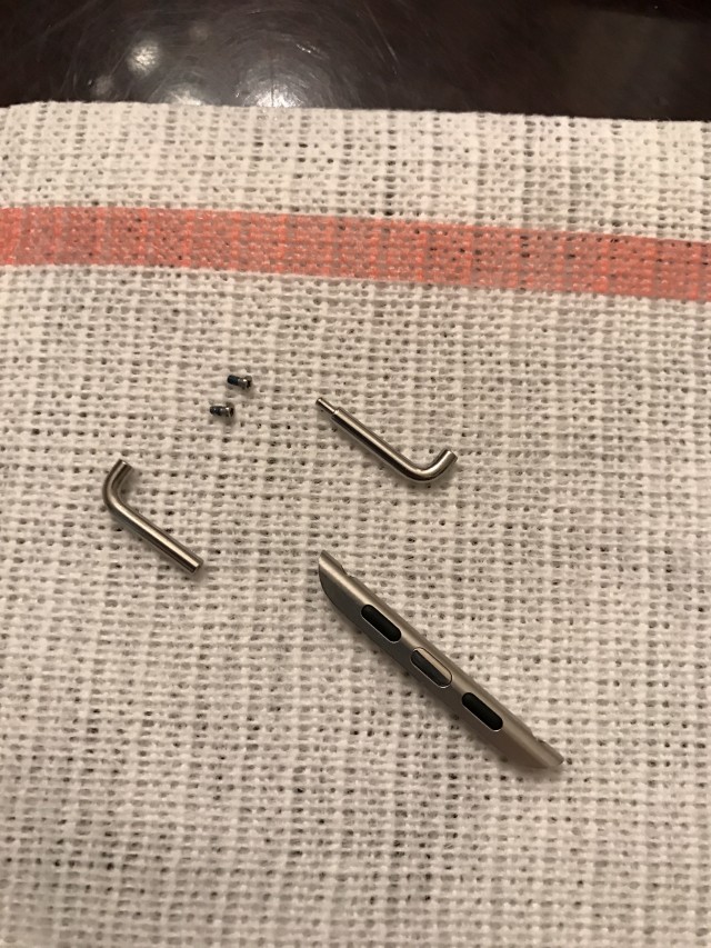

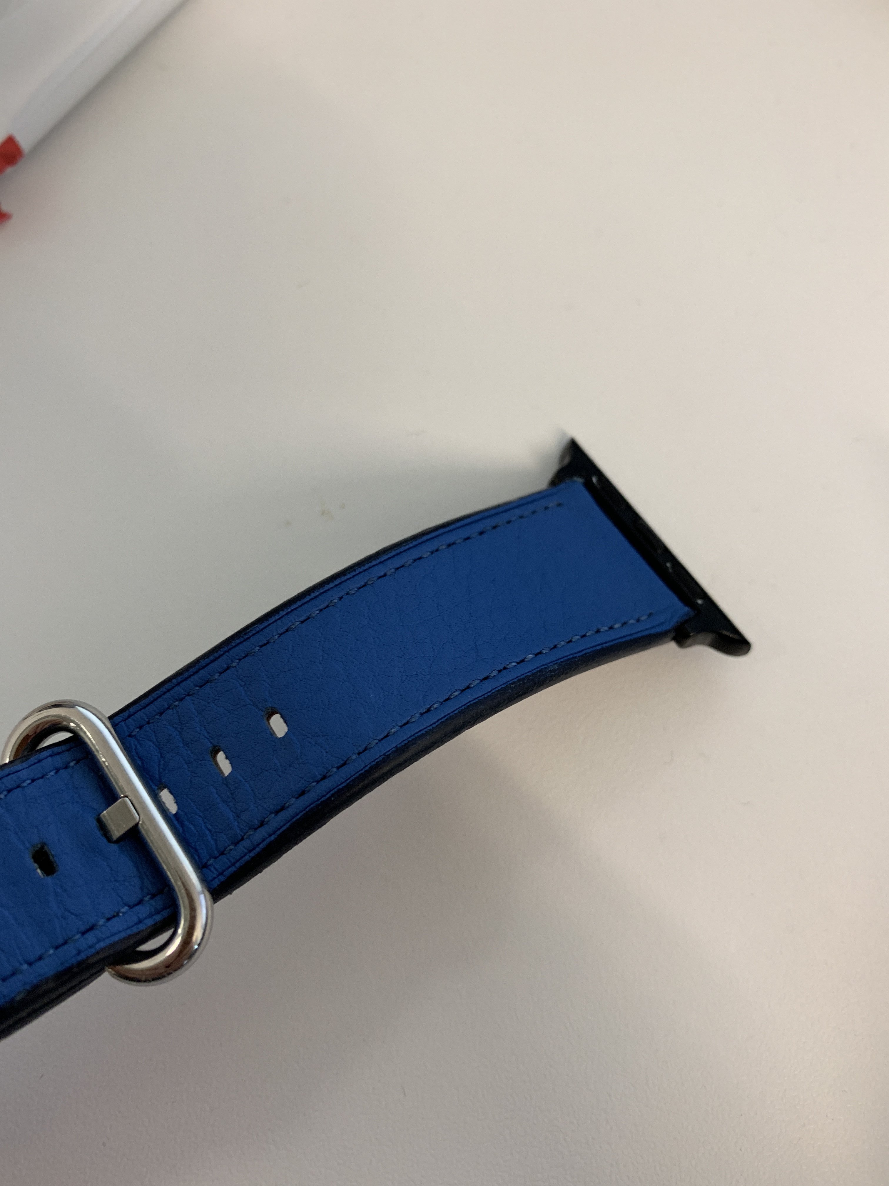

1) Use the Wiha 26762 Screwdriver to remove the Stainless Steel adapter from the Apple Classic Buckle. I would recommend, press and screw, lift the screwdriver, and go to the press and screw method. This IMO ensures that you don't thread the OEM screw in case you want to go back.

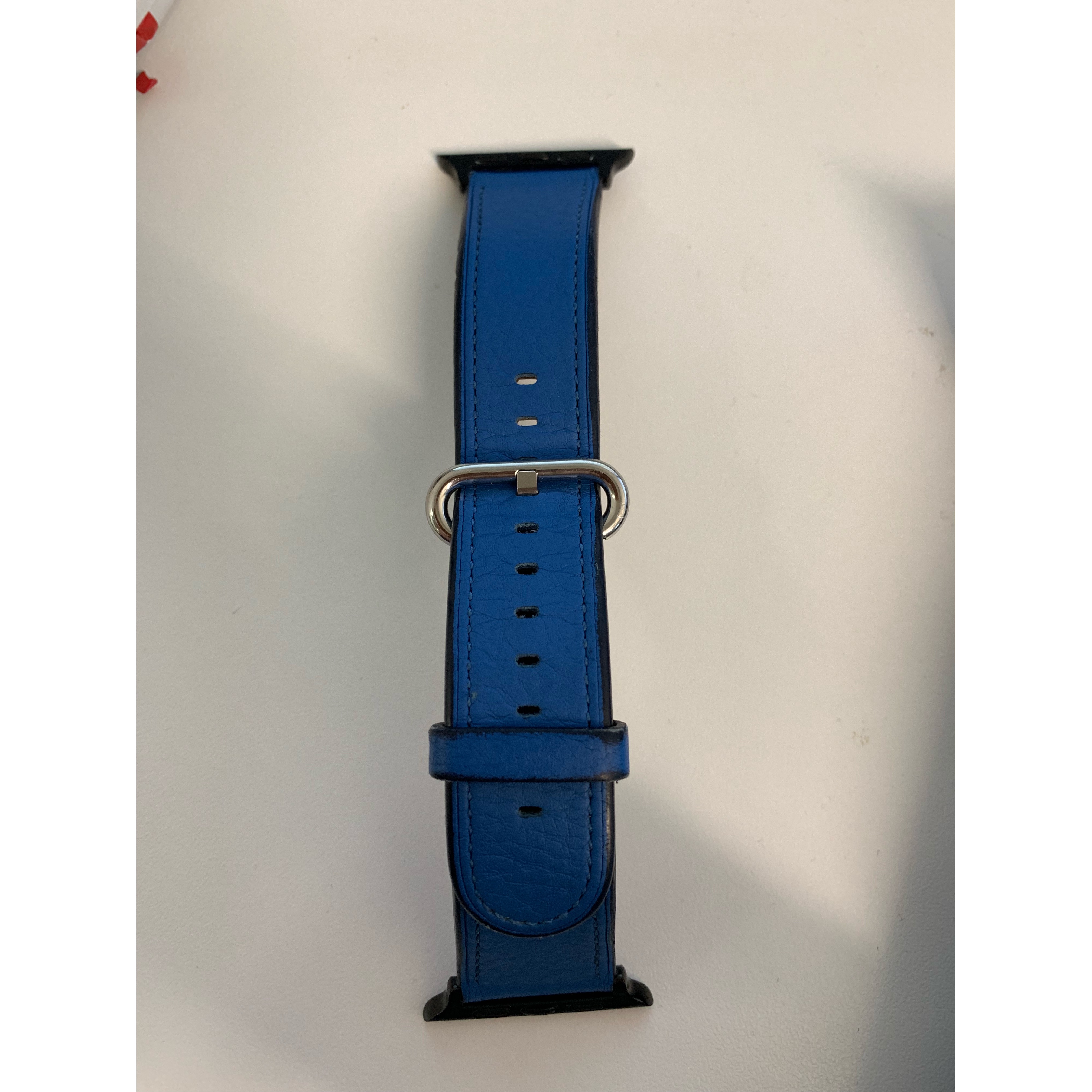

2) Insert the MIFA adapter as shown in the pictures below, have the facing leather portion of your band be how you assemble the parts:

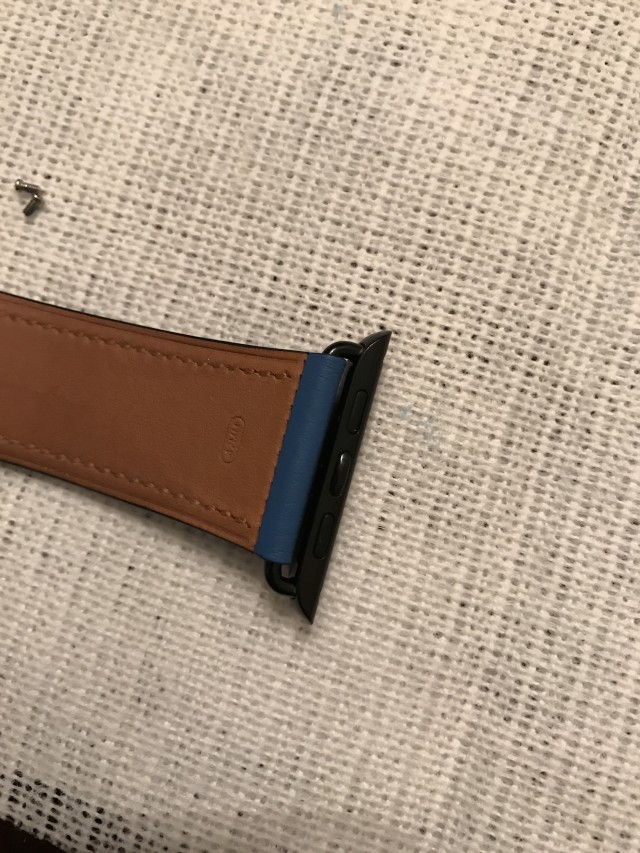

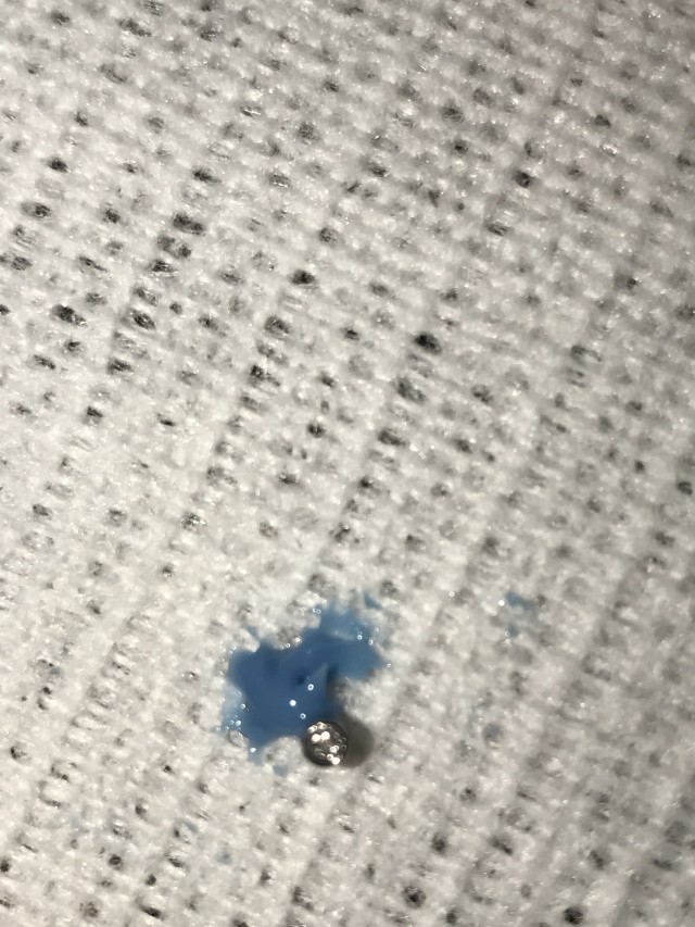

3) Cover the screws one by one with the Gel Glue (this is honestly the hardest part, read the mistakes section below)
4) Assemble the strap with the provided screwdriver. I would recommend the press and screw method as the screw driver included is pretty easy to break.
5) Clean excess glue with a dry paper towel.
6) Let the glue dry overnight before use with the Apple watch. This is just me being be cautious.

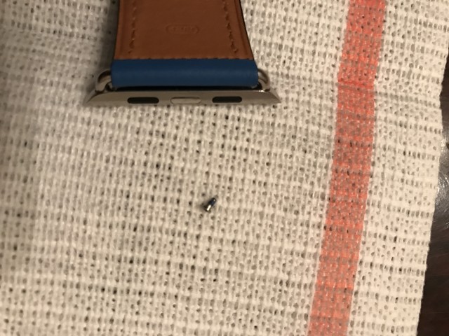

Mistakes and Lessons:

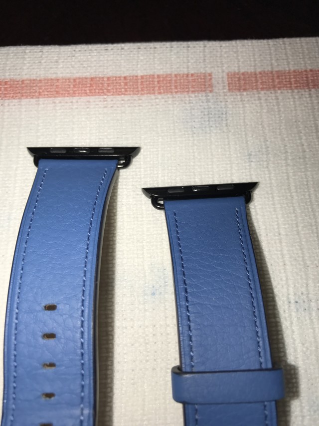

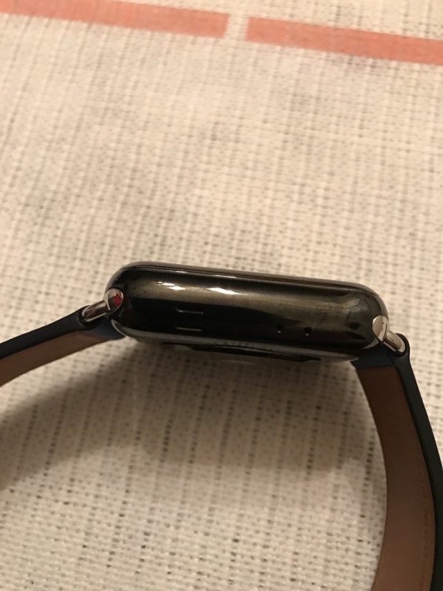

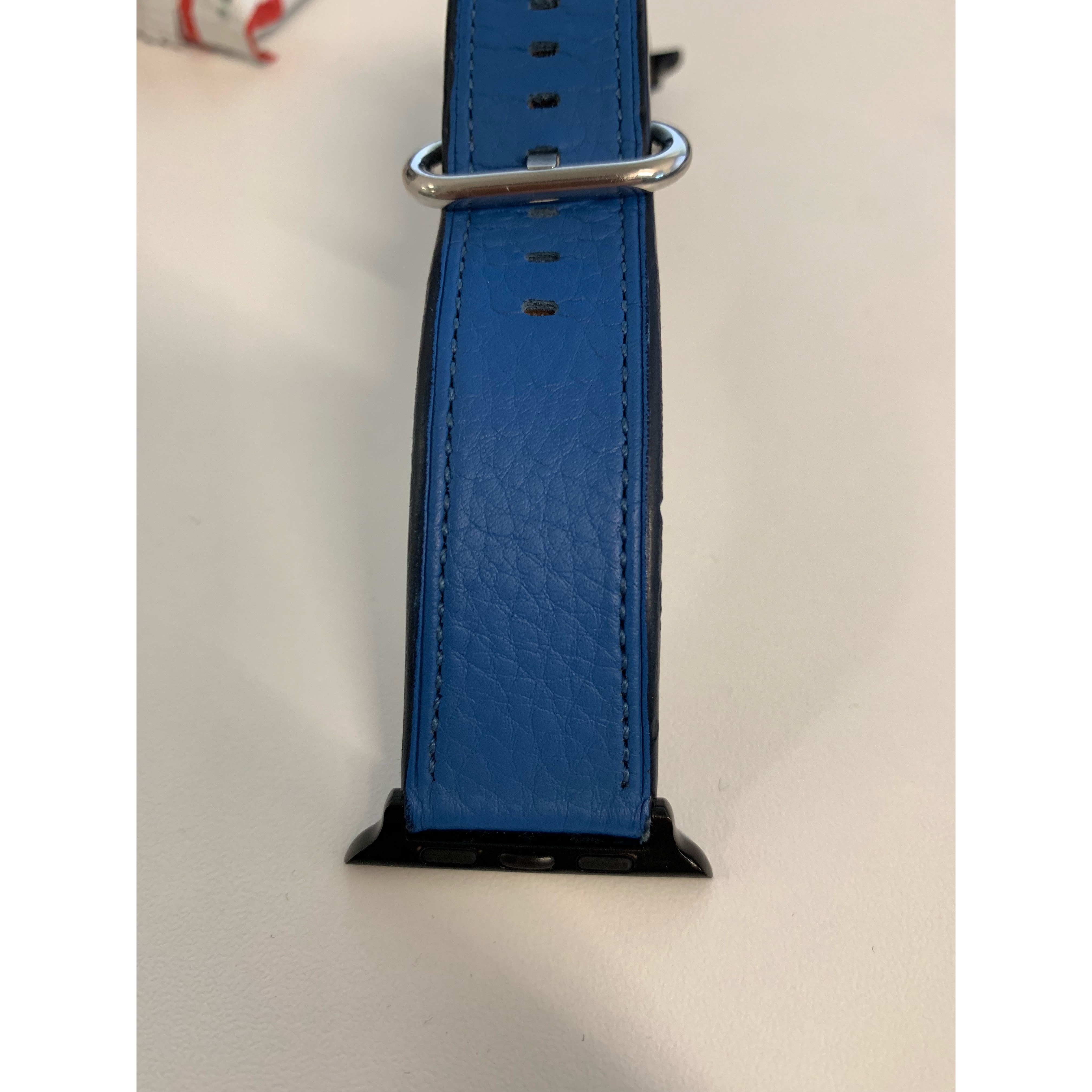

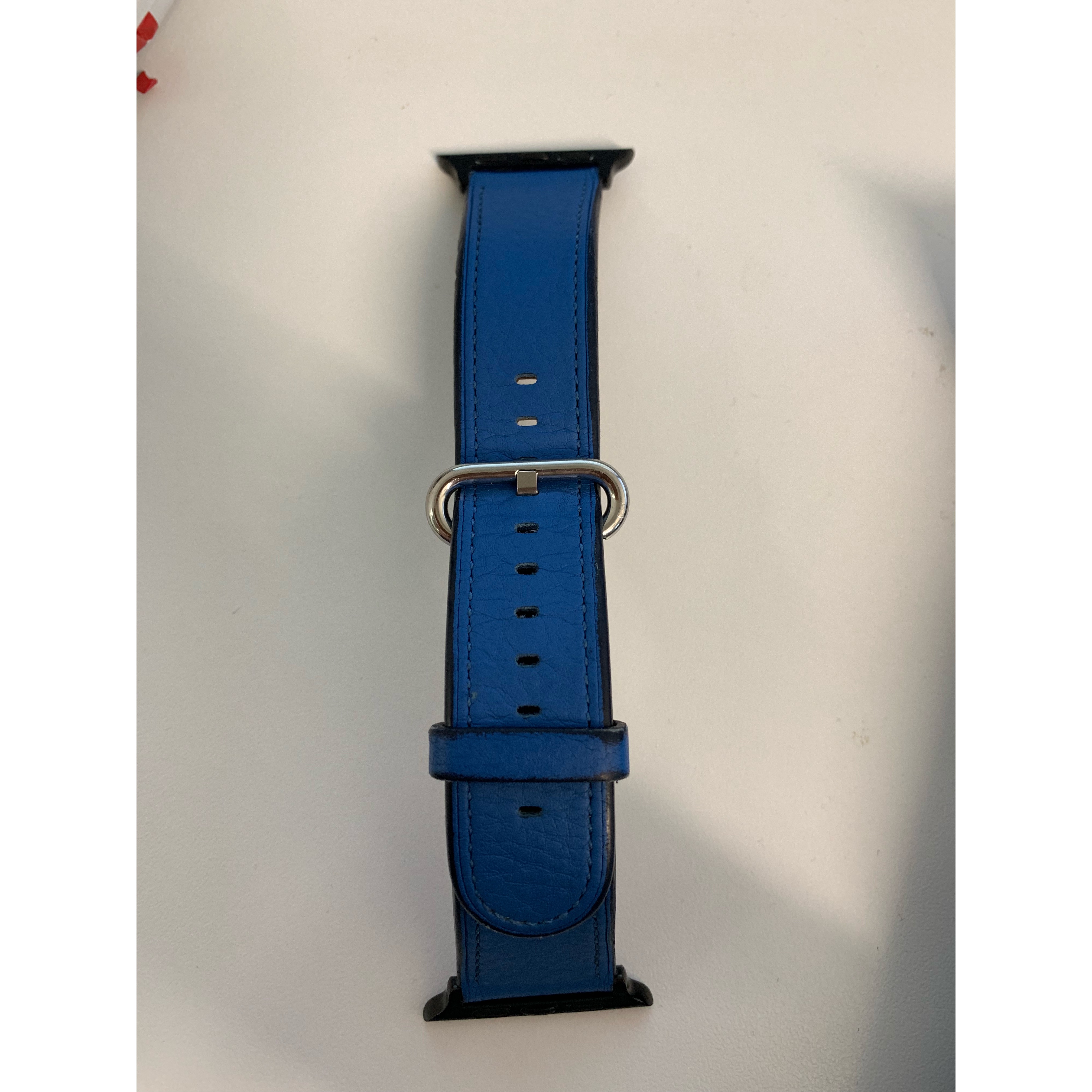

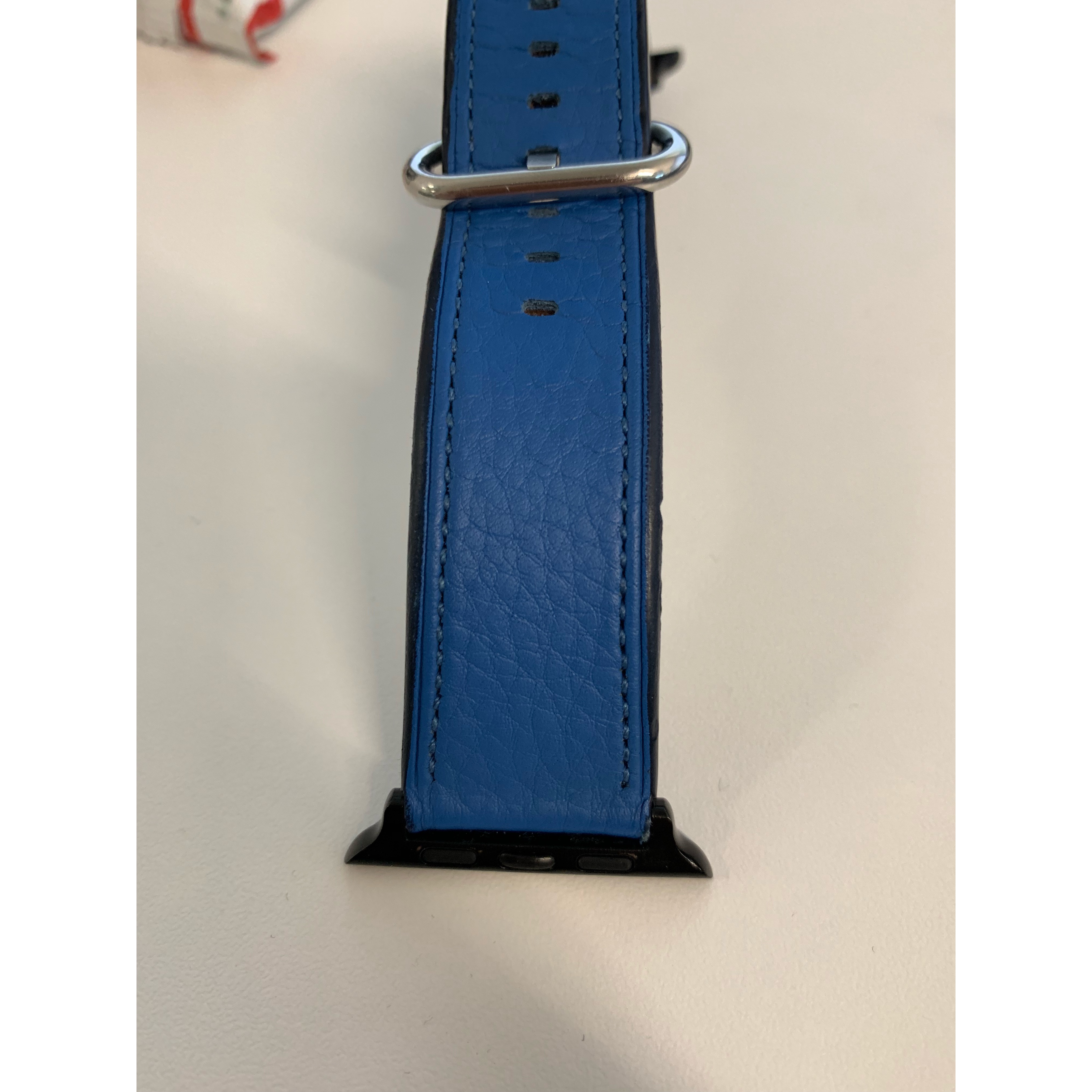

Assemble the MIFA adapter as shown in the pictures, this will ensure:
  1. No silver color is exposed

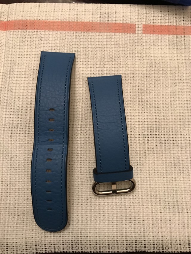

  2. The band isn't installed backwards as shown below. All rubber parts on the band must be facing in the direction of the leather band:
  3. The gel glue was the worst part, I would dip the screw holes in the adapters with a tooth pick or a cotton swap by removing the excess cotton and then inserting the screw.

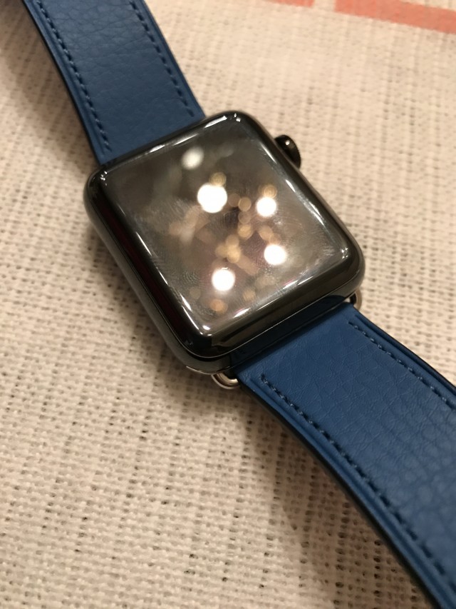

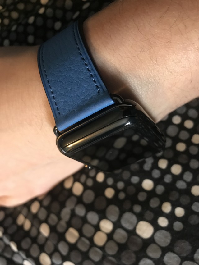

Final Product:

It looks nicer, however I don't think the band matches the watch
The Black Classic buckle would have made much better
Black and blue go together great in my opinion. I would be bored out of my skull just wearing all black all the time, no offense. Colors make the Watch more exciting.

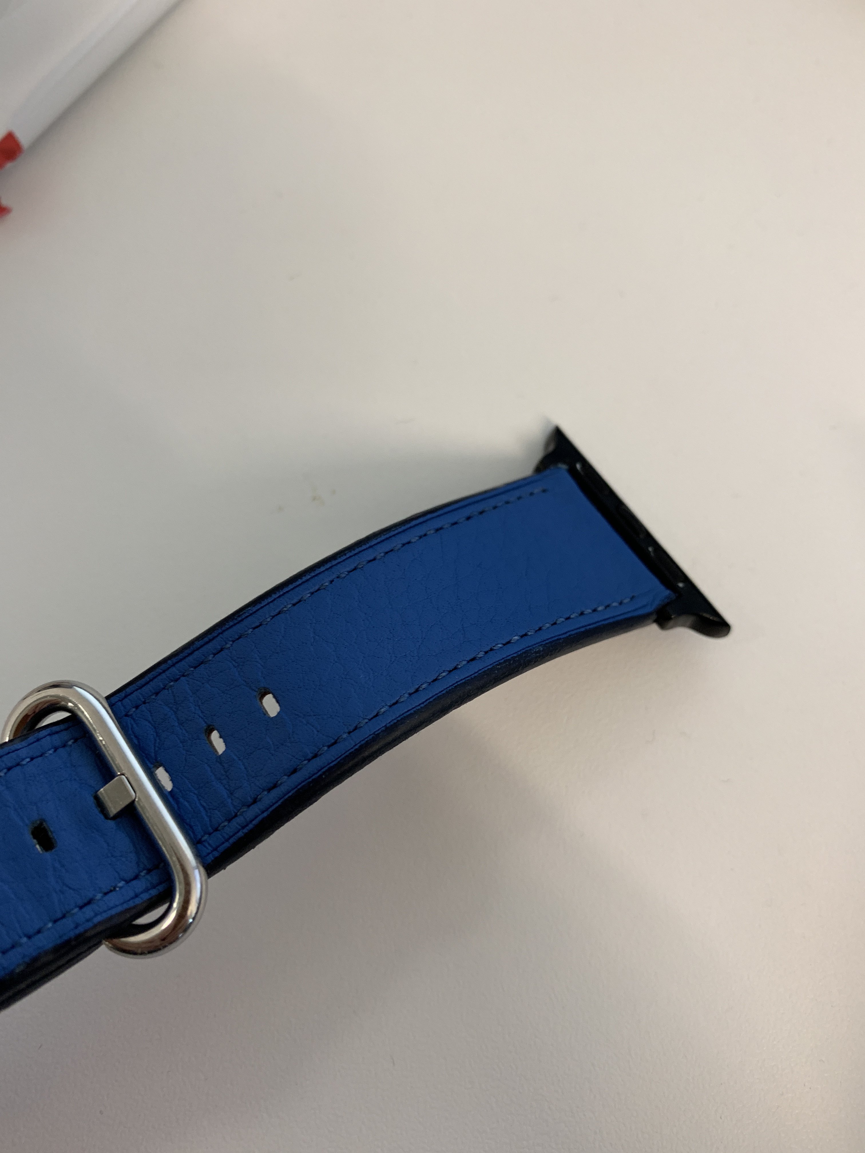

For those who are wondering about an update. I removed the Space Black 3rd parry adapter and put the apple strap in a Clockwork Synergy adapter that can fit up to 22mm. The apple band is 23mm so it does get squeezed in there. This is a spring loaded adapter, so no fuss with glue or anything.

Unless they changed the adapter recently, that Clockwork Synergy adapter won’t fit the new series 4 models. I have a band from them with that same style adapter and had to remove the strap and use a different adapter for it to fit my SBSS 44mm Series 4.
