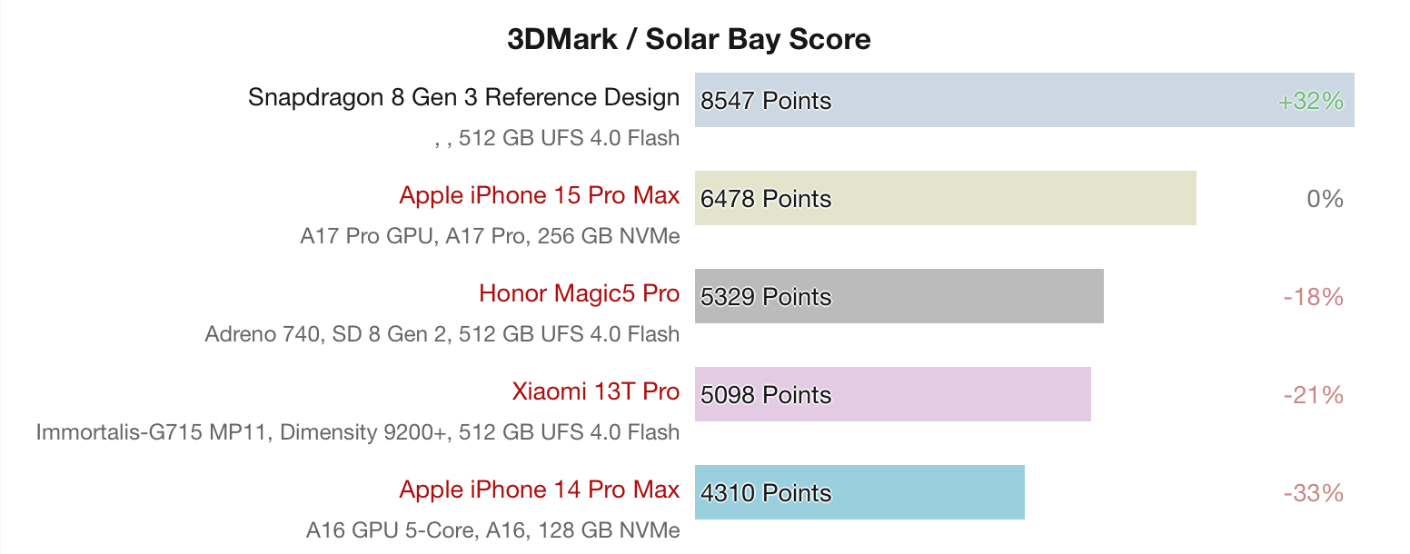

I’m curious if anyone is aware of any ray tracing performance benchmarks or scores for the A17 Pro. Hopefully if the M3 arrives soon with ray tracing then it might give us an insight into expected performance.
So far all I”ve seen is 3DMark’s Solar Bay benchmark. The scores are a little strange though:
We can see the new Snapdragon 8 gen 3 gets really good performance, but I’m a little disappointed in the A17 Pro. It seems to get only 50% more than the A16. I thought I remembered Apple saying up to a 4x improvement. I don’t expect 4x on every test or application but this seems low.
Is Solar Bay actually using ray tracing on the iPhone? Are any special measures needed to use the RT ability on the A17 Pro? I haven’t seen any apis for this.
Chart taken from here:
The first phones with that SoC doesn't get near that score though 😅
The Xiaomi 14 gets 7688 in 3DMark Solar Bay (which is still mighty impressive) and faster than the A17 Pro SoC that reaches 6731.
Reactions: APCX

For sure. I’m mainly wondering why the A17 doesn’t improve much on the A16. There seems to be very little discussion of the new RT ability.
Ahh very interesting. Many thanks.
UL is pretty good about explaining how the test are set up and how the scoring works.
Reactions: APCX

It's even more perplexing than that chart illustrates-- the A17 Pro has 5 GPU cores vs the A16's 4 GPU cores. If it had 6 cores, that's 6/4 = +50% right there; 5 cores indicates that the score improvement per core is only really ~25%.
To me, that indicates that something isn't quite right about the Solar Bay benchmark, e.g. it's doing a lot of other stuff than ray tracing or the pipeline isn't properly optimized.
Looking into it a bit more, the Solar Bay docs state, "The Solar Bay graphics test features ray-traced reflections, volumetric lighting, particles, and post-processing effects. The scene consists of three sections, with the ray tracing workload increasing in each section. The second and third sections target an average of 2x and 3x the ray tracing workload of the first section."
When I ran Solar Bay on my 15 Pro Max (for an overall score 6532), the FPS for each test section in order were 30.1, 26.9, and 19.8. So, for 3x the ray tracing workload, I'm seeing 2/3 perf as opposed to 1/3 perf. Alternatively, one might expect 19.8 FPS at 3x to equate to 19.8*3 = 59.4 FPS at 1x rather than 30.1 FPS, i.e. I'm only seeing ~50% of the expected FPS at lower ray tracing workloads.
I think part of my disappointment stems from UL declaring Solar Bay a "ray tracing benchmark for lightweight and mobile devices" which sounds like a synthetic benchmark specifically for measuring theoretical ray tracing performance. Conversely, I would never assume 4x ray tracing perf in a real-world game test... which is what Solar Bay appears to be.
Reactions: APCX and Rnd-chars
It's not that it's badly optimised, it is simply very much dominated by traditional triangle rasterisation. RT is only used for few effects, and as you wrote yourself, it's developed for mobile devices and low-end PCs. Ideally we'd need a more RT-heavy test that for example path traces the entire scene.

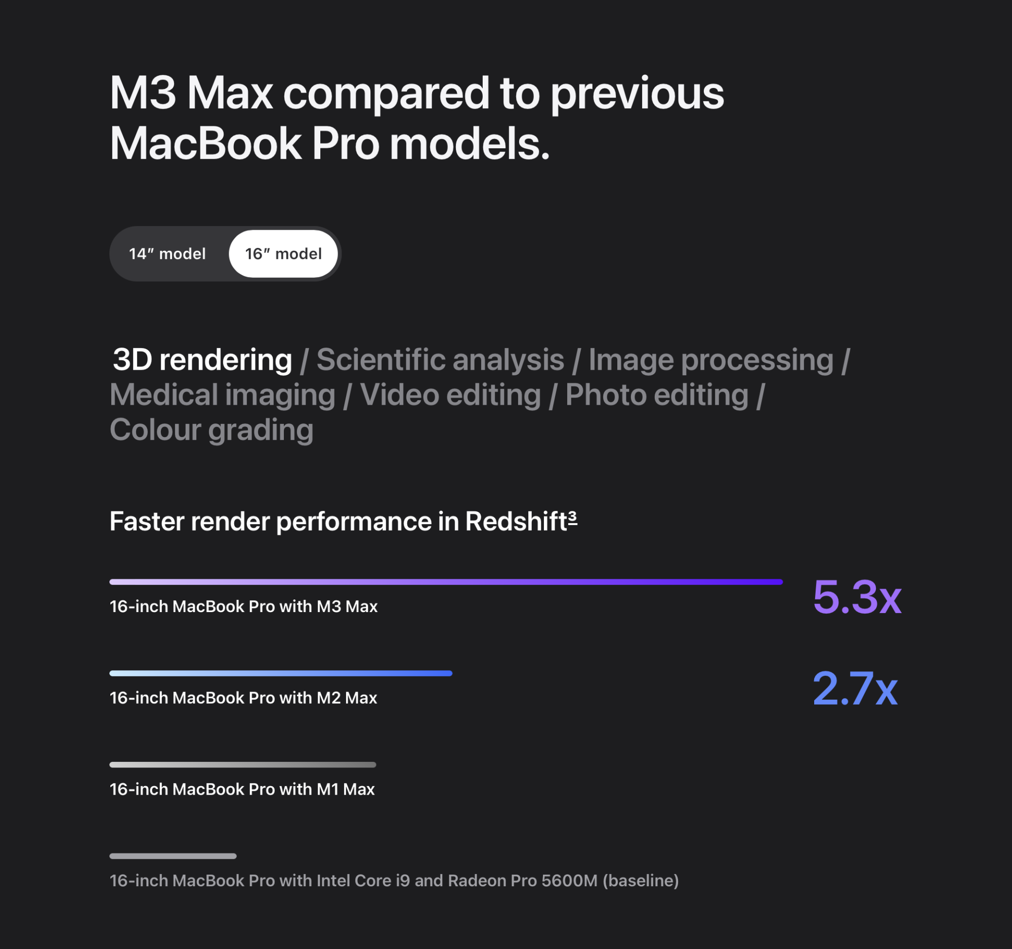

Got to love the apple graphs on the product page:
M3 Max is 49x faster in Redshift (than a 13-inch MacBook Pro with Intel Core i7)
Pretty curious to see how things pan out in Blender / Redshift though. Wonder if the new architecture (other than raytracing) will help much.
Landing around a 4070 is pretty decent improvement, particularly going from CUDA levels of performance to OPTIX ones, and it has the added advantage of a lot more memory and not being throttled when away from a power source. For when you have to render frames from Starbucks or sth :p

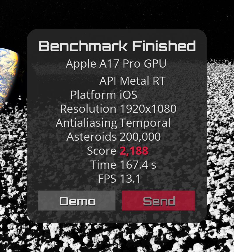

The new GravityMark 1.85 for iOS is in review. It includes Ray Tracing and Mesh Shading support.
update: App Store and Google Play versions with Ray Tracing support are live.

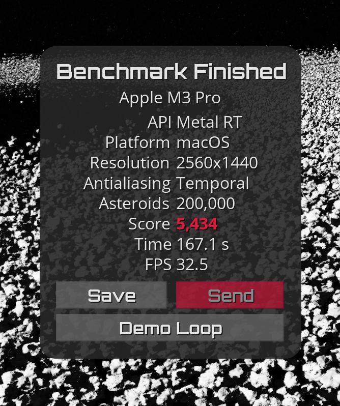

M3 Pro RT test:
And, unfortunately, it's behind AMD Radeon 6500 XT:
iPhone 15 Pro Max cannot run RT benchmark in 2K/200K mode (not enough memory):

M3 Pro RT test:
I'm not sure there is much point in comparing different APIs like that.
The RX 6600 only gets 3,358 under Metal RT on macOS.
The M3 Pro is also 16% faster than the M2 Max.
Do we have positive confirmation that MetalRT actually uses Navi2 RT hardware?
