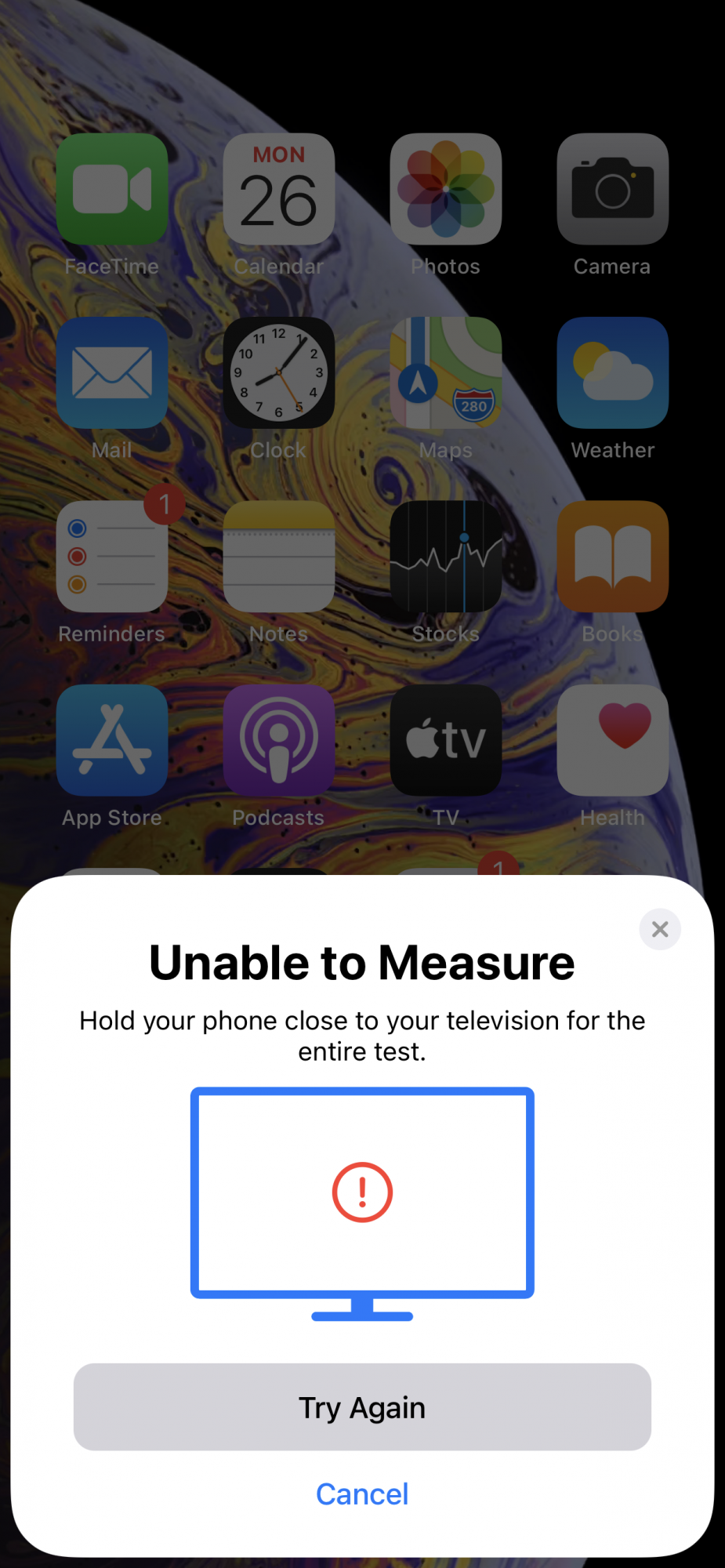

Two Apple TV 4K’s and two Vizio 4K sets. 1 calibrated on the first try. The other has failed every time, on the 20th try. I’ve tried it all, even laying it flat on the TV. It still said “hold your phone close”. Can’t get any closer without breaking the TV.

I have successfully run this process on 5 televisions - three Samsung models (40", 65" and 75"), an older Sony and a Toshiba Regza... four worked perfectly the first time. I had a bit of trouble with the 75" Samsung... but after reading this thread, I placed the phone directly against the tv screen... and it worked perfectly then. The differences were minimal/insignificant on all of the televisions... much ado about nothing, IMO.

Figured out what my “problem” was. The test will not finish if my second TV is in Standard picture mode. Has to be in a different mode. The other TV was in Standard and it worked just fine. They’re both Vizios, one from 2017 and the other 2018.

Just in case anyone else has a 2017 Vizio E Series, here were my results by picture mode:
Standard - Fail, “Unable to Measure”
Calibrated - Pass
Calibrated Dark - Pass
Vivid - Fail, “Unable to Measure”
Game - Pass
Computer - Pass
The “Computer” picture mode is basically Standard with a higher brightness level.
Good luck everyone. Obviously, YMMV.
