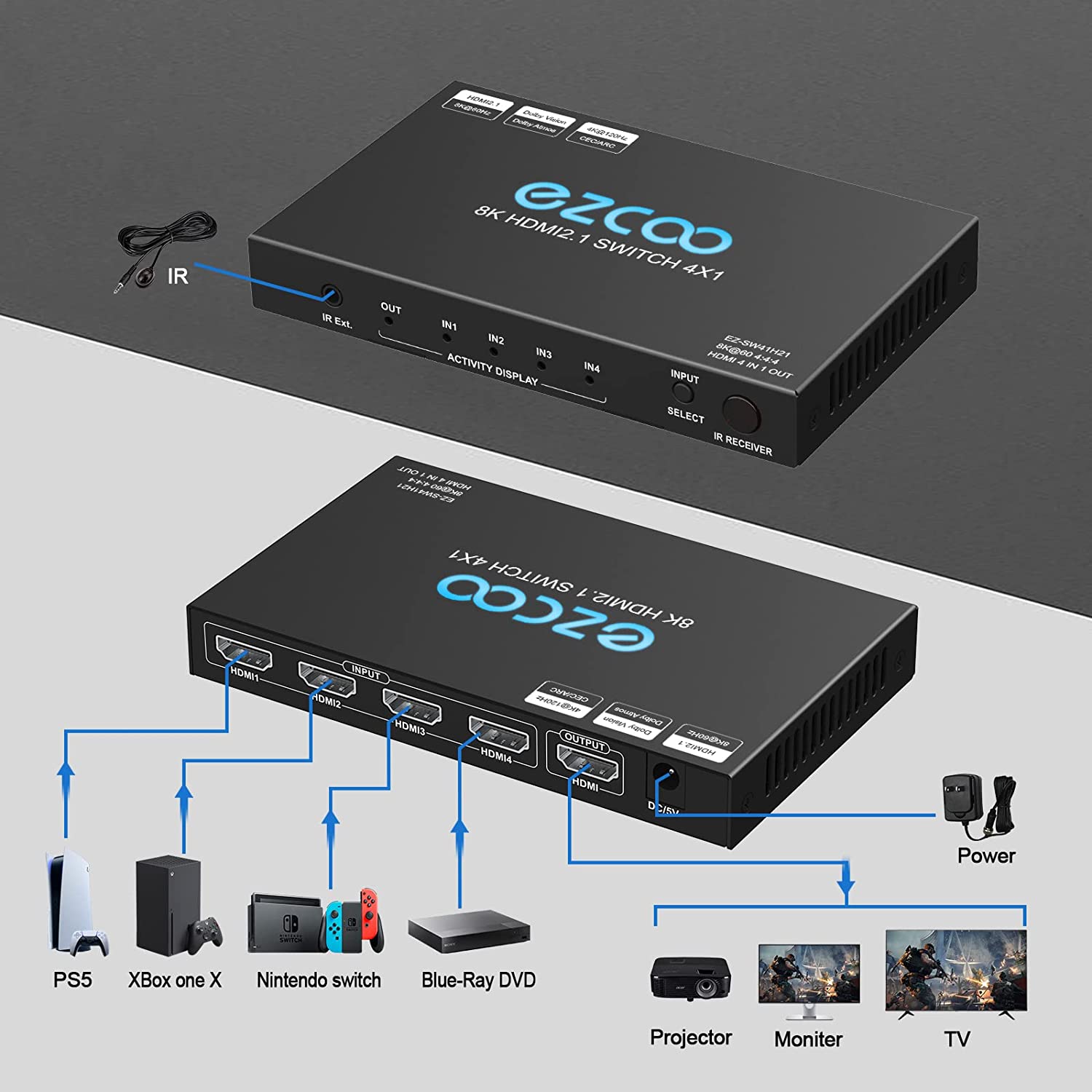

This might do the HDMI switching (only) trick for your various devices for < $100 and has some future-proofing specs to make it useful for up to many years.
https://www.amazon.com/dp/B09XV6X4J3?ref_=cm_sw_r_ud_dp_E6Z94PEACSMDDR111ZNN
There are several others with modestly lower tech specs and/or fewer HDMI ports for less, some south of $50.
With this, it could be:
  • various devices (AppleTV, PS4, WDTV) HDMI cables into up to all 4 HDMI INPUTS
  • ONE HDMI cable out of this (HDMI OUTPUT) and into one HDMI TV jack
  • ONE HDMI cable out of HDMI ARC jack on TV to Soundbar
OR, you could put the soundbar in the middle (3+ devices into this, this into soundbar, soundbar out to TV) but AppleTV may still not work well with soundbar “pass through.” My best guess is that soundbar will need to be LAST link in the connection chain (not using its “pass through” option) unless you experiment with AppleTV settings to maybe find something that is causing the flaky video when using soundbar pass through.
There is also a 4 HDMI IN with TWO (2) HDMI OUT version for about $50 more: https://a.co/d/3AJrRhy You might think about this as splitting video and audio with the 2 HDMI OUT jacks, sending ONLY video to a TV HDMI IN jack and sending ONLY audio to the soundbar through the OTHER HDMI output. I suspect the first box will work but if your TV won't pass though the ATMOS audio, this option should just about guarantee it gets to the soundbar (without having to then lean on the soundbar "pass through" technology for the video).
