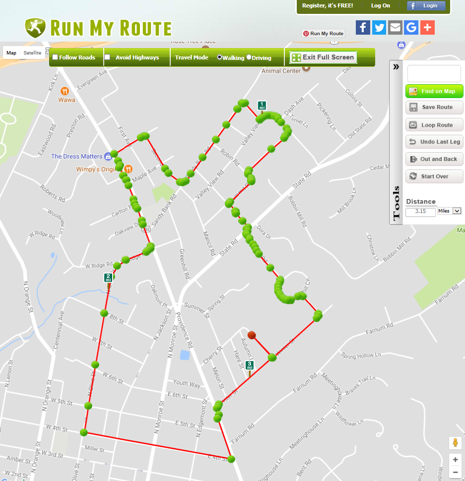

Typical Route (between 3.05 and 3.15 miles, depending on the mapping website)
I mapped out my route using RunMyRoute.com and also Google Maps walking directions. They're both around 5k (3.11 miles).

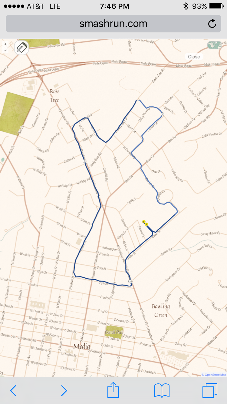

1st Run - NRC+ on both the AW and iPhone - run started on the AW
The above map was taken from my SmashRun account. NRC+ recorded this run as 3.53 miles. As you can see, the map route is exactly the same as the reference map above.

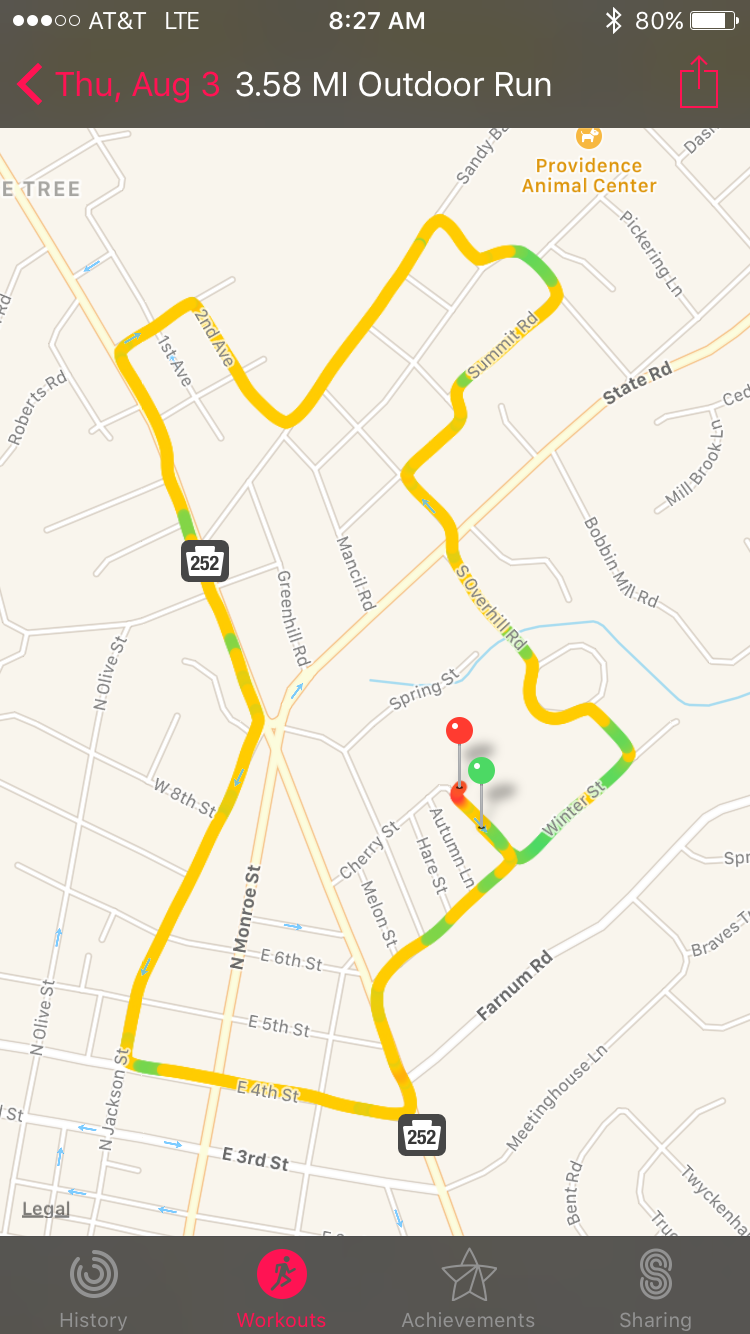

2nd Run - AW Workout (carrying iPhone) - run started on AW
This map was taken from the Workouts app on the iPhone. The run was recorded as 3.58 miles. You can also see that the map route matches the reference map.

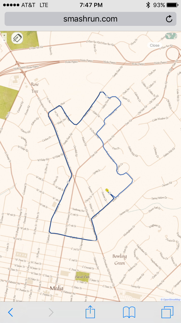

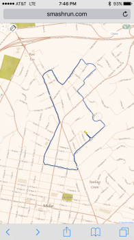

3rd Run - NRC+ on both the AW and iPhone - run started on iPhone
This map also comes via SmashRun and was recorded properly as 3.1 miles. You can see that it matches the reference map.
