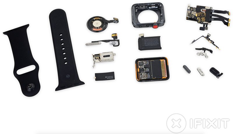

iFixit has completed a teardown of the Apple Watch Series 3, which has a virtually identical form factor as previous models.

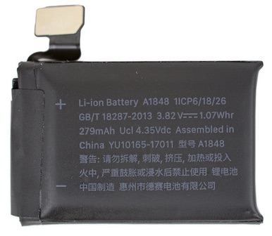

The battery in the 38mm model with GPS + Cellular has a capacity of 279 mAh at 3.82V, or 1.07 watt hours, which is only a slight increase of about 3.8 percent over the 38mm Series 2 model without cellular.

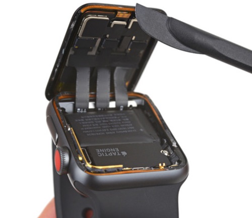

iFixit was surprised that Apple managed to increase the battery size while still leaving room for the added functionality of cellular antennas, radios, power amplifiers, the embedded SIM card, and so on in the same form factor.

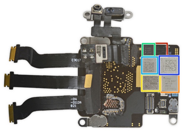

The embedded SIM, outlined in red, appears to be sourced from ST Microelectronics, and it is positioned next to a Wi-Fi module from Broadcom and other RF chips that enable cellular capabilities in the watch.

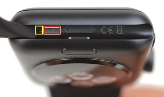

Last, we finally know what the tiny meshed hole is next to the diagnostic port: it's an air vent, since the Apple Watch Series 3's new barometric altimeter took over the vent's previous location next to the microphone.
Apple Watch Series 3's relocated air vent outlined in yellow
iFixit gave the Apple Watch Series 3 a repairability score of 6 out of a possible 10 points. Display repairs and battery replacements are both possible, albeit tricky, but replacing any of the component cables requires micro-soldering.

What kind of air flow could they possibly get through that vent when it is almost constantly occluded by a watch band?
I don’t think that’s its purpose. There’s no fan so there really isn’t any airflow at all. I’m not an electrical engineer but my guess that I think the main purpose of to just have an outlet to let the hot air out when there’re build up of pressure inside the watch housing as it’s not good to have a totally closed enclosure for any electronic device.

A 32% increase in battery capacity compared to the series "0" first generation Apple Watch. Awesome.
I can't say that I'm surprised by the larger battery, given the power consumption needs of the LTE radio, so give Apple props on trying to help things along in that department
You don't need air flow to measure barometric air pressure. Its around you all the time, pushing on you.
You just need a port that isn't air tight. Air is like water, in that it can get through small spaces.
