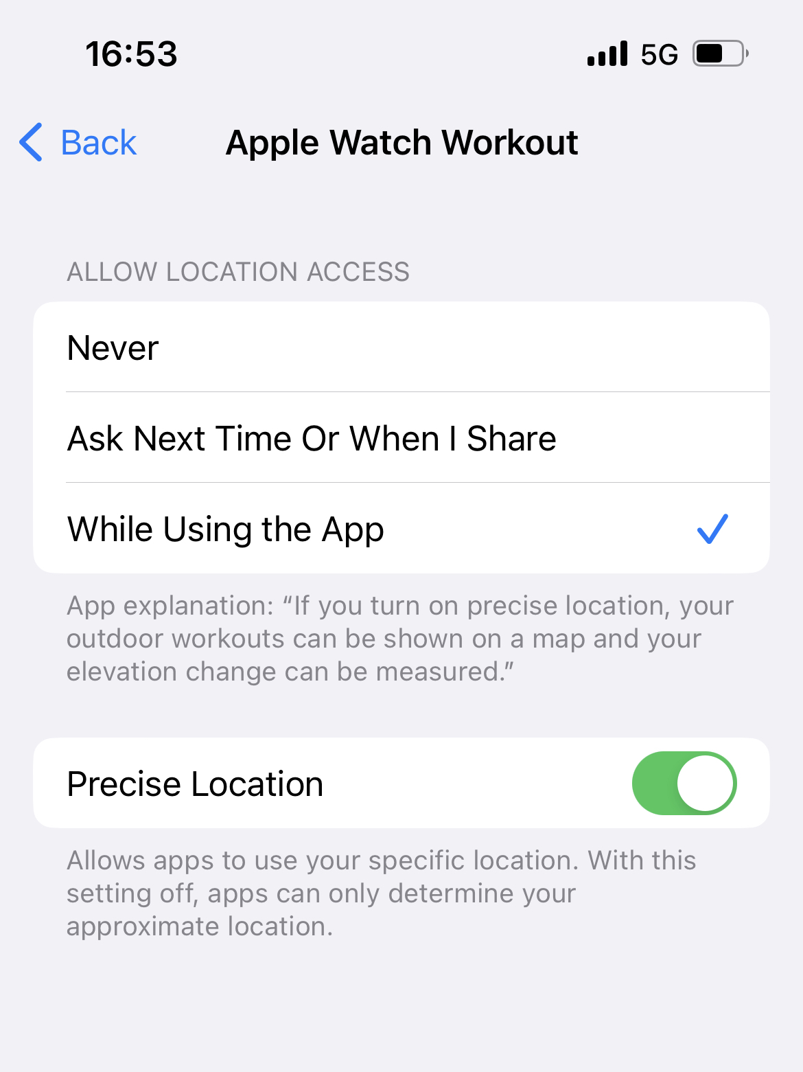

You need to get a good GPS fix and acquire a signal. Preferably somewhere outdoors with a clear view of the sky. Also check your location privacy settings.
