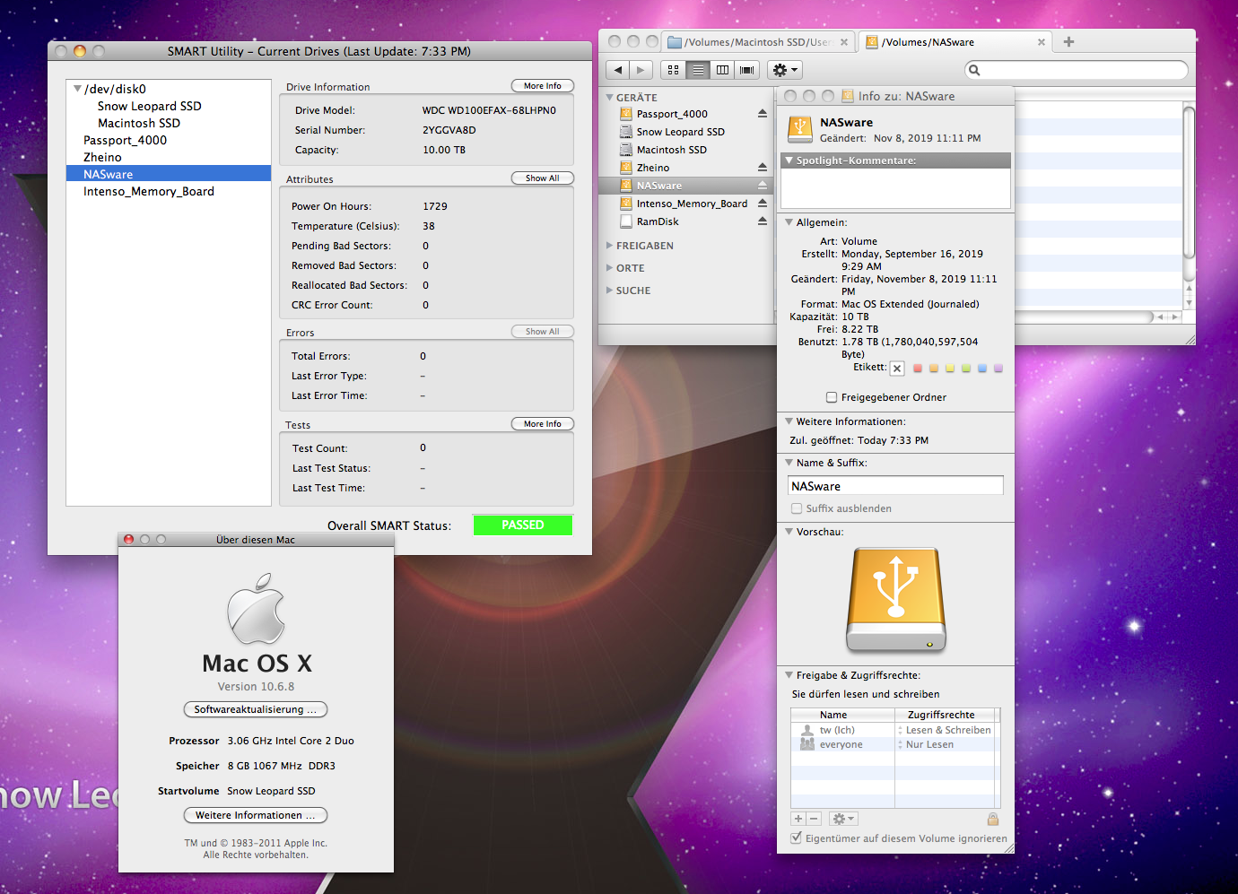

Actually it does work externally when using "SATSMARTDriver". Upon installation you can read SMART values with applications like DriveDx, Smart Utility and SMARTreporter. AFAIK the driver doesn't work with PowerPC but everything Intel starting from 10.6 should work (in fact I'm using it right now on my Snow Leopard installation)

Interesting, that’s good to know. Wouldn’t it depend on the enclosure/whatever SATA bridge controller was being used? Or will it work with all external drives (FireWire?)?
I always thought that the lack of SMART on externals was a limitation of whatever controller was being used.
Reactions: netsrot39
I've just tested it on my iMac (10.14.6). All USB hard disks I tested showed up in DriveDx and also another FireWire drive. The only thing that didn't work was attaching another Mac via Target Disk Mode and reading the SMART data that way.
