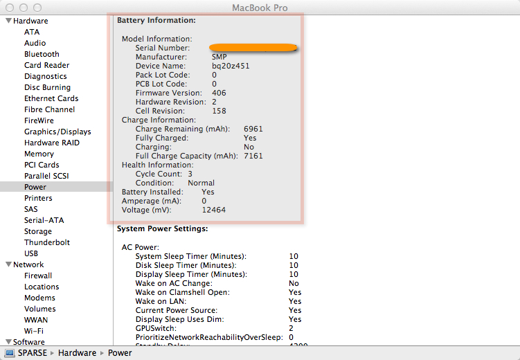

hmmm interesting, did you use coconutbattery.app on your last battery and on the new one? Would love to see if there are some differences :)
Old battery = 40% battery health with iStat Menus. 20 cycles. An Apple system report indicated that the battery should be serviced.
New battery = 100% battery health with iStat Menus. 3 cycles. Apple system report indicates battery is normal.

If you do a System Report (Apple menu -> About This Mac, and then click on the More Info button) there's a power section. Under Battery Information, there's a Health Information section. In my case the Condition wasn't "Normal". It was "Service Battery". That's what prompted me to take it in. I was concerned the battery might swell or leak, or overcharge depending on the specific problem the battery was experiencing.
Quick way to test your battery's condition: Hold down the option key and click your battery indicator on the menu bar, it should say something about the condition that isn't normally there.
