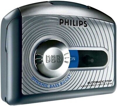

I'm using a tape recorder plugged into a behringer interface into my iMac mini M1. I'm using audacity. I've tried all different settings but I still get a loud hum over the audio when recording. I don't even have to press play to hear the hum on the recording. I checked the cables and everything seems fine. Any advice to fix this would be appreciated.
Picture of setup and video of good audio from tape and bad audio when recording

Ground loop hum. It's happening because voltage is getting introduced into the circuit somewhere without a path to discharge it to ground. The most common culprit is these cheap Behringer interfaces. The other problem is when attempting to use a headphone out instead of a line level out. The headphone out has different voltage and impedance than line level, and that bit of current is being amplified by the Behringer device into the RCA line that is expecting a line level signal.
Use a tape deck that has line level RCA outs and go a clean RCA to RCA cable with no adapters. NEVER go from a powered output to a line level input.
Reactions: Walkingdead
I don't know how to word this so it hits you less hard, but you're never ever going to get acceptable SQ from those kind of 'shoebox' cassette players in a thousand years: they're bad quality to start with, and even if they weren't bad quality, using the headphone output (which is amplified, basically straight from the speaker) to connect to the line-level inputs of your sound-card, is just never going to give good results anyway because the impedances and levels are totally mismatched. You need a proper cassette deck with RCA outputs at the back.
EDIT: this is basically the exact same advice I gave you in your previous thread of December 15th. It's too bad you didn't follow it, because absolutely predictably, the results you're getting with this shoebox machine are sh*te, and always will be.
