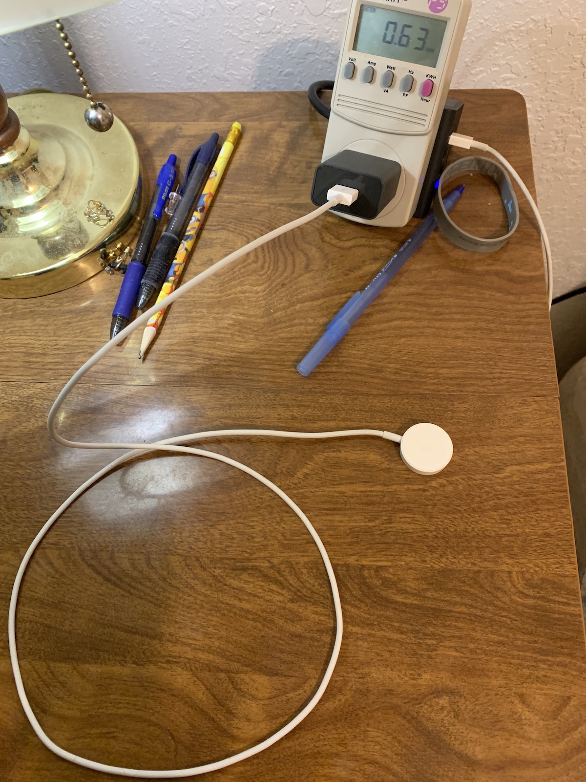

Greetings - Decided to run a 'Kill-a-watt' on my AW charger overnight to see how many Watt Hours my watch consumed to charge up to full. In the morning it registered about .18Kwh, or 180Wh, which I thought was WAY more than the watch battery could store. The same test on my iPad Pro, from 0% to 100% wasn't even that much. So I unhooked the watch wore it all day but left the meter plugged into the USB block that has the watch charge dongle on it. That night, 24 hours later, it had consumed .350 Kwh or 350 Watt Hours! This is a (relative) huge amount of electricity that is presumably used, even when the watch is not on it 'charging'. I even thought maybe my USB block was faulty, so I unhooked the AW Charger dongle and just ran the USB block on the watt meter for a day and it registered 0 usage. So, ya. I pay $.24 per Kwh for electricity, so sure, it only adds up to a couple bucks a month. But I had no idea it was that much. Assuming my math is correct. So If that's how much the AW Dongle uses (when not even charging), how much electricity does an iPhone, AW, Ear bud inductive charging pad use, when not 'charging'? Anyone have any idea....

MY AW5 charged up in a few hours last night, then I unplugged over night and in the morning the Kill-a-watt registered 630wh used and was still slowly climbing. I had put the AW1 on the AW5 puck, on the newer Kill-a-watt, overnight as well. It charged fine but in the morning that meter showed 0 Kwh used. So I give up.
I'm just going to assume it's either a problem with my (older) Kill-a-Watt or, more likely, the draw is so low that it just doesn't register properly on either one. So maybe the puck(s) do use power when not charging, or maybe not. But if it bugs me that much, I'll just unplug it when not in use...
