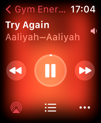

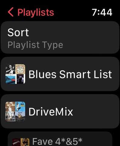

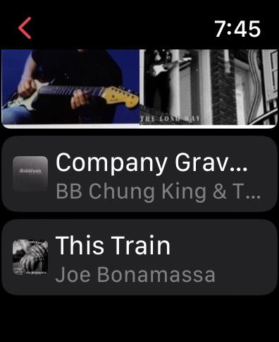

I updated to watchOS 9.1 yesterday and I was excited that my playlists were syncing. And then I discovered more bugs. Instead of just my selected playlists syncing, ALL playlist on my iPhone are syncing. And when I try to play some songs, I get an error: "Playing this item requires an Apple Music membership You can sign up in the Music app on your iPhone." All of my songs were purchased AAC files, not streamed, as I don't use Apple Music streaming.

But these are the playlists that show up on my watch (note the extra playlists):
The first song from my "Gym Energy" playlist plays:
But forwarding to subsequent songs shows this error:

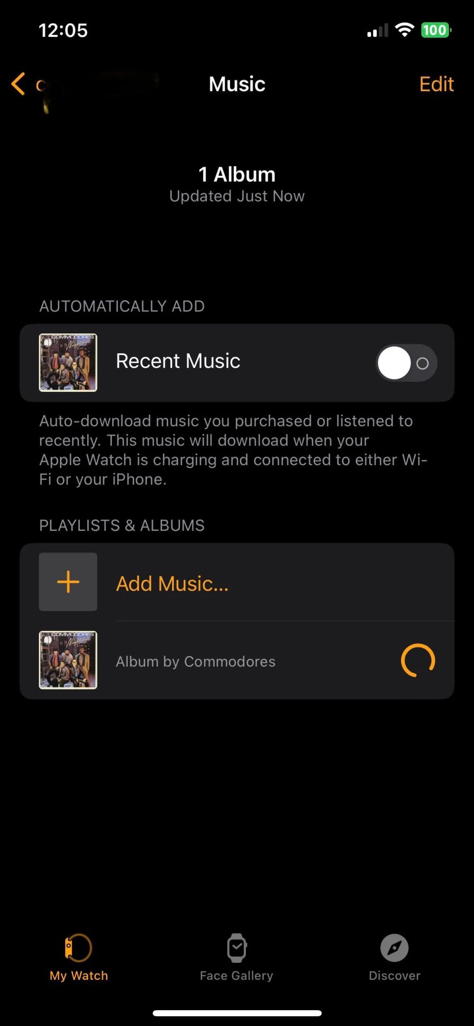

I didn't realize there was an existing thread around issues with Music syncing and Watch. I started a thread here:
in which I wrote:
I did not have issues downloading music to Apple Watch Ultra until the most recent update to WatchOS 9.1.
There's a "ghost" album/song that keeps indicating that it is downloading to the watch but I have never requested it to be downloaded. When I try to delete the download, at some point later the album/song will try to re-download again.
In addition, albums that I download will begin downloading and will show up on the Music screen of the Watch app, but at some point disappear no longer to show that it is an album either being downloaded or already downloaded.
In the screenshot below, it shows that an album by the Commodores is being downloaded (and it keeps spinning) even though I never asked it to be downloaded. I also had requested an album by Spyro Gyra to be downloaded and that has disappeared; that album is showing up on the Watch though.
What's going on? How do I fix?
Earlier, I wrote that you can report a bug online but that is not true according to a technical support rep I spoke to. You have to call Apple Technical support and create a case. Only the people that handle calls are allowed to escalate the issue to the engineering team. If you're having this issue please do so. If enough people do it, they'll realize it's not an isolated incident and the likelihood of a fix becomes greater.
