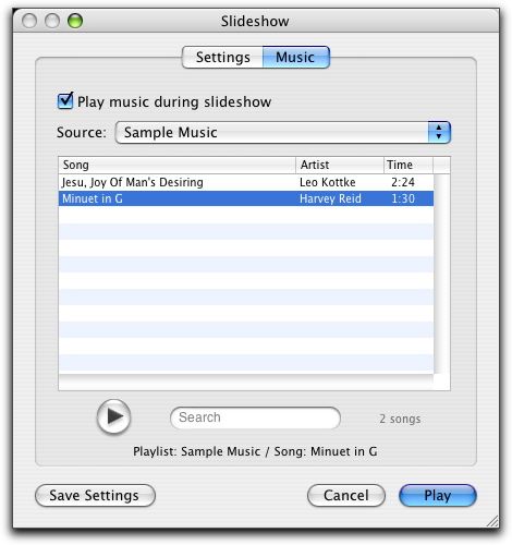

Hello, I have converted to the Mac after years of PC frustration. So far so good. I do have a couple of questions that I'm hoping some of you can help with. Is it possible to change the default music in iphoto slide show?

For iPhoto, go to the Music tab in the panel that comes up when starting a slide show, and select a different tune - you can choose from all your iTunes songs as well as a few default songs (use the 'Source' pull-down menu).

1) iPhoto -> Select a picture (any one, doesn't matter) -> Slide Show icon (at bottom) -> Music tab in window that opens. The rest should be self explainatory.

You can use any music you like (or none at all) in iPhoto. In the window to control slideshows there is a music tab. It's pretty self-explanaory

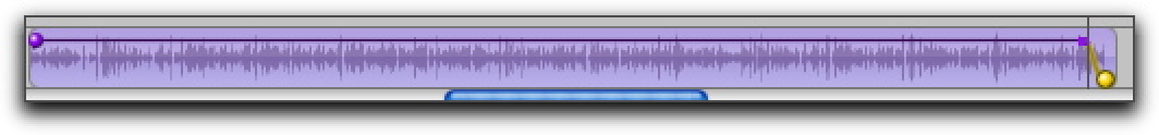

Miusic clips can fade if you want them to. Go into timeline view (the icon os a clock) and select your clip. Check the box that says 'edit volume'. Then click on the spot where you want ti to start fading. Click on the end of the clip and drag it down. You now have a nice even fade.
Here's a blow-up of one of the audio files in the timeline (click on attachment for larger view). Note the tiny little purple square above and to the left of the yellow circle - drag that to alter the shape of the ramp.
It's not easy to do, and iMovie could certainly improve its GUI here, but you can do it.
