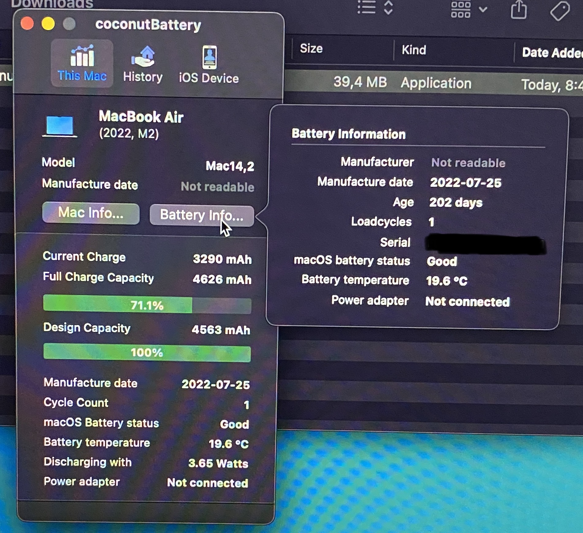

I would test the battery to see if it hasn't degraded too badly or so. Sitting discharged for some time might decrease the overall battery's life.
Reactions: BigMcGuire
Looks pretty normal to me. You can make sure by doing a calibration cycle, which will catch if there has been any further degradation (Charge to full -> leave for an hour -> discharge to 0% -> leave for an hour -> charge to full again).
I will say that I would be pretty surprised if there were any issues, lithium ion batteries can generally withstand being discharged for a month or two. There is a lot of management/safety circuitry in them that prevents them from being discharged to the point of being damaged.
It's worth noting that it's fairly common for Mac batteries to degrade more quickly during the first year than they do afterwards. Battery wear isn't always entirely linear with respect to time (at least according to Coconut Battery's online graph statistics). They can lose up to 10% or so within the first year of normal use, and this doesn't necessarily indicate that anything is wrong with the battery.

Seems odd the battery manufacturer cannot be determined. Is that normal for CoconutBattery? If not, where was the device purchased? If not Apple is it possible someone substituted a non-Apple battery?
It is normal. Same for me on M1 Pro bought directly from Apple. It is not practical for anyone to substitute battery in current Mac notebooks.

Yes! I am still using the laptop and its working fine. Coconutbattery shows that current capacity is 102% of the disign capacity. I have made over 15 cycles now and i dont see any issues.
How is yours doing?
