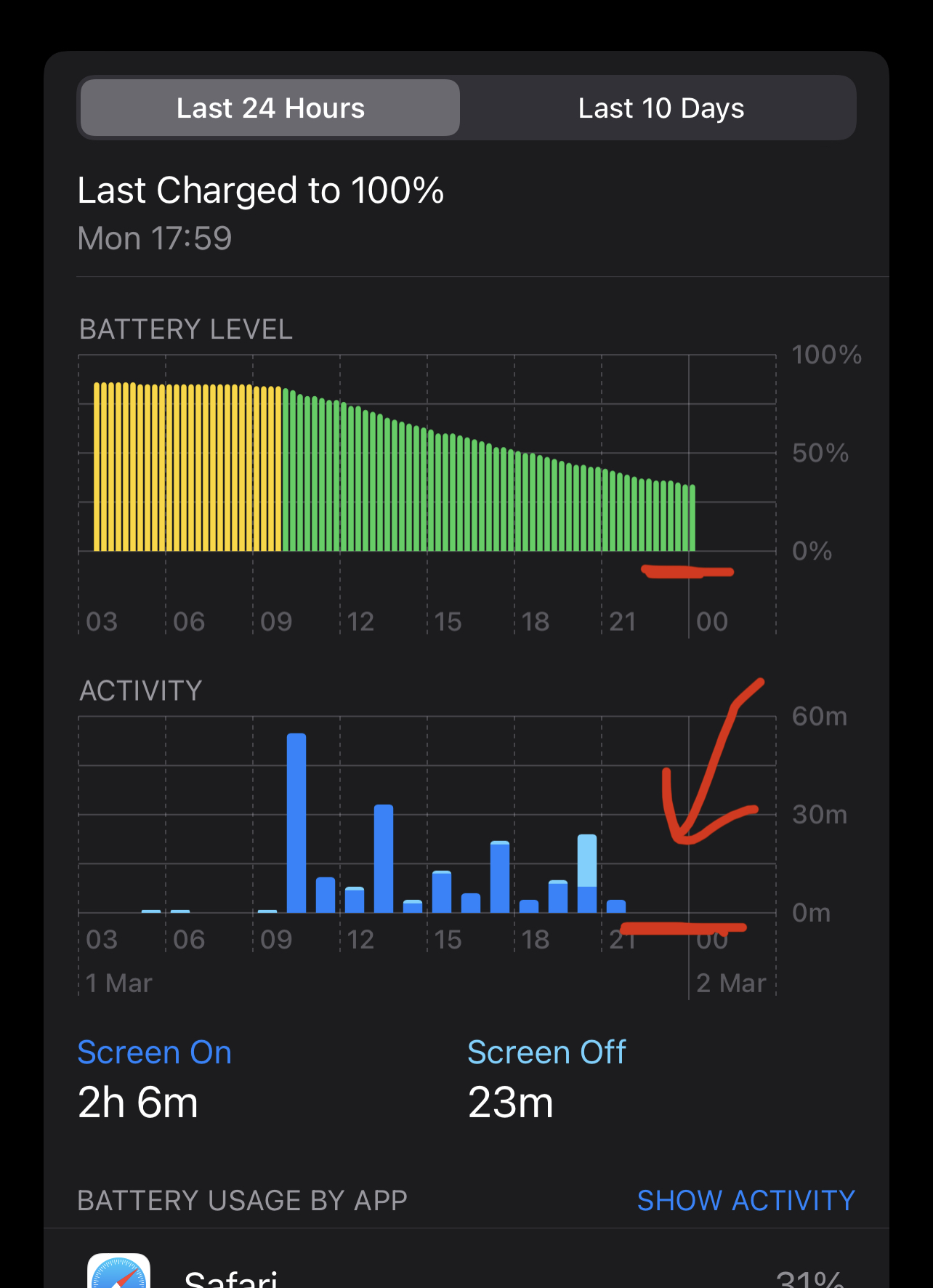

Look at this screenshot from iOS 14, that’s just not possible anymore

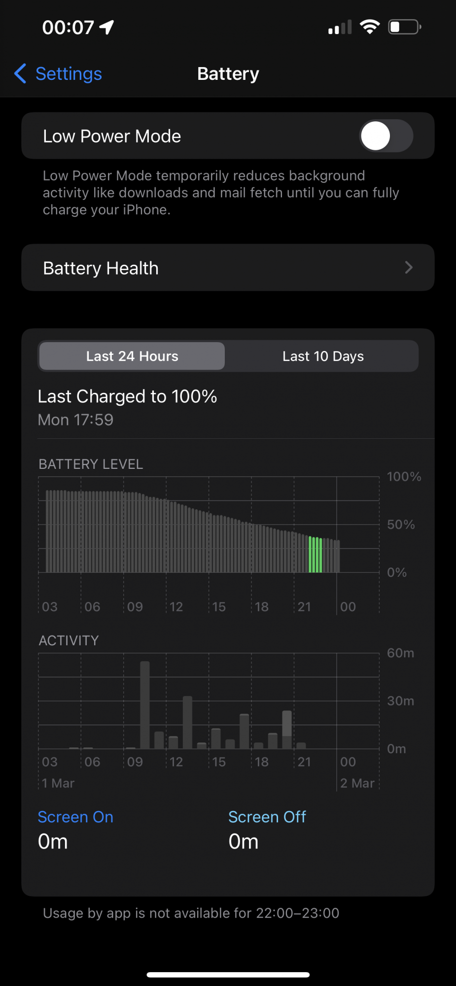

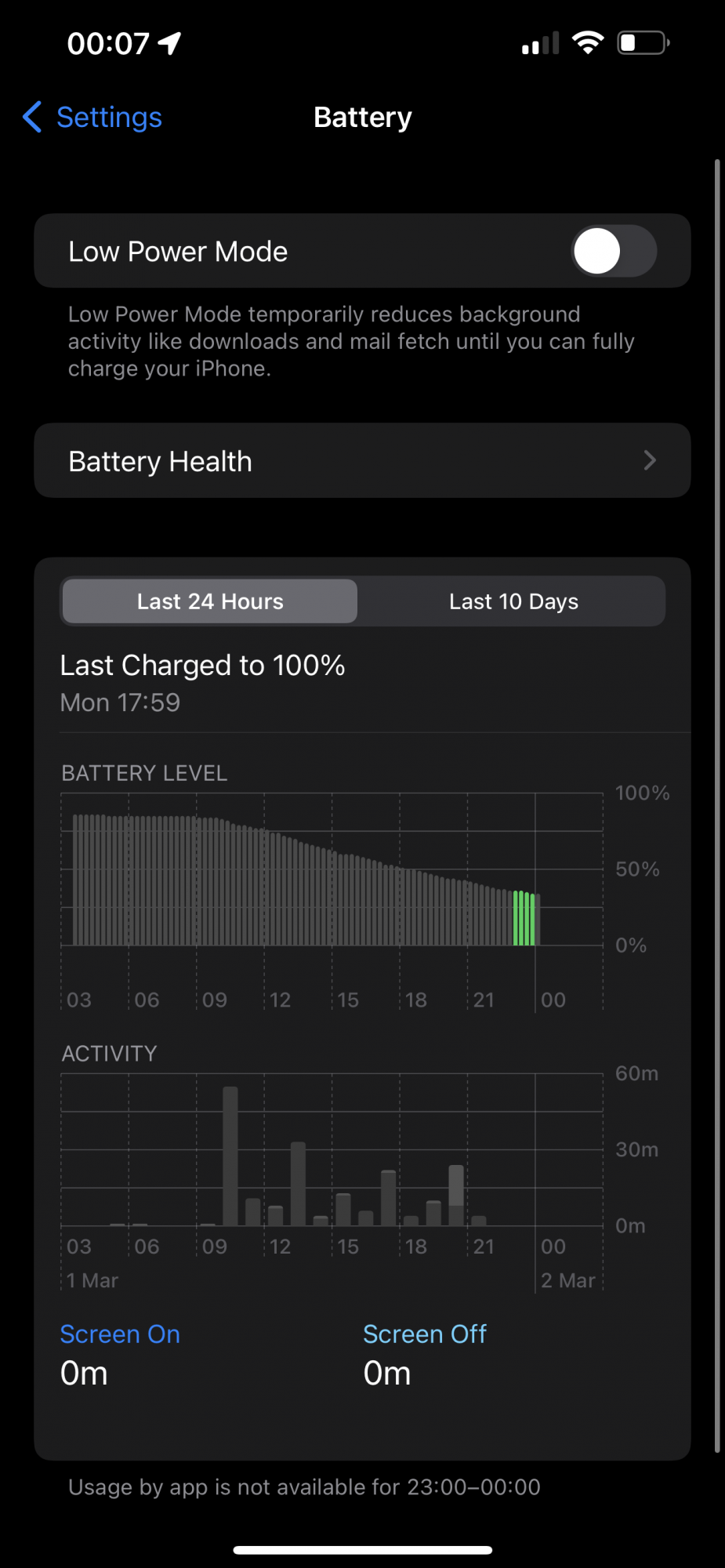

Some screenshots I took to show how weird the issue is.
Battery dropped 6-7% in 2 hours but there are no apps at all in the list
Would probably try @Taz Mangus's suggestion and see how it goes.

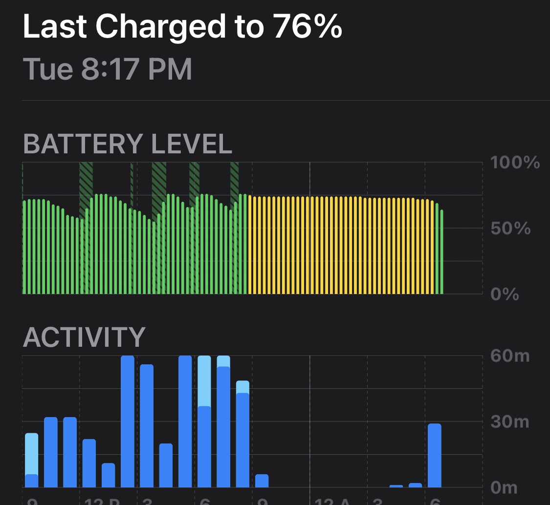

This graphic below is an iPhone 8 on iOS 14 over night. Airplane mode On, Bluetooth On, Wi-Fi Off, Low Power mode On, DND On.
Battery dropped 2% overnight
not being used
Reactions: shieldcy
thanks for the screenshot. Maybe there is a problem with my battery. Your stats seem quite reasonable.Would probably ask for a replacement if none of the above work for me.
