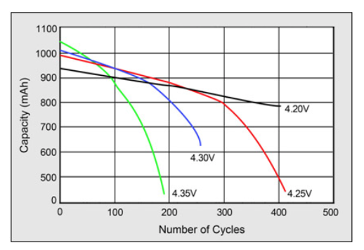

The iPhone battery has a nominal voltage of 3.7 to 3.8 depending on model (typical of all lithium ion batteries). The more you exceed that 3.7/3.8 nominal voltage the longer the battery will be able to maintain nominal output. 4.2volts max charge of most lithium ion batteries in consumer devices that strive for single charge longevity.
4.2volts (and 4.35volts with newer technologies) is as high as you can charge a lithium ion battery without accruing exponential harm to longevity (total cycles). This is how 4.2 became the 100% charge mark.
Products with lithium ion batteries that prioritize the batteries longevity typically dont exceed 4 volts. Examples would be electric vehicles, medical equipment, laptops set to "long life" mode, iPhone when using optimize battery health mode (which is just delaying peak battery charge).
Electric vehicles is a good example because manufacturers need to warranty the battery in miles. Around 4 volts (per cell) will deliver the most amount of mile out of a electric vehicle over the course of its battery life. If they charged all the cells to 4.2volts you could get A LOT more range which would sell great, until the battery needed to be replaced in 2 years.

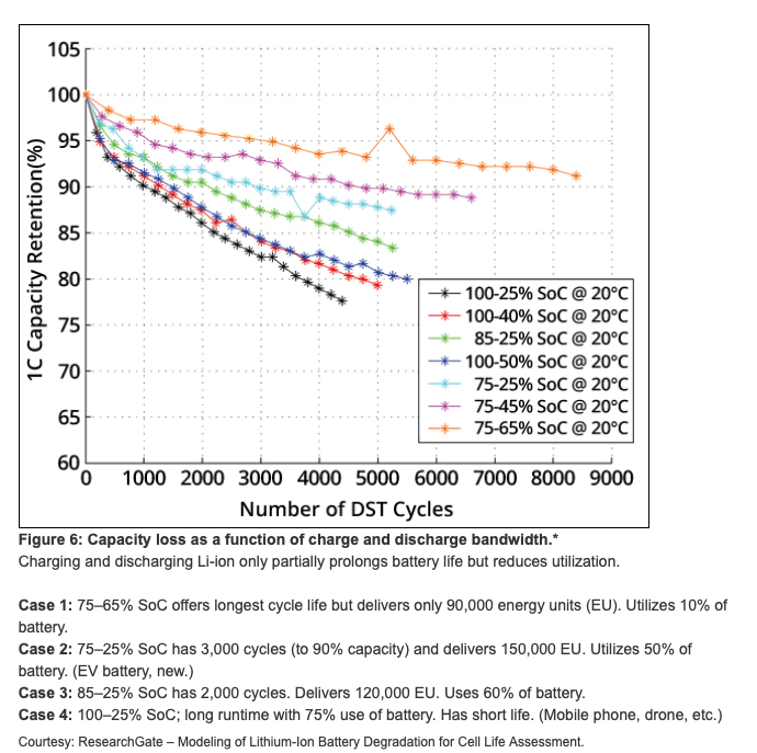

The depth of discharge is also important. The iPhone battery will be at 0% charge and turn off when battery voltage is 3-3.1v.
Here is a good visual aid.
Running the battery from 100% down to 25% is the worst for it (black line), knowing that 100% to 0% which is not on the chart would be even worse. This is pretty much what you stated. However we need to consider 100 to 0 would be every OTHER day while 100 to 50 would be every day (100 to 40 is red line).
While unrealistic in real world use 75% to 65% charge would be "way way better" for battery longevity.
Again I do not think anyone should go out of their way to practice 75%-65% charging but the extremes are states 100% and 0% are most harmful to keep the battery. Of course Apple even states for long term storage....

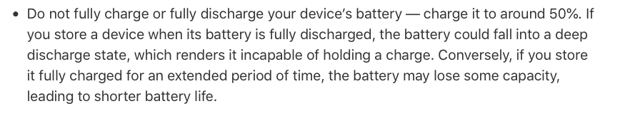

Apple link
Interesting in the above diagram the worst culprit methods of charging (blue black & red) are probably the majority of the population’s practice of charging devices while the healthier options require excessive faffing around to upkeep.
