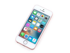

I'm using my original SE. Has anyone have this happen to them: charge the phone to full, leave it overnight and battery drops to 70%, wait a few hours drops to 35%, few more hours and drops to 1% and then stays like that for several days?
Charged it on Sunday, now on 1% since Monday (now Wednesday evening here). It's working fine by the way.
That battery is in a messed up state. You shouldn’t continue to use it just for safety reasons alone. I recommend a hard reset, if that doesn’t fix it then get it replaced ASAP.
I recently wiped the phone when I got the new SE (since returned). I just assumed the battery needed calibrating or something. Is it really dangerous?
Lithium ion batteries don’t need calibration. Malfunctioning battery is dangerous.
Thanks, it's now back to normal. Let it die and left it for a couple of hours and then did a full charge.
