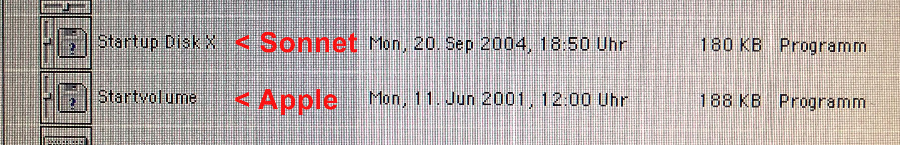

I'm really sure i had this problem too, but my sonnet has a extra control panel for that called Startup Disk X.
In the reality XpostFact is the only tool for me to select the bootdrive
Or perhaps something is wrong with your G4. you can test it by using Unreal flyby intro. If you see small lines in the rendering, there is a problem with the G4 that I cannot specify any further.
