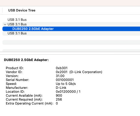

Under System Report, it does show up as long as it is plugged in:

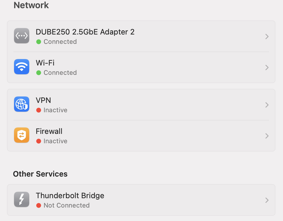

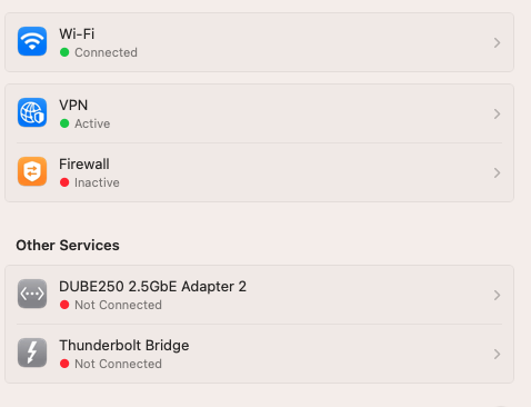

Whenever I unplug it, it is removed. Network settings is a different story. It always shows as Not Connected and is not functional unless it was plugged in from a cold boot or restarted:
I tried executing the commands you offered in Terminal, but it had no effect on getting the device to function without a reboot. It does always work after a restart or cold boot:

if it appears in the USB tree your Mac works perfectly. The commands I provided basically force the “detect everything connected on USB”-step usually done e.g. when you restart.
