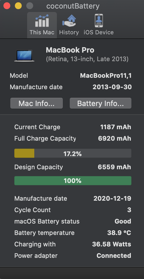

So today, I had my battery and thermal paste changed, after 7 years (since I last bought it)
I have a rMBP 13" Late 2013, 8GB RAM, 256GB SSD, 2,4 GHz Dual-Core Intel Core i5, Intel Iris 1536 MB
It was heating up a lot, battery lasted for like 2h, so I was quite sure I had to change the battery and thermal paste.
The fans didn't kick up that much though
It is summer now, but I still think I have wasted. 225eur?
I think it's still too hot though.

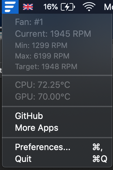

I have 3 TABS open on safari, Messages and downloading Big Sur right now and these are the temps (assuming Fanny is a viable widget for temps and fan speed):

I am a bit concerned, since I can't buy one right now and this money kind of cost me to get.
Should I be worried?

72.25°C on the CPU... That's not at all a problem. Intel's Thermal Junction is 100°C - The chips are designed to turbo and kick their gears as hard as they can if they have work to do, until they hit 100°C (or other limiting factors). - Which is also why the fan is nowhere near it's maximum RPM.

Hitting 100°C on the CPU is also OK, as long as it doesn't really exceed 100°C. 100°C is when it will start thermally managing and reducing/eliminating the turbo budget - in other words, it will stick more to the base frequency. If it remains at 100°C when the fans are at max and it's at base frequency it might try to go below base frequency. Only then are you technically "thermal throttling" below expected behaviour.
Depending on how you define "hot", yeah it's normal for the bottom and the bit right above the keyboard on the top to get quite hot/warm. - The aluminium shell of the laptop is to some degree part of the cooling system and the heat of the system is transferred through the metal so it's bound to get a bit hot :)

Yeah, when the fans kick (well, its only 1 fan on this model) kick in, the temperatures are then reduced quite severely.
I did try a small game, MTGA and it shoot up to 80/85C and the fan kicking at 4.5-5.5k
So I was a bit scared... So if you're saying at those temperatures I can still be ok and feel safe, then I am way more relieved...

Perfectly fine temperatures; In fact, most Macs will hover around 100°C during a lot of games :)
