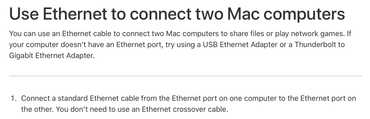

Ethernet is a great way to transfer data, but cable must be connected to a switch or router with multiple ports. You can not just run a standard ethernet cable between two computers, unless you have a crossover cable where the two pairs are switched (transmit & receive).
Actually you can, for migration assistant, because I have done it and it follows Apple instructions. The two Macs automatically create an ad hoc network between the two machines. It does not need a crossover cable. From Apple:
I actually did it during a migration assistant transfer. I was transferring via wifi which was painfully slow, so I just plugged an ethernet cable directly between the machines, while the transfer was happening (which may not have been the wisest time to do so.) Immediately it detected the direct connection and the transfer rate went from about 10MB/s to over 100MB/s, and I was done in about 40 minutes.

"Crossover" ethernet cables haven't been required with Macs for many years now...
Actually, I believe you can just connect between the two Macs. I used this approach when migrating to my current iMac from my last one.
Only note I will add is that to make sure you are using at least a CAT-5 cable to get fast transfer speeds.
I stand corrected, my networking business was long before I got my iMac, I did not realize Macs could to that. It was always standard procedure to use a crossover cable or hub/switch between two machines. I will use ethernet to transfer my data when I get my new iMac in the next couple weeks. Learn something new every day.
