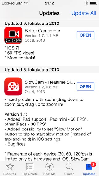

Appstore update notes below, along with those of the latest version of SlowCam ($1.99), of which I'll also publish a detailed review (as usual, click the image for the original one):

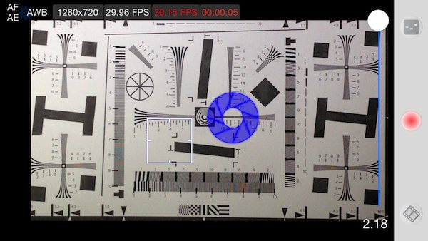

Here's a screenshot of the app in action while shooting the above 720p video:

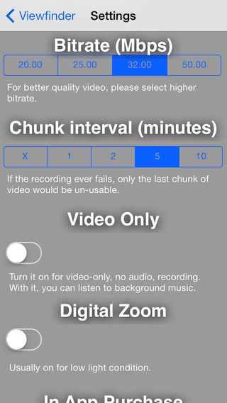

Pay special attention to the zoom slider on the right. Below it, a label shows the current zoom level. As you can see, it shows 2.18, which, as I've explained in my Lossless Zooming bible, corresponds to the maximal lossless zoom factor when shooting at 720p. (Again, the above reschart shot was shot at this very zoom factor.) The zoom slider only lets you use lossless zooming, unless you specifically enable digital (that is, lossy) zoom in Settings (see the Digital Zoom switch at the bottom):

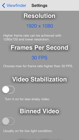

2. Equally rushed is the Video Stabilization switch in Settings (see the center of the following screenshot):
It just doesn't work. All the test videos I've shot were recorded with the stabilization off, independent of the state of this switch.
Hopefully, these bugs will be promptly ironed out. In the meantime, only shoot with this app if you really don't mind the lack of stabilization (because, say, you're shooting from a tripod) and don't forget to pay attention to the zoom slider bug to avoid shooting with an already-lossy zoom factor.
