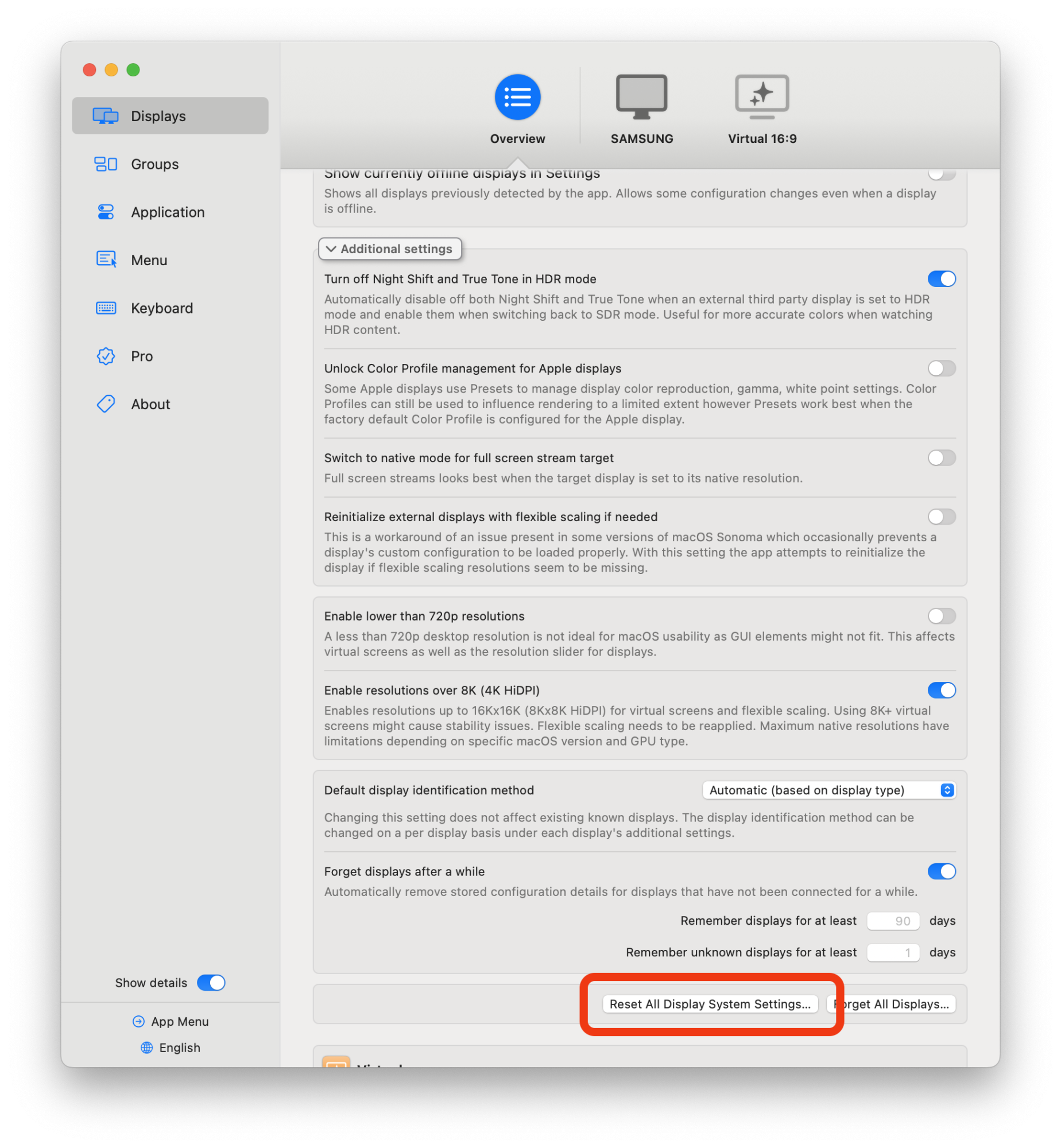

SOLUTION:
BD menu bar icon > Tool wheel icon at bottom > Displays > Overview > Additional Setting Drop-down > Reset All Display System Settings button (at bottom). 👍

Hi @PaulD-UK - if the issue happens only with one display connected, then it might be a display layout related issue (maybe a wrong display mode is being set). I simply recommend resetting the system display settings. You can do so here:
Alternatively here are the steps you can perform via Terminal to reset all display configuration stuff in macOS (and BetterDisplay):
Let me know if this does not work!

Yes, the suggestion of @joevt should work as well.
The suggestion of @Fishrrman would not work in this instance, as the problem is not with BetterDisplay but with the display mode stored for the one-display layout in some of the system files of macOS. Reinstalling, resetting, removing BetterDisplay will therefore not fix this problem (note: the app can simply be removed by moving it into the trash, it does not have any additional daemon or hidden process running that must be uninstalled separately, so AppCleaner is not particularly needed - all it might do additionally is to remove the userdefaults config file and the license info from under ~/Library/Preferences, but these are totally inert stuff without the app bundle present and the best practice for macOS is just leave these there in case of a future reinstall).
