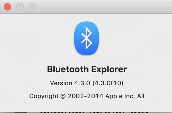

Advice: I'm not tech savy. In the past, I tried to resolve some obscure bluetooth glitch with a tool app made by Apple (Bluetooth Explorer). With it, you can observe & fiddle on bt devices; but I gave up and just kept wired.
I don't remember where did I get it from (google if you're interested). Captura de pantalla 2018-12-20 a las 15.54.58.png
