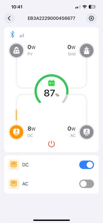

I have one of their EB3A units and have for a couple of years now. The key for me was a 10A DC output as it provides enough battery capacity for a few charges of my devices (including MacBook Pro) and the unit is robust enough to use as a portable power supply for radios and other gear I would normally carry a spare car battery for.
It connects directly to a 100A Solar panel I have installed to charge it and
It actually has enough DC output to startup, and sustain my Green Mountain pellet smoker grill for a few hours as well.
