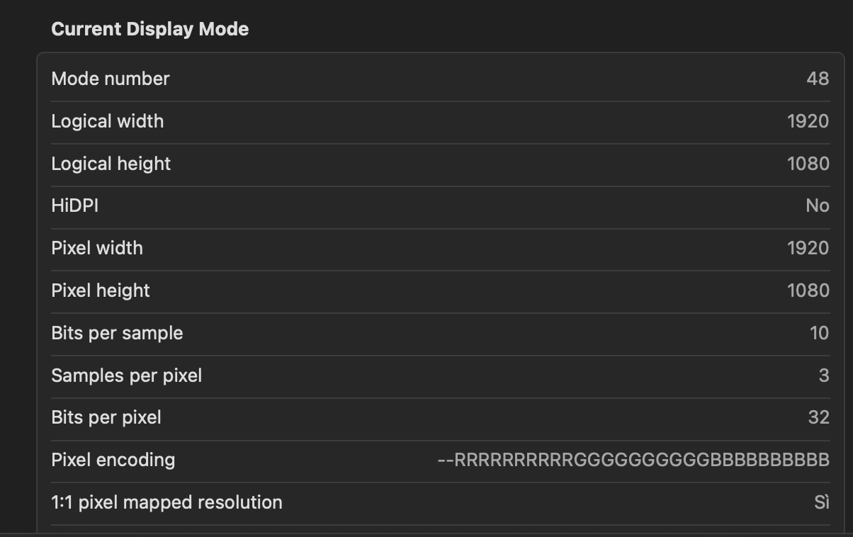

I have downloaded BetterDisplay and as far as I see here (screen attached), HiDPI is off (M3). With the M1, I can't find the same long list of information I get on the M3: the BetterDisplay version I am using on M1 is different (older) because it still runs Big Sur, maybe I just don't know where to find that information. However, the "change resolution" menu seems to have many resolutions available and all are prefixed LowDPI so I guess it's off on the M1 as well?
I am not sure how to interpret your last sentence: do you mean that it could be an hardware problem and buying again the same model could fix it? It sounds unlikely to me.
Yes, going by what you’ll find at those links, the remedy at which others seem to eventually arrive is exchanging the Mac. You are going through various steps trying to figure it out. At some point, “blame the product” may be all that’s left.

@HobeSoundDarryl I really have to thank you.
I played with BetterDisplay, enable hiDPI for the external monitor on the M3 and finally icons are rendered just right. Thanks!
