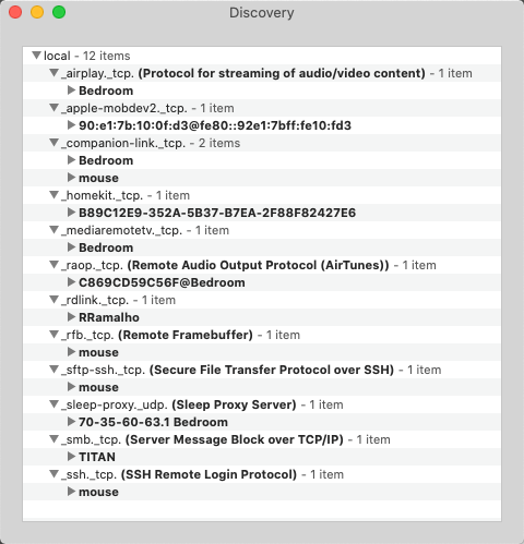

It seems that my mac can't find most services on the network via Bonjour/mDNS. My network is setup via DHCP, and I have IPv6 enabled (Link-local).

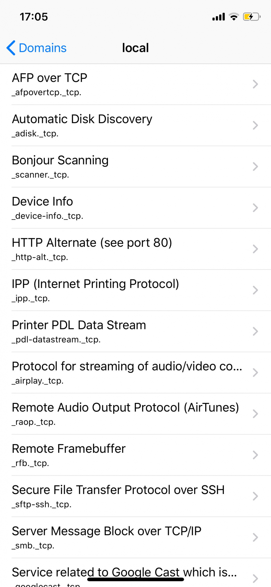

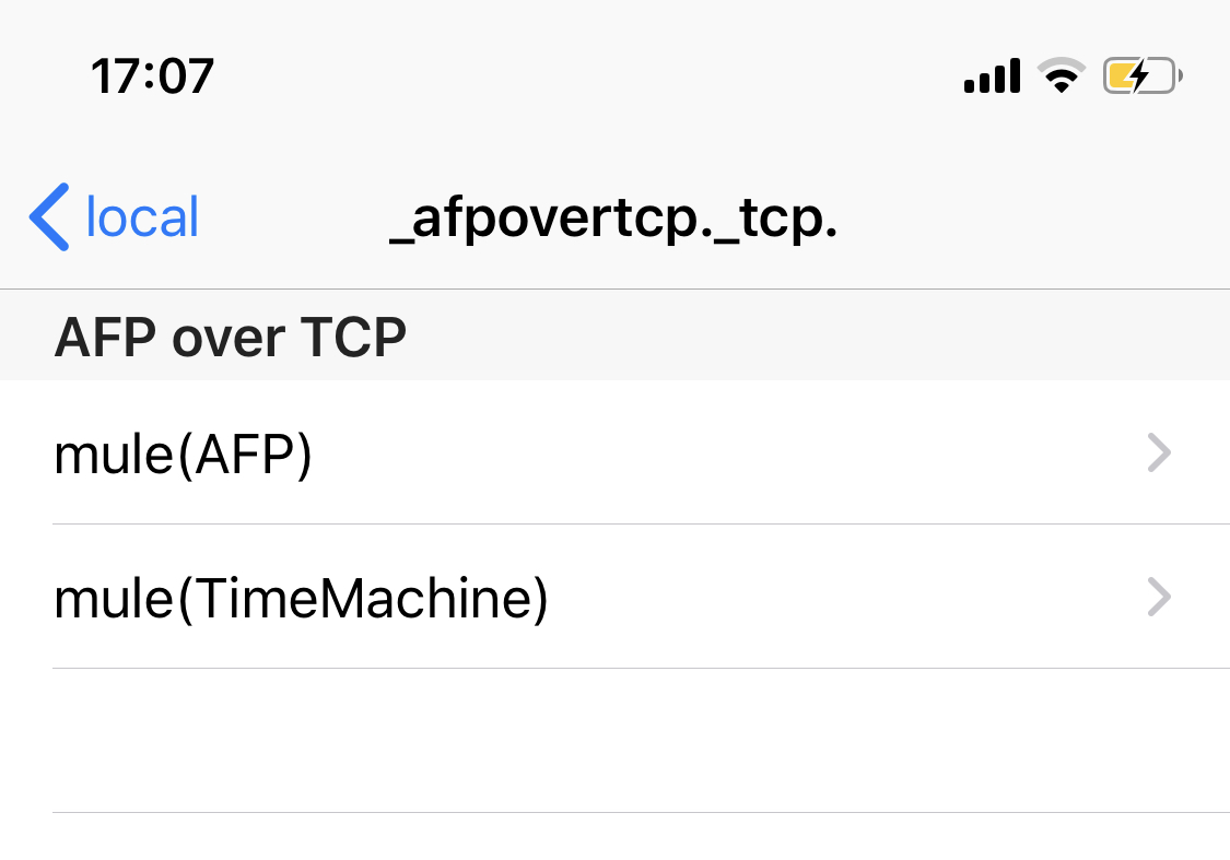

Using the program Discovery I can find some services, but not all.
Using the same program on iOS I can find all the programs/hosts on the network. Same network setup.

Using the dns-sd terminal program I get similar results.
