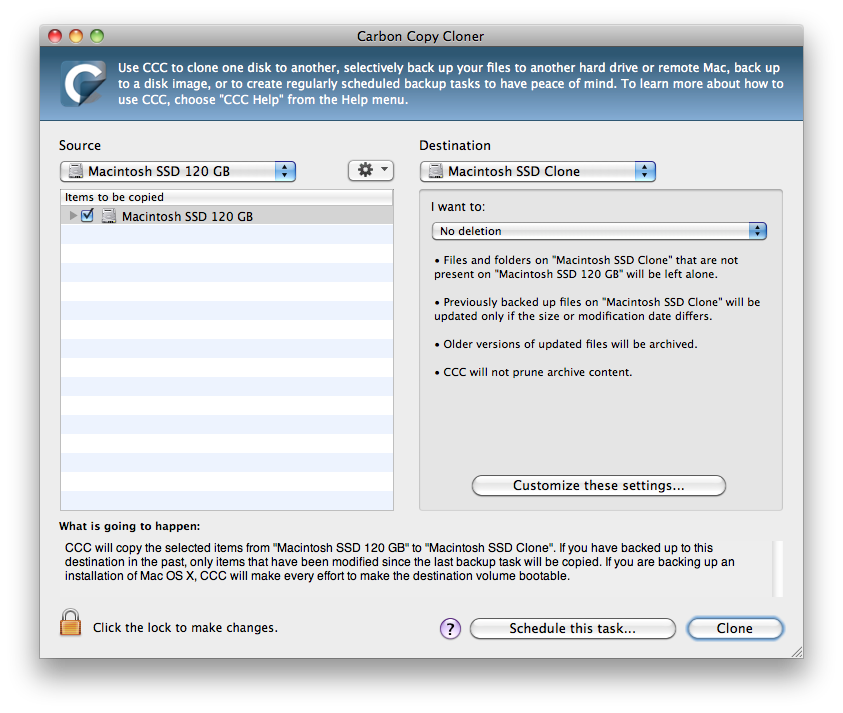

As CCC makes a bootable copy, be it to an external HDD connected via Firewire or USB 2.0 or an internal HDD connected via P-ATA or S-ATA, you can actually BOOT from that bootable copy.
1. Download CarbonCopyCloner
2. Connect the external HDD to your Mac, and either format it properly or have it already be in the proper format
3. Open CCC
4. Select "SOURCE" - which is your INTERNAL Mac OS X partition
5. Select "TARGET" - which is the partition on the external HDD you want to clone to
6. Click the "CLONE" button
7. Enter your password
8. Do whatever you want, spend time with the Mac or someone else
9. Cloning has finished
10. For easiness: Go to System Preferences > Startup Disk and select the clone and click "RESTART"
11. Wait for the restart to complete
12. Open Disk Utility
13. Format the internal HDD properly - see 2. for instructions
14. Repeat steps 3. to 11.

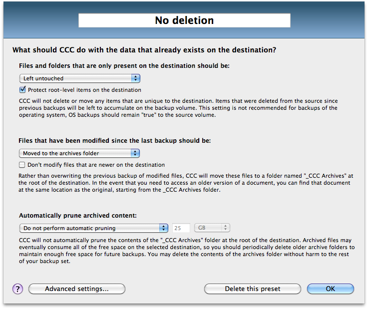

Also check the Advanced Settings to let CCC not delete contents on the target volume:
