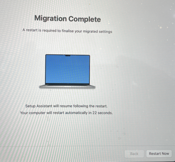

I followed this to the letter and , that is how I did it in the first place, and it does not work. after it almost finishes I get this window and when I click Restart it loops and returns to this window.
any idea as to how to fix?

Well it is an old bug but seems to have reappeared. As soon as you install MacOS from usb drive, when it reboots and you see black screen, pull out the usb stick, so it continues to boot into installation. Maybe this helps?

I have no problem getting back to the main internal disk. And if I unplug and select it, after plugging it in again, as the startup disk it tells me is not able to do so.

I do use the T7 it is a good piece of kit and I have several of them. Agreed Intel and before was easey. I remember the days where you just dragged and dropped the OS stuff across to an other disk.
I also found this How to Create Boothable disk and followed that, but again I get that loop.
Anybody any tips?
