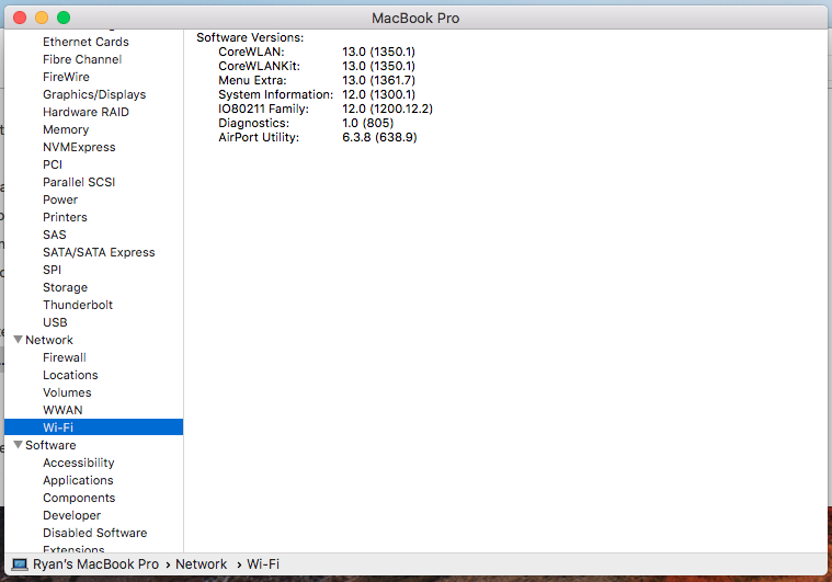

I decided, "hey, I'm using macOS High Sierra, why not put a newer airport card in and try running Continuity Activation Tool just to see what happens?". And so I did. Initially, I was surprised to see that WiFi and Bluetooth were working with my new card installed (the card being one from a Mid-2012 MBP 13"), and on top of that, AirDrop from my iPhone was working as well! I thought, "wow! this might of actually worked!" However, things kind of took a turn for the worse when I restarted and found that my WiFi stopped working, and the dropdown menu simply said there was no hardware installed. Despite this, Bluetooth continued to work perfectly fine.

The one thing that alarms me the most, is that in the boot picker menu, I don't even get an option to select a WiFi network, meaning that it's definitely beyond a software issue.

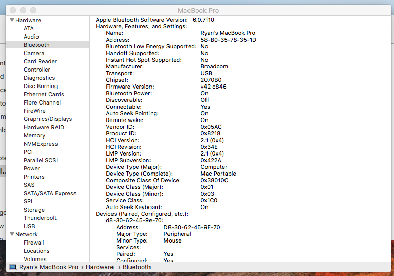

Attached are some screenshots of what System Profiler reports with BT/WiFi

If you've wiped the internal disk drive and done an internet recovery install already, then you can rule out a software issue. It's going to be hardware or firmware, however as far as I know the CAT only messes with Kexts (software level). Would be amazed if the firmware got touched in some way...yet my personal experience suggests that CAT is touching things that it shouldn't. Is SIP enabled or disabled?
Unlikely but (grasping for reasons) how sure are you that the flex cable and connectors weren't damaged? I am aware it worked initially and then a restart killed it, but it could have been originally a software problem and now a hardware problem.
