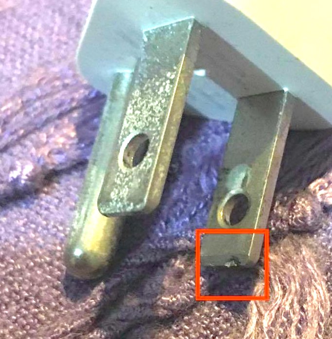

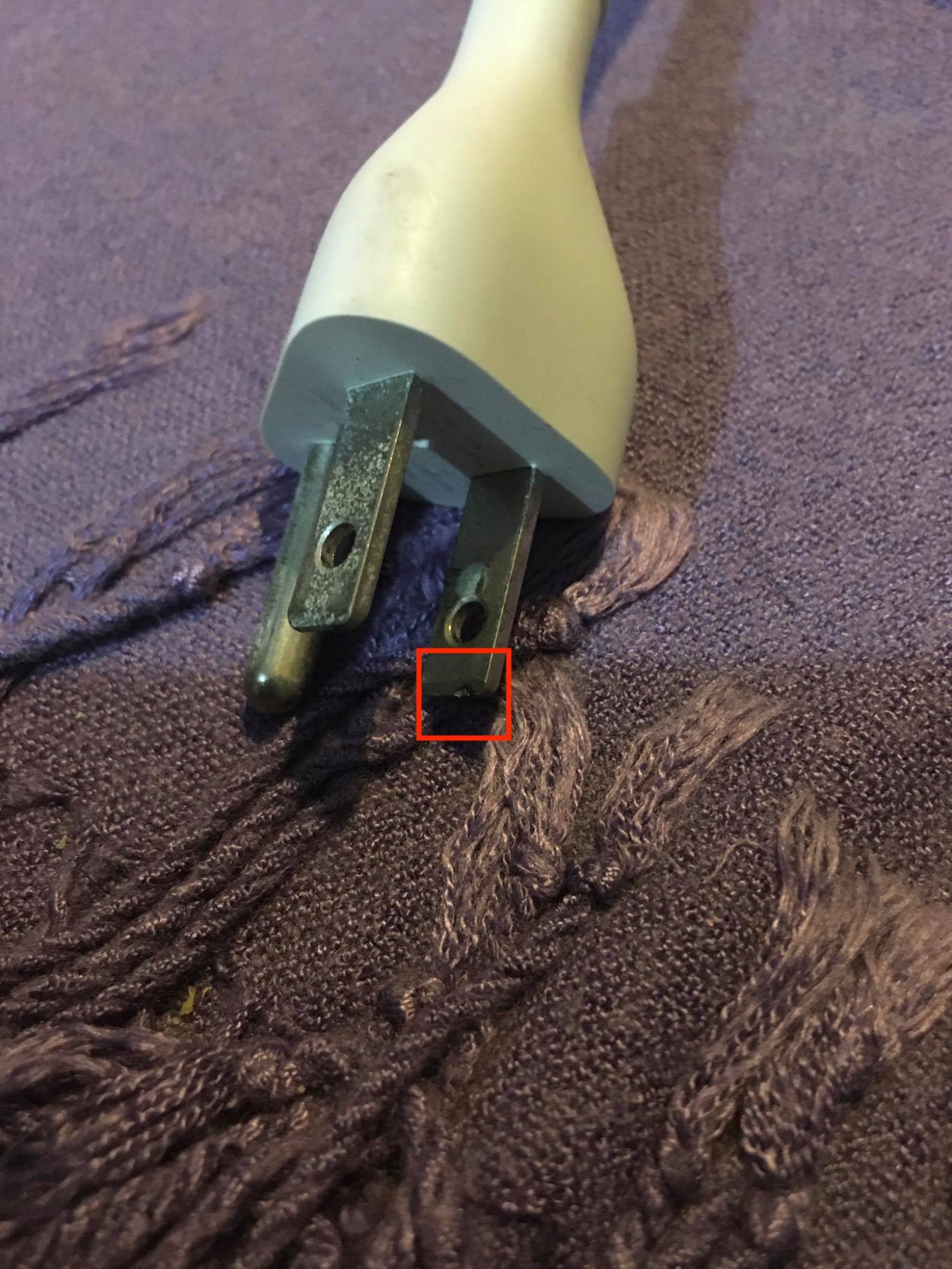

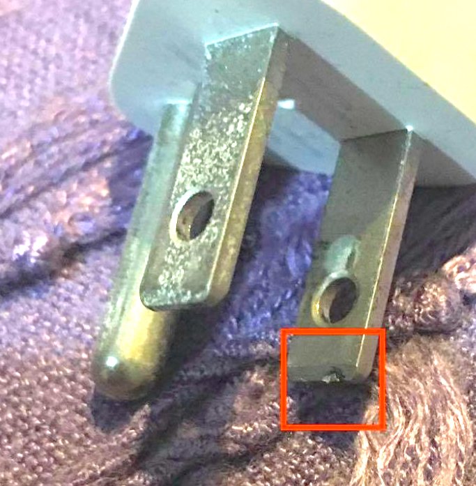

Is it still safe to use this AC cord, or am I better replacing it? I've noticed that every time I plug my iMac into my UPS, it would sometimes create a spark that may have caused the prong to melt.
A better image would help. Like this?
Thoughts:
It looks like poor contact between plug and outlet contacts is causing pitting due to arcing?
Could be either the cord, or... the outlet itself.
If you plug this cord into a DIFFERENT outlet, do you still get the same results?
I'd replace the cord.
Thoughts:

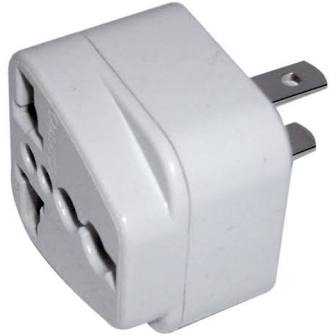

Sorry about the image. It seems like using a plug adapter like this stops the spark:
Plugging it into a different outlet yields the same result. Sometimes it sparks and sometimes it doesn't.

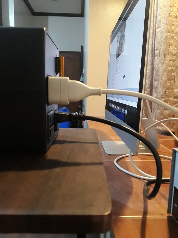

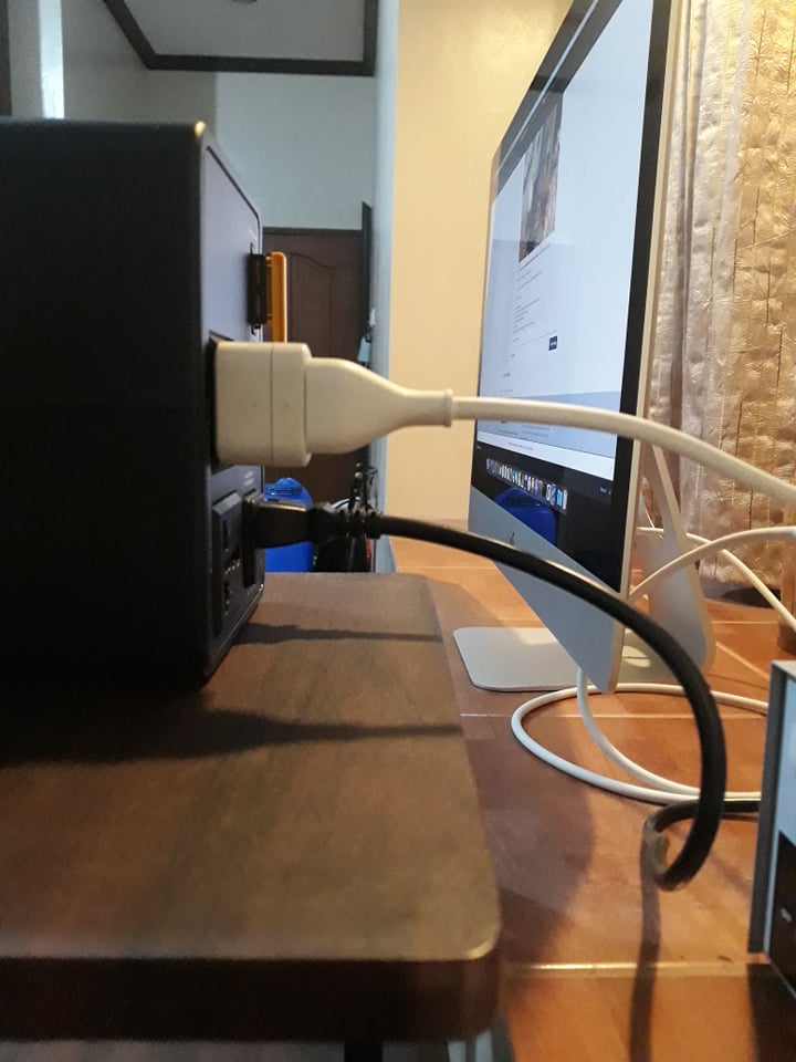

It's a UPS from APC. Blackouts are common here, especially during heavy thunderstorms. Plugging it directly into a wall outlet works just fine, but it isn't protected from surges and blackouts.

If the plug WORKS when plugged into the wall (i.e., no sparks)
but
If the plug DOESN'T WORK when plugged into the UPS (sparks)
then
Something isn't quite right with the UPS.
I suspect the outlet in the UPS doesn't make a good connection with the prongs on the plug.
Chances are, you may get another power cord and THE SAME THING will happen.
If you want to keep using that UPS, then use the small "adapter" you show in the pic above in reply 3.
That "stopped the spark", right?
Use what works....
That arc pitting is not even the slightest problem. Is your adapter removing ground connection?
