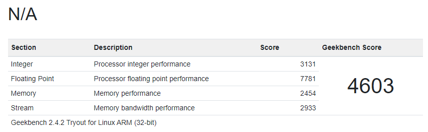

So it's been a little while since I've had too much to add, but the other day, a Raspberry Pi 4 just fell into my lap. A Pi 4 with all the bits to make it a full computer, too. After setting up Raspberry Pi OS, I realized something, the performance felt a lot like a G5 running Linux. To be honest? Maybe a little better. I'm not complaining about this, but I'm also not here to say that there's something wrong with these old PowerMacs. First up, the Pi has no hardware video acceleration, so like any PowerMac, it has to do that on CPU. Mine is doing it all without a fan at the moment, with nothing more than a tall heatsink, and 720p Youtube is only barely possible at all.
The only real difference is that I can do that in a current version of Chromium with h264ify, while my G5 has to use forked versions of Firefox and a lot more hacks to get anything like that to work. There's definitely more current ARM Linux 32-bit and 64-bit software out there than PPC Linux 32-bit and 64-bit Big Endian software, which is definitely a shame.
I was even able to throw it at geekbench 2, which gave me some interesting results: https://browser.geekbench.com/geekbench2/2726922
This is the headline, but it's worth looking at the individual scores as from what I can tell, PPC chips are good at wildly different things from this ARM soc. And, while it does have its own retro OS to play with, RISC OS doesn't exactly have the app library of the classic Mac OS, it's not even close.
I think the most meaningful difference is that the G5 Quad, a machine I would love to have, can't really touch a score like this, and uses 450 watts to get where it can, while this pulled this off at 5 watts, without even a fan to cool it. I haven't even started to overclock this thing.
If anything, this is making me wish that someone could make a PPC system on a chip with at least some sort of Mac OS compatibility. But, at the moment, I'm going to see where emulators can get me. I've heard that a Pi is the best Amiga, I'll have to see if the same is true for similarly aged Macs.
I would disagree.
The last time I ran GB on my Quad was August 5, 2017. My Quad scored 3685. Now that's about 1000pts less to be sure and the Pi is much more modern. My Quad will never catch it.
But can't really touch? IDK.
As to wattage…absolutely the Pi beats it hands down. But a lot of keyboard punching has been spent over how much power these things use and I just don't see it in my electric bill.

I'm not making a value judgment here. The G5 certainly isn't worse.
It's just good at different things, and wildly so. A G5 Quad with the score of 3460 isn't quite as good as yours but it makes for a useful comparison. For me, the important part is that you can put it in your pocket. I have plenty of working retro hardware, but I didn't expect the $30 toy computer to be this good!
I do wish there was a way to do an apples to apples comparison between graphics hardware, but I can't think of any benchmarks that they both have access to that would give them both their best chances. Really, i was lucky there's a Geekbench2 build out for ARM Linux. I can't just stick more ram in my 2gb Pi, either, so if I want to do some of the more wild things you can do with one, I'd need to buy another one, which I'm pretty sure would cost more than the same amount of ram for a G5, especially in this economy.

And my Pi 4 at stock clocks can score better than all but two of the Opterons. Again, stock 1.5 Ghz clock speed, no fan. I'm gettin a fan and can bump it up to 2 Ghz. But, what I'm taking away from all of this is that the G5 was robbed. Those x86 systems aren't that much more powerful, but they have so much more software available to them. Apple sent out a PPC cpu knowing they were going to kill it in about 2 years, and they had to take a step back from 64-bit software just to do it. It worked out for them, but where was all the 64-bit PPC Mac software?
