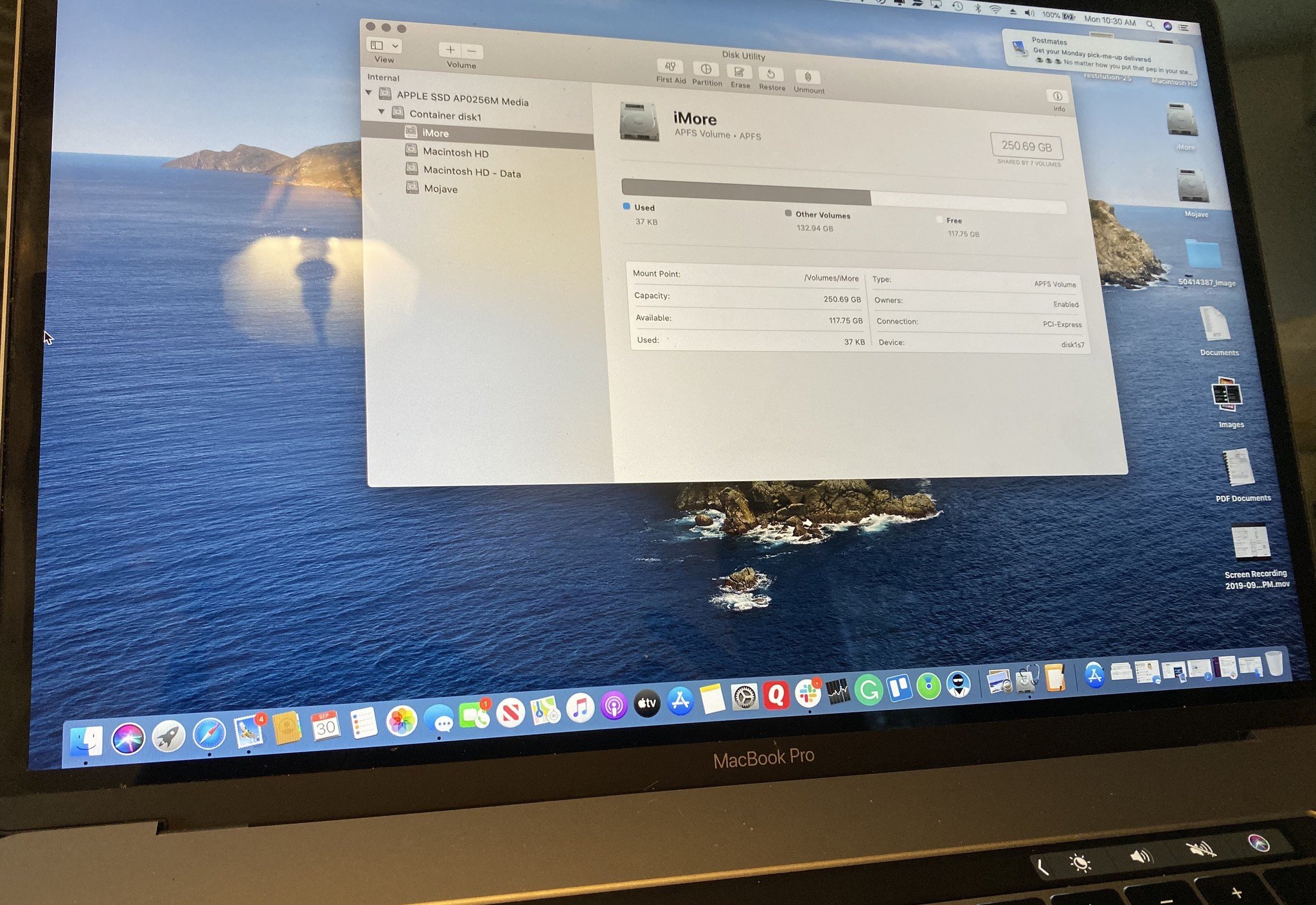

In Disk Utility I have created a new APFS partition with the intention of installing Mojave there. I already have the Movaje installer downloaded from the App Store on my default partition running Catalina, thanks to my earlier VM-based attempts. The installer will not open directly with a double-click, presumably because it's 32-bit ("This copy of the 'Install macOS' application is too old to be opened on this version of macOS"). How can I use it?

You can do this without an issue. You don't actually need to partition- you can make a new APFS volume and install Mojave to it.
The volumes will share storage space, and don't require you to shrink your existing Catalina installation. If you decide not to use Mojave in the future, you can just delete the Mojave APFS volume without affecting your Catalina installation whatsoever.
Bootcamp is for Windows installation, it has nothing to do with this process.

Command-option-shift-R won't work in this case because it will download a version of macOS that's too old to use the APFS disk, so you'd need to follow one of the links for Mojave or High Sierra. (Using Google to search for "download macOS Mojave" found this page: https://support.apple.com/en-us/HT210190)
The process to install on the new APFS volume is no different than it would be if you'd partitioned the disk. You may need to make a USB install disk. Directions are here: https://support.apple.com/en-us/HT201372
