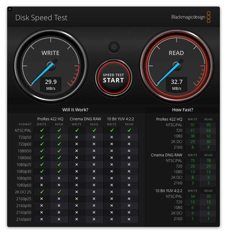

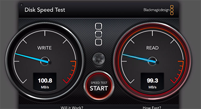

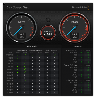

These are Black Magic Disk Speed tests on my 2014 Mini's 2400rpm spinner
and a 4TB Seagate Backup Plus bus powered USB drive.
Of course, YMMV

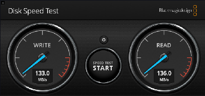

Wow, my mileage varies a lot! That must be a USB 2.0 disk. Here is one of my 5TB Seagate external USB 3.0 disks. I also have some 2TB USB disks that clock around 170MB/sec.

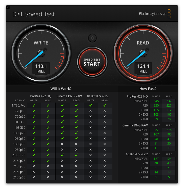

This is the internal 1TB drive on my 2014 2.8ghz Mini, quite a difference there too. This is about the same speed as the 500gb internal disk on my 2014 1.4ghz Mini. The difference might be that your disk is fragmented, while I don't really use my internals for anything.

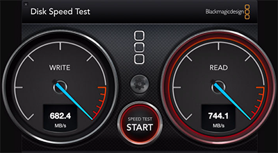

Just a couple others, for comparison. This is the original Apple 128gb internal SSD on my 2014 2.8ghz Mini (split from the Fusion Drive)

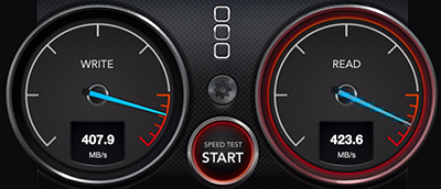

And this is my Oyen Digital 4TB external USB SSD that I use as a media drive
I suspect the USB drive would be roughly half as fast as a 2014 Mini's internal 5400rpm HDD.
Of course, YMMV
GetRealBro

I don't see how a USB 3.0 hard disk could be that slow unless it's connected to a USB 2.0 port or hub. I have a couple of the litte WD MyPassport bus-powered USB 3.0 disks. They clock at about 100MB/sec. But I also have a variety of old USB 2.0 disks and they top out around 35MB/sec, like the results that @getrealbro posted.

I’ve been using the 2014 Mini’s internal HDD as a scratch drive for real time streaming videos lately. So it may be badly fragmented. And I’m not sure whether the Seagate 4TB bus powered USB drive is USB 2 or USB3. But I’ve had it long enough that it may very well be USB2.
Here is a previous speed test on the 2014 Mini’s internal drive

...Yes, getrealbro, was your drive usb2 or 3? Also was it 5400 rpm?...
In retrospect, I'm not sure whether the old 4TB bus powered USB drive I tested is USB2 or 3. But I guess it is only USB2 given the results of the speed test. I'm pretty sure that Apple was installing 5400rpm HDDs in the 2014 Minis.
BTW BlackMagic Speed Test is available for free on the macOS app store. So you could check your existing drives.

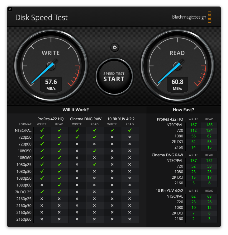

I did the blackmagic speed test on my internal drive and got similar slow speeds to Getrealbro’s at about 60 MB/s read/write...
