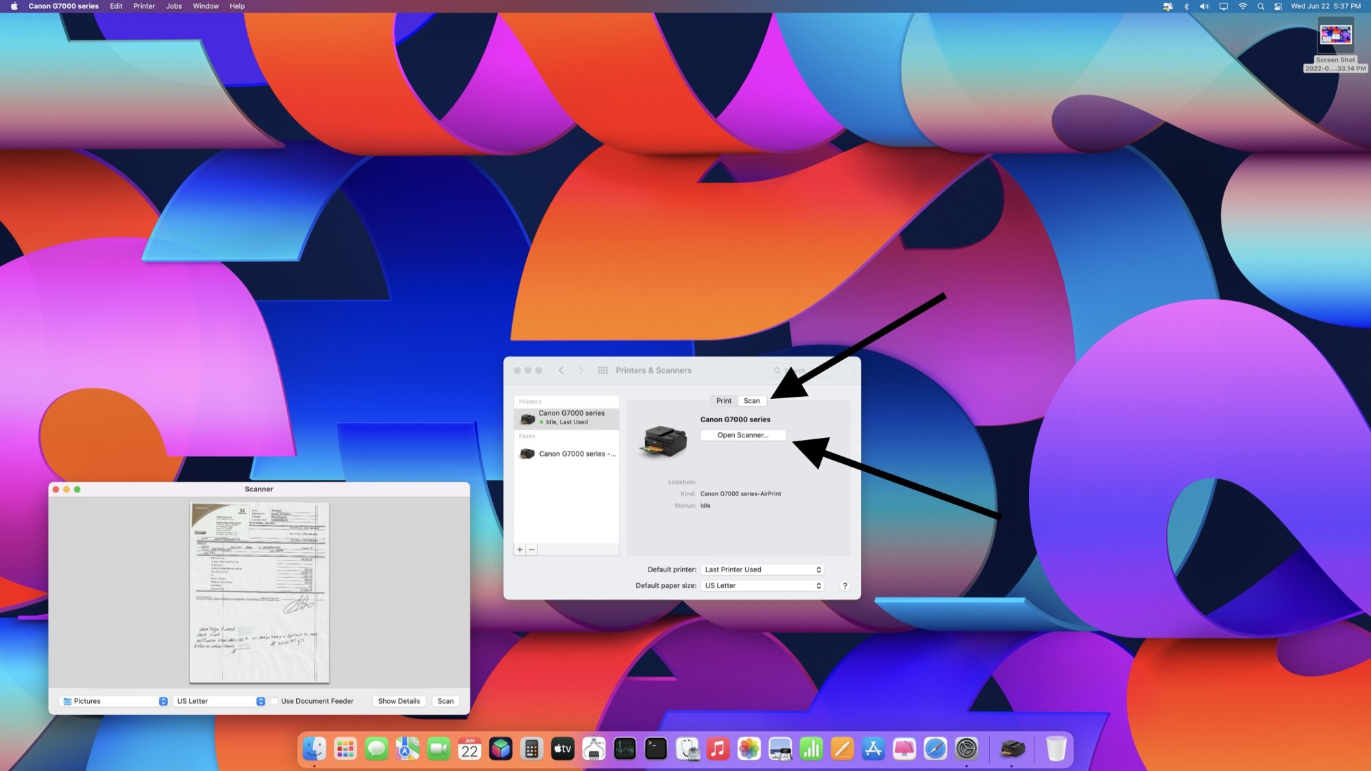

What I did with my new canon printer (G 7020) to get it to scan was to open “System Preferences“, then clicked on printer and scanner. Then clicked on “Open scanner“ as shown below. Of course I have the new Mac Studio. Mine scans each and every time. I wanted to set up the scan function on my printer itself, but I couldn’t get it to work, so I used system preferences. On my iPhone or iPad I use the canon print selfiy app to make scanned copies. No issues with that. Sorry for your troubles
