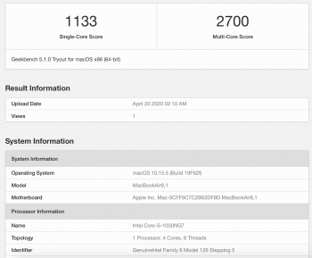

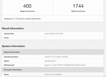

I just ran Geekbench 5 on my i5/8/256 with and without turbo. No turbo is... bad.
Turbo: single: 1133, multi 2700
Disabled: single 400, multi 1744
In actual usage, I don't notice too much of a difference. I don't too many heavy usage tasks, though.
In actual usage, I don't notice too much of a difference. I don't too many heavy usage task, though.

Thanks for that! Interesting the scores are quite a lot lower than some of the reviewers have been getting. They seem to suggest ~1300 on single, and 3500 on multi.
Maybe you were running other stuff at the same time!

Just ran a few more tests from dead idle. Nothing running. CPU at lowest usage, temps as low as they normally idle. Got the same results. I think the 3200 multi scores are for 16GB RAM units. At least it seems that way from a cursory search of the Geekbench browser for i5 models. 8GB units seem to be right around where my scores are falling.
No complaints about battery life though I haven't had much time to test that really. I tested locally playing H264 high bitrate 1080p movies and some smaller 1-2 hour, medium bitrate H265 TV episodes at about 1/2-2/3 brightness and found a 10%/hour battery drain.. good for ~10hrs playback. Im happy with that as I won't do much more than that on battery.
The only time I hear the fan is when I'm doing something to invoke them at high RPMs. Really the only time they EVER come on are for benchmarks, system updates/initial system setup, or transferring large files over USB C to ethernet adapter. Under normal use for me - safari, word/pages, music, mail, PDFs, my temps are 45-50C and my fan is completely off.

Geekbench does cause the fans to spin up, but only to about 4000 RPM, not the max 8000. It doesn't get the CPU up to 100C long enough to warrant that, it seems.
I use Turbo Boost Switcher Pro to enable/disable turbo. It can automate enabling/disabling based on apps running, or charging state.
I imported a 2 minutes 1080p/60fps video into iMovie. Merged a copy of it to itself for a total of 4 minutes.
Turbo: 2m30s export. CPU 80-100C, fans at 3700-4000RPM.
No Turbo: 2m30s export. CPU 80-100C, fans at 3700-4000RPM
Intel Power Gadget shows the GPU kicking in quite a bit (unsurprising) so I imagine that's why the exports are the same as they're GPU bound.
How have you found the i5 - battery life and fan noise are the most important requirements for me
cheers
Those seem really high. The i7 gets around 1200/3200. The i5 gets around 1100/2800 from what I have seen.
