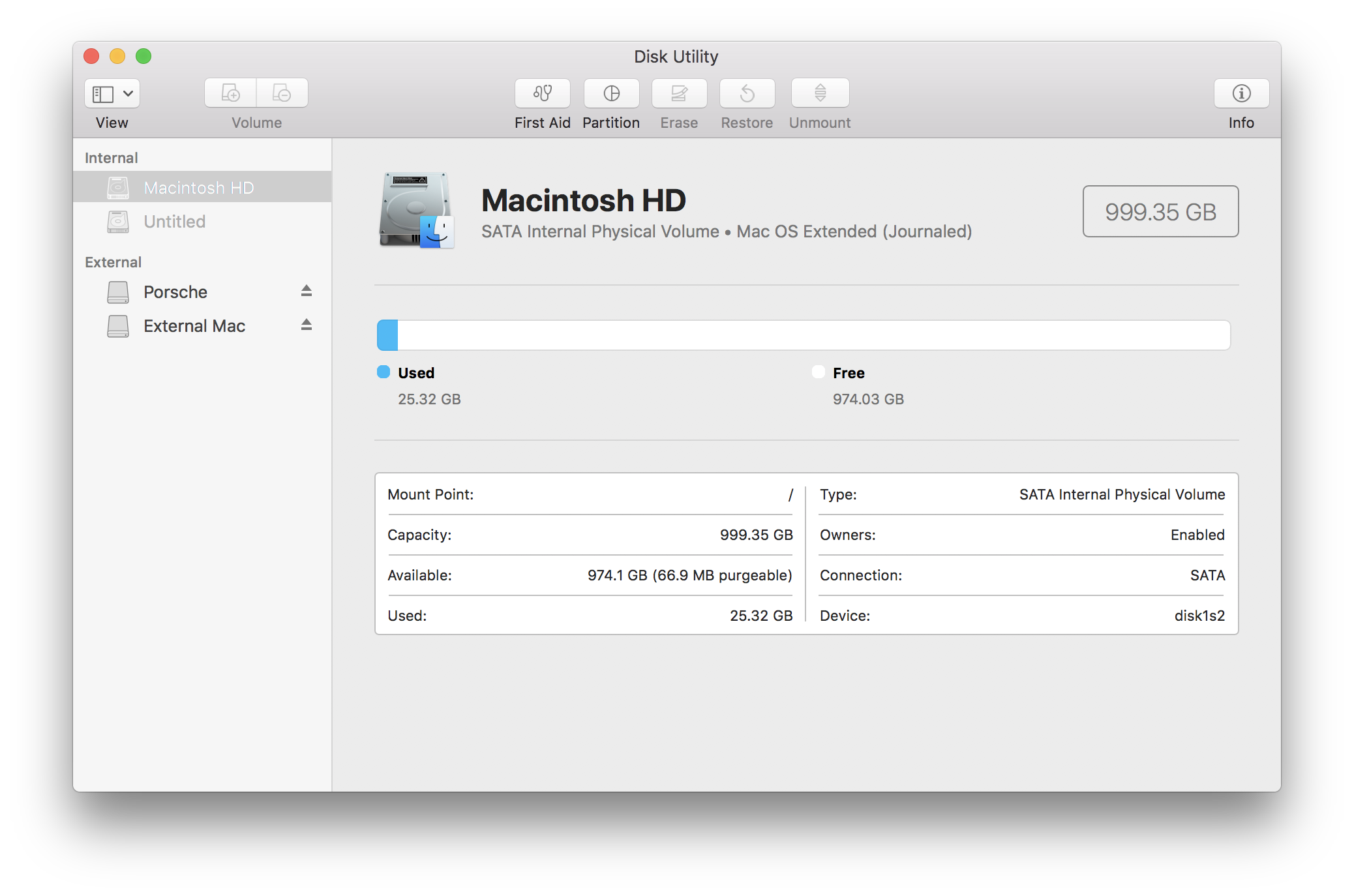

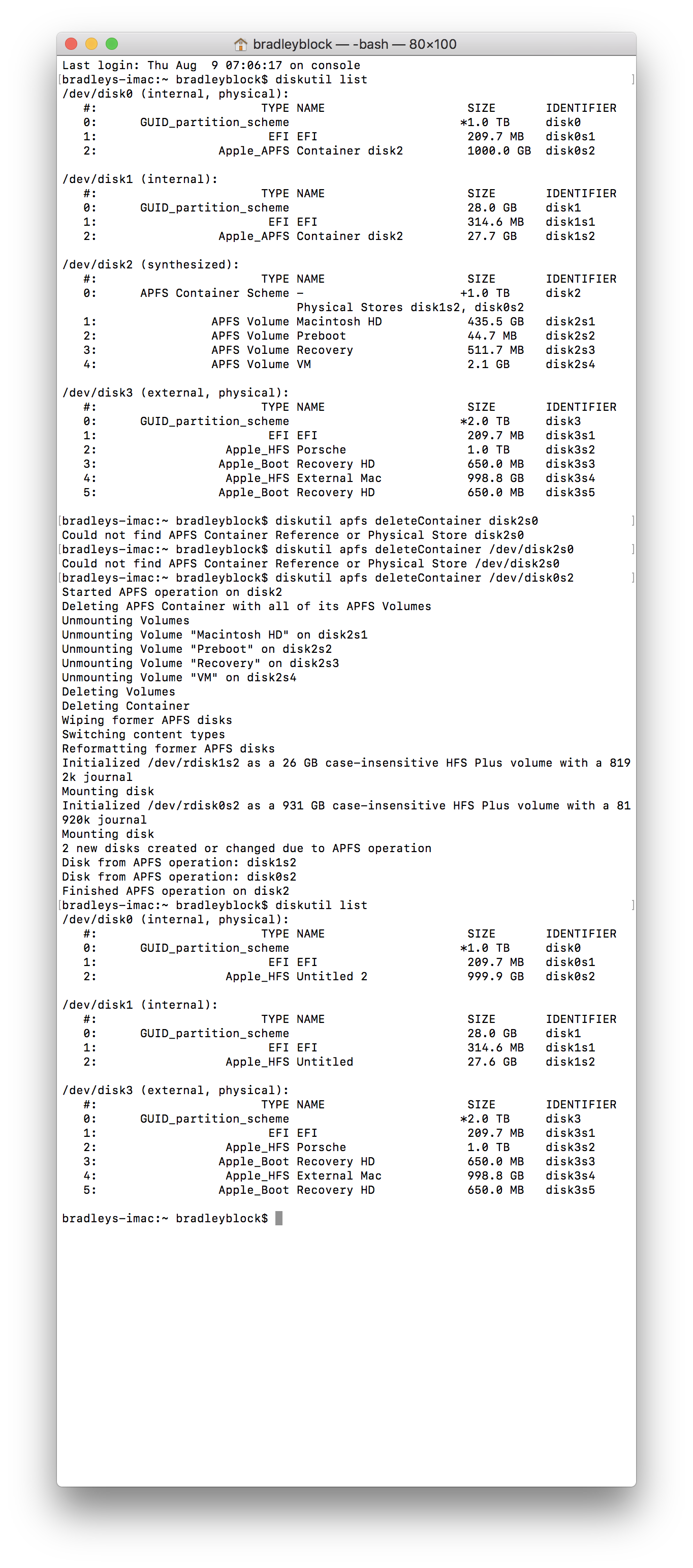

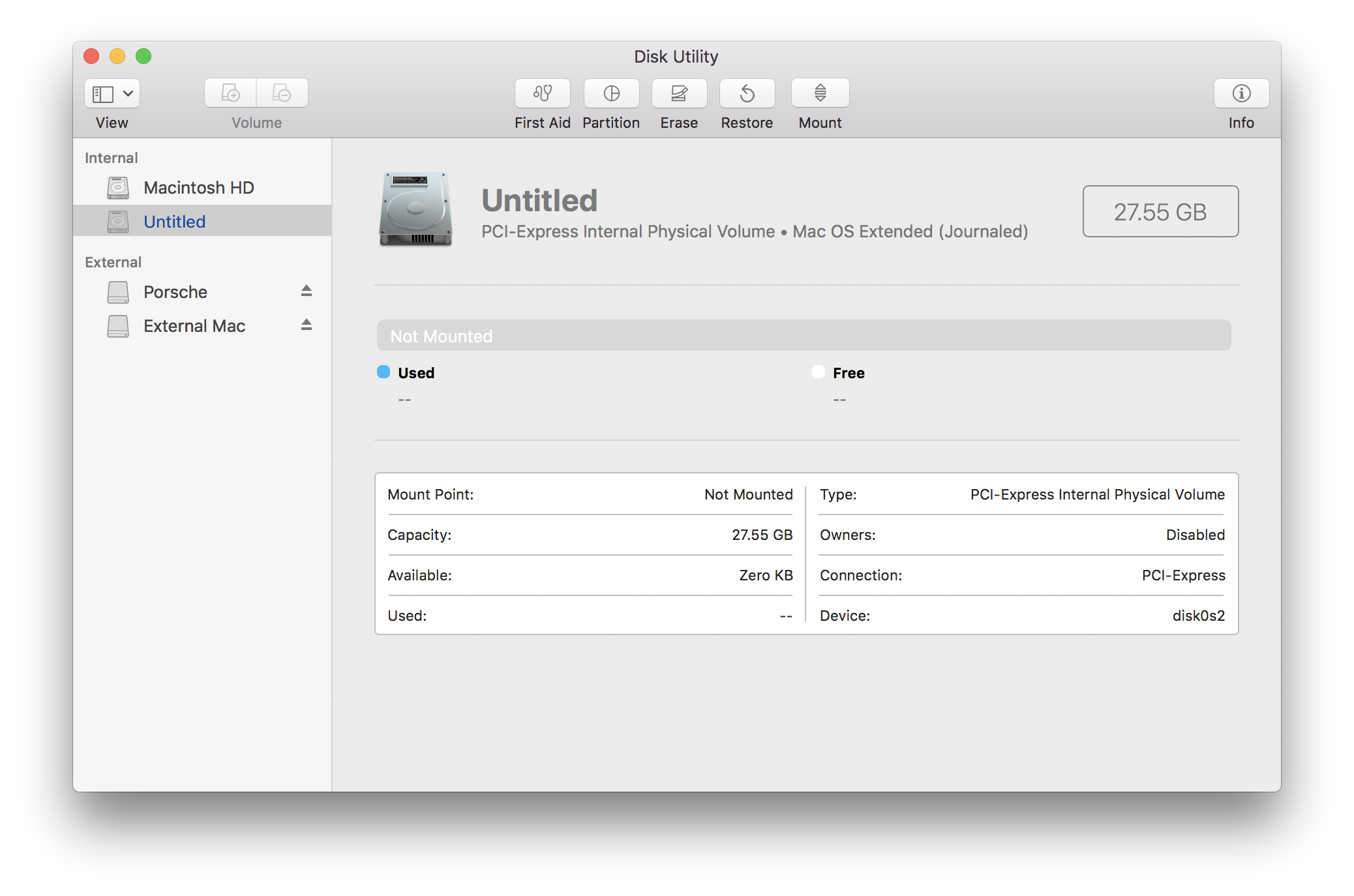

You sir are awesome. Not sure why I didn't think of the containers before. Though your solution didn't work perfectly I changed it a bit and got it to work. Basically I deleted the container, and drive through terminal. Because DU still would not do it. That gave me the ability to format the drive, and reinstall High Sierra. But now I have 2 drives. The regular Macintosh HD, and a secondary untitled drive. The untitled drive the PCI Express drive at 27.55GB. I am assuming that the the SSD portion of my Fusion Drive.
This is my first Mac with a Fusion Drive. Should I have installed the OS on the PCI-E drive? If so, can I now just use CCC to clone the working drive to the PCI-E drive, or would a new wipe and reinstall be necessary?

If you have a 1tb fusion drive, the SSD portion is too small (as you indicated above) to really put the OS onto. It might work as a standalone boot drive for a while, but I'm thinking it would quickly "fill up" and then wouldn't run properly.
I'll give you my advice on what to do:
1. Use either CarbonCopyCloner or SuperDuper (both are free to download and use for 30 days) to create a fully bootable clone of your current "working High Sierra OS" onto an external drive.
2. Boot from the cloned drive. NOW YOU HAVE COMPLETE CONTROL over the iMac's two internal drives, and can do anything you want with them (because you are booted from a totally-separate drive and OS).
3. Use either Disk Utility or terminal to erase both drives individually, to "Mac os extended with journaling enabled". I would run DU's "repair disk" function on each, as well.
4. Next, use terminal to "RE-fuse" the drives back into a fusion drive. (remember that HS does not use APFS for fusion drives, it uses HFS+)
5. With that done, open CCC (or SD) and "RE-clone" the contents of your external drive BACK TO the newly-created fusion drive.
6. That should do it. Reboot to the internal fusion drive and be sure to re-designate it as the startup disk in the startup disk preference pane.
