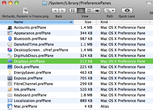

Hi pantoja,
the 'Displays.prefPane' is stored in: HD/System/Library/PreferencePanes.
You could've lost it by mistake. You'll have to re-install your OS.
Here is where it should be:
(To add: if you've another Mac, you can copy this & place it in there without reinstalling the OS.)
