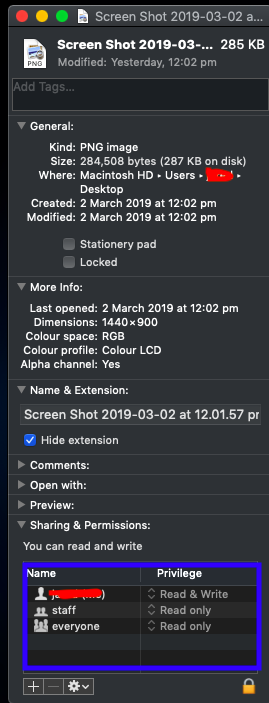

Sound like permission issue.. Check access access under Get info.
