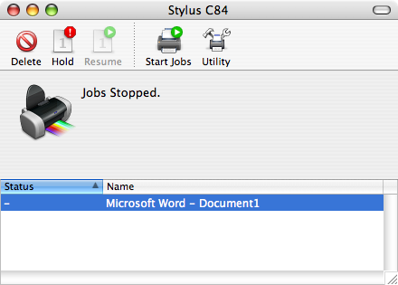

I'm on 10.3.6 and have an Epson Stylus C84 inkjet printer.
I want to print black text but the printer won't let me until I replace the yellow ink cartridge. Is there any way for me to get around this?
As soon as I try to print something the job gets stopped and no matter how many times I click "start jobs" it keeps stopping the job.

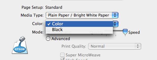

I have done it with a CX5400 (like a C84) and a CX6400. You need to go to Print Settings after you select Print... and change Colour (or Color even) to Black.
I've been doing that and it still won't work.
The jobs still keep getting stopped.

I have the exact same printer, and have experienced the exact same frustration. In short, it's not possible to print when a cartridge is out. Period. Sorry to do this to a fellow St. Louian, but your best hope if it's urgent is going to be finding a friend with a printer. :(
