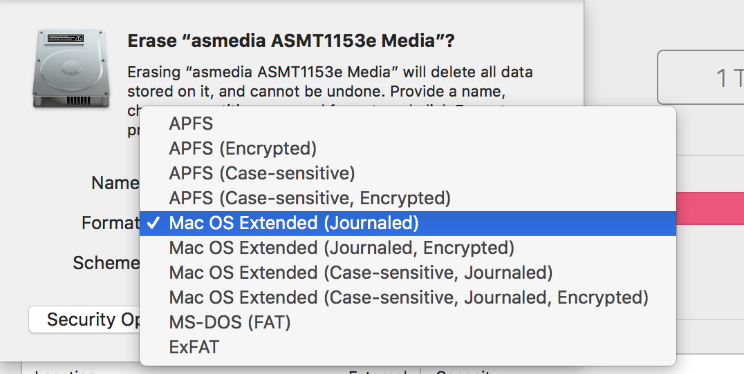

When you first erased and tried to do the clean install, did you format in APFS? If so, that is likely the issue. You need to format to HPS+ then let the installer convert to APFS after the included firmware updates are applied.

Well when I did the recovery with Command + Shift + R there was no option to format it in HPS+, APFS was all I could select.
It is there and I'm thinking you just missed it in the drop down. But if you formatted to APFS, that is what went wrong.
You would have wanted that Mac OS Extended (Journaled) choice in my screenshot. That is HFS+.
