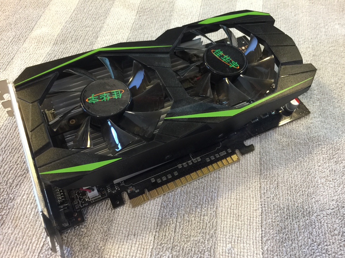

Hi everyone, and thanks for the incredible amount of info in this site.
This is my first post here, and ok, I'm a little worried. Because, let's face it, in the realm of GPUs I'm a complete newbie, so please forgive me for any inaccuracies in my post.
The situation: bought a year ago or so a GTX780 for my MacPro4,1 (in desperation flashed to 5,1, see below). Supposedly a bargain Amazon offer (and probably a PC card, too), but everything worked very well till I updated MacOS from El Capitan to High Sierra because of new requirements for Adobe Suite, that I use professionally and for teaching.
Obviously the card has stopped working. I tried (repeatedly)
- flashing MacPro firmware from 4,1 to 5,1
- installing new nVidia driver and CUDA
- following a lot of your posts on the topic
but all I have obtained is eternally repeating screen login if I use the nVidia drivers or a flickering, unusable screen with Apple ones.
Reading that Mojave should have native support for nVidia cards I tried to install Mojave onto another SSD, but I obtained only a black screen: Mac is working (I can turn off with the keyboard) but I see nothing. I was forced to go back to the old and crappy GT120, but some Photoshop's features are now disabled, and I need to explain them in my lessons, at least.
I know that probably the issue have been addressed in some of your posts, but I wasn't able to get a clear path to the solution. Now I read of someone flashing the ROMs to make a similar nVidia card work with a MacPro, and I'm almost to give a last try with this procedure. I remember I saw the necessary files here on a post, but currently I can't find them, hoping on the web.
I know that MacVidCards offer this service, too, but prices and shipping/flashing times from Italy are a bit too much for me.
Could someone please give some last advice on this issue? In the end, I know I'll probably move to a different card; AMD GPUs seem to have better support on Macs, but before throwing away the GTX780 I'd like to think I've tried everything possible. Just in case, any advice on the best AMD model for my configuration?

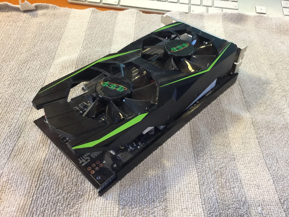

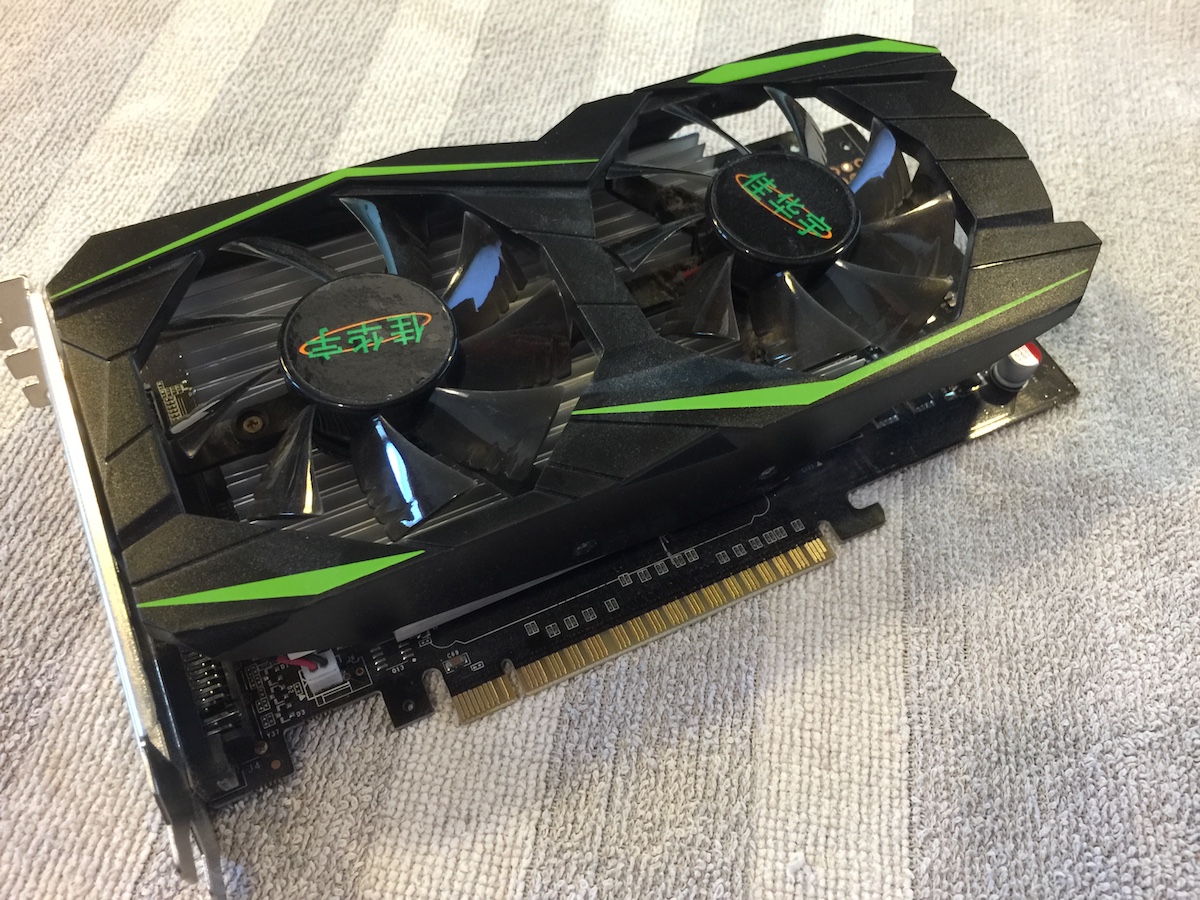

Hi, Project Alice, thanks for the reply.

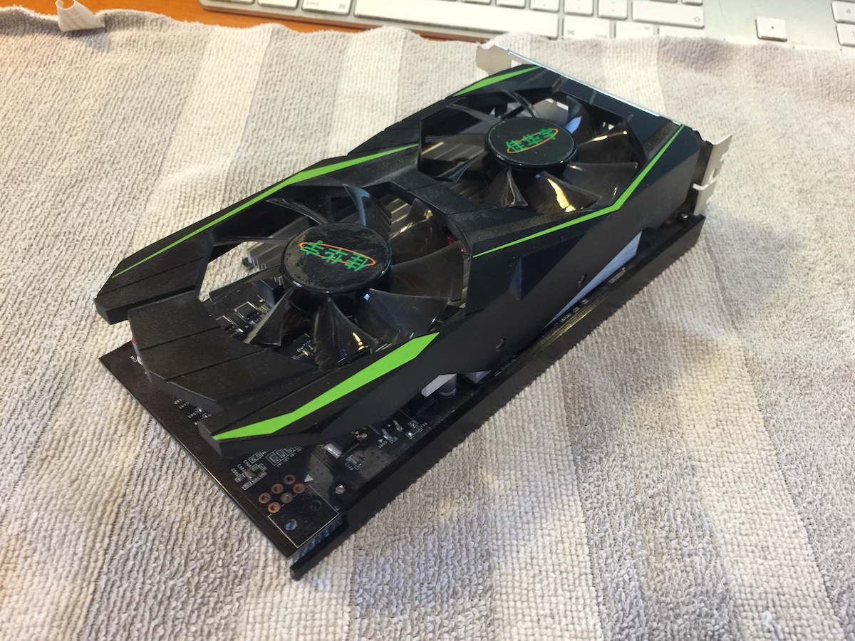

I think I have a regular GTX780, this is the hardware report from MacOS (sorry, it's in Italian)
NVIDIA GeForce GTX 780
Modello Chipset: NVIDIA GeForce GTX 780
Tipo: GPU
Bus: PCIe
Slot: Slot-2
Larghezza canale PCIe: x16
VRAM (dinamica, massima): 4095 MB
Fornitore: NVIDIA (0x10de)
ID dispositivo: 0x1004
ID revisione: 0x00a1
Revisione ROM: VBIOS 70.26.37.00.01
Metal: Supportata
No external power is applied, I found no slots for power pins on the card itself, apparently the GPU takes power from the PCI slot. I attach a couple of photos of the GPU.
And no, unfortunately I have no PC to test the card in.
Thanks again

This is not a GTX 780, it's a fake Chinese GPU.
A GTX 780 is a lot bigger and have at least two power inputs.

Since you wrote that it worked with El Capitan, it's probably a very old NVIDIA GPU, before GT 2xx, that was modified to represent itself as a GTX 780.
It's a fake GPU, besides sending it back to the seller or throwing it in the bin, the only thing that you can do is going back to El Capitan.

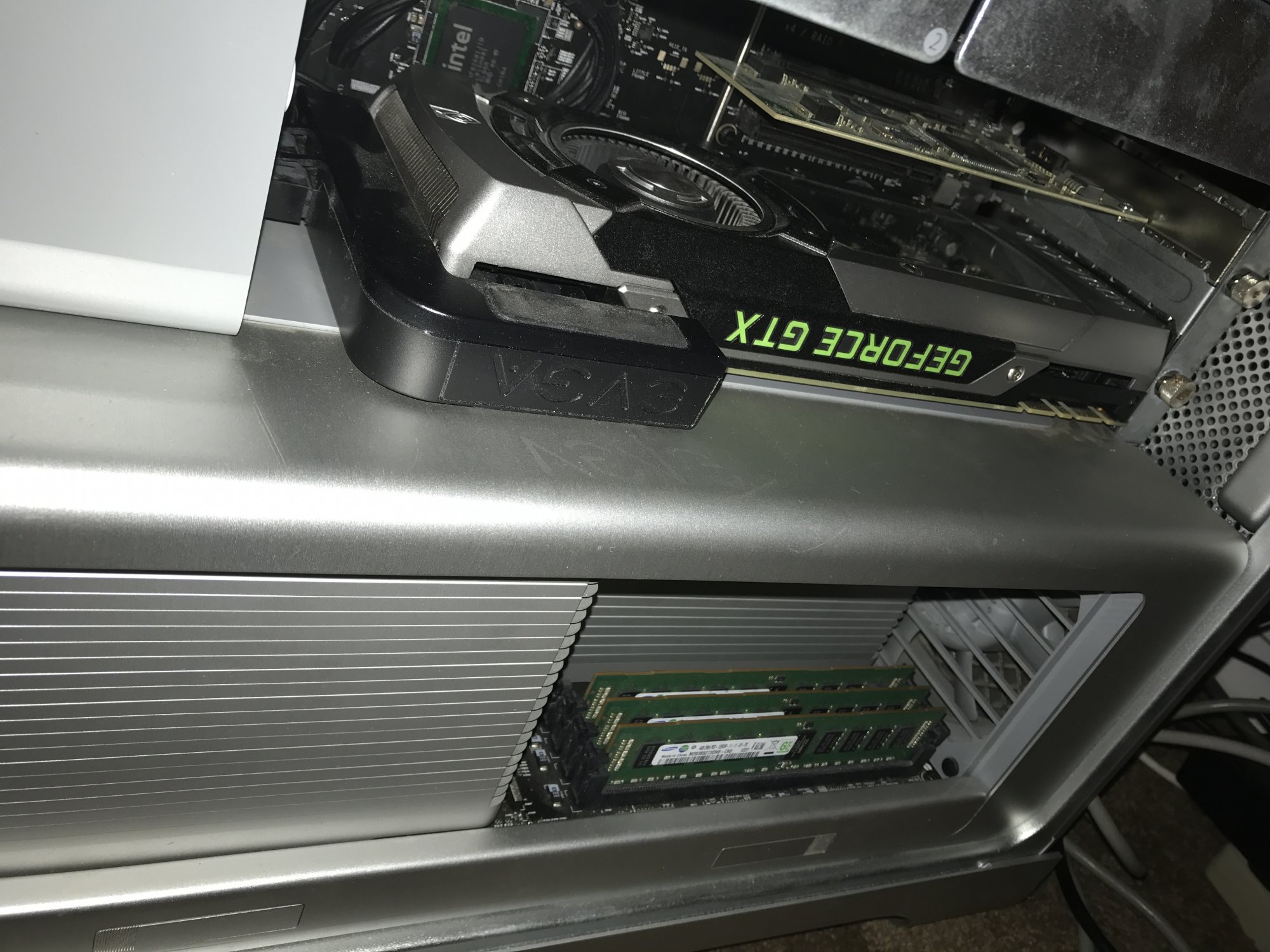

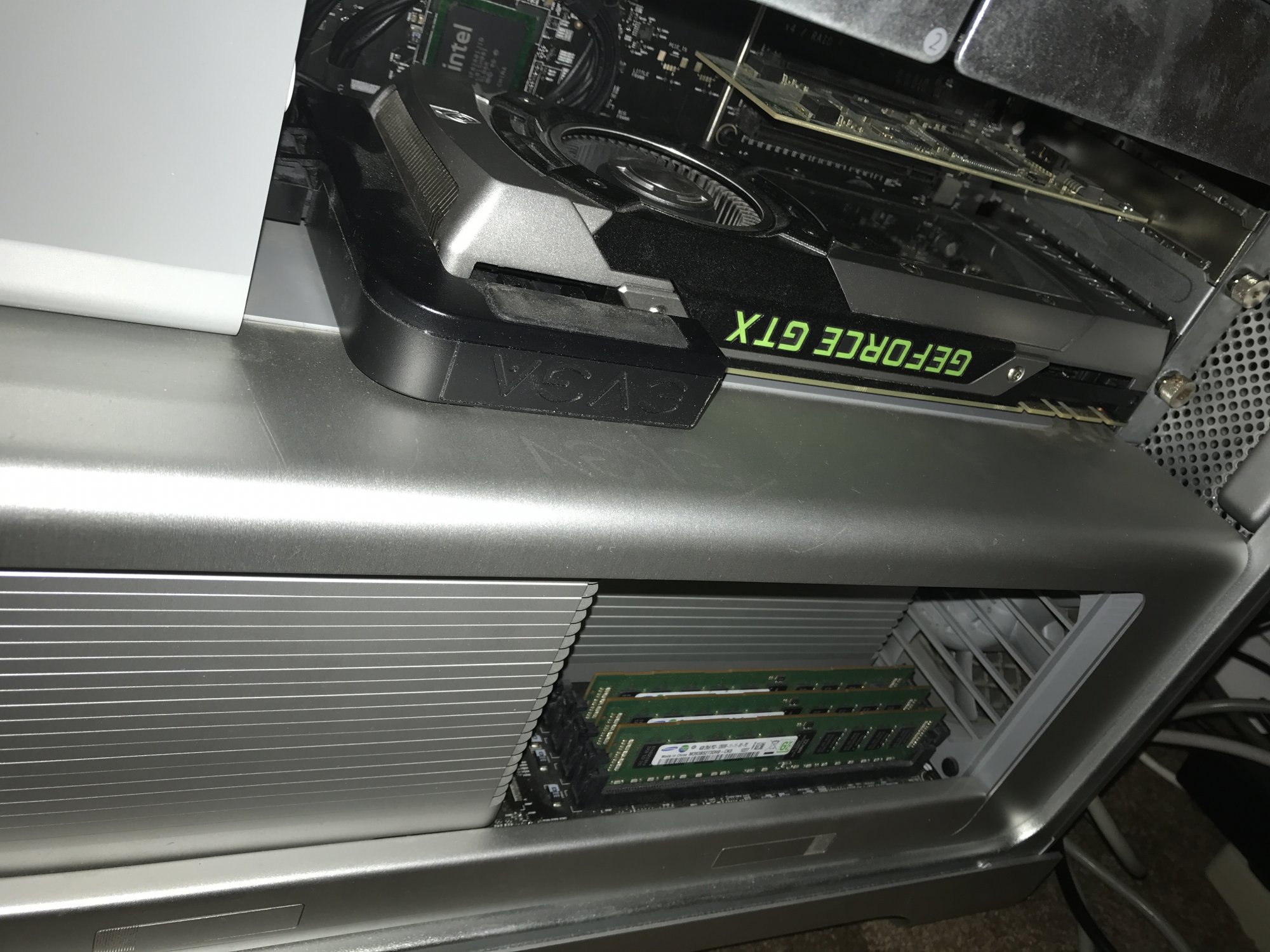

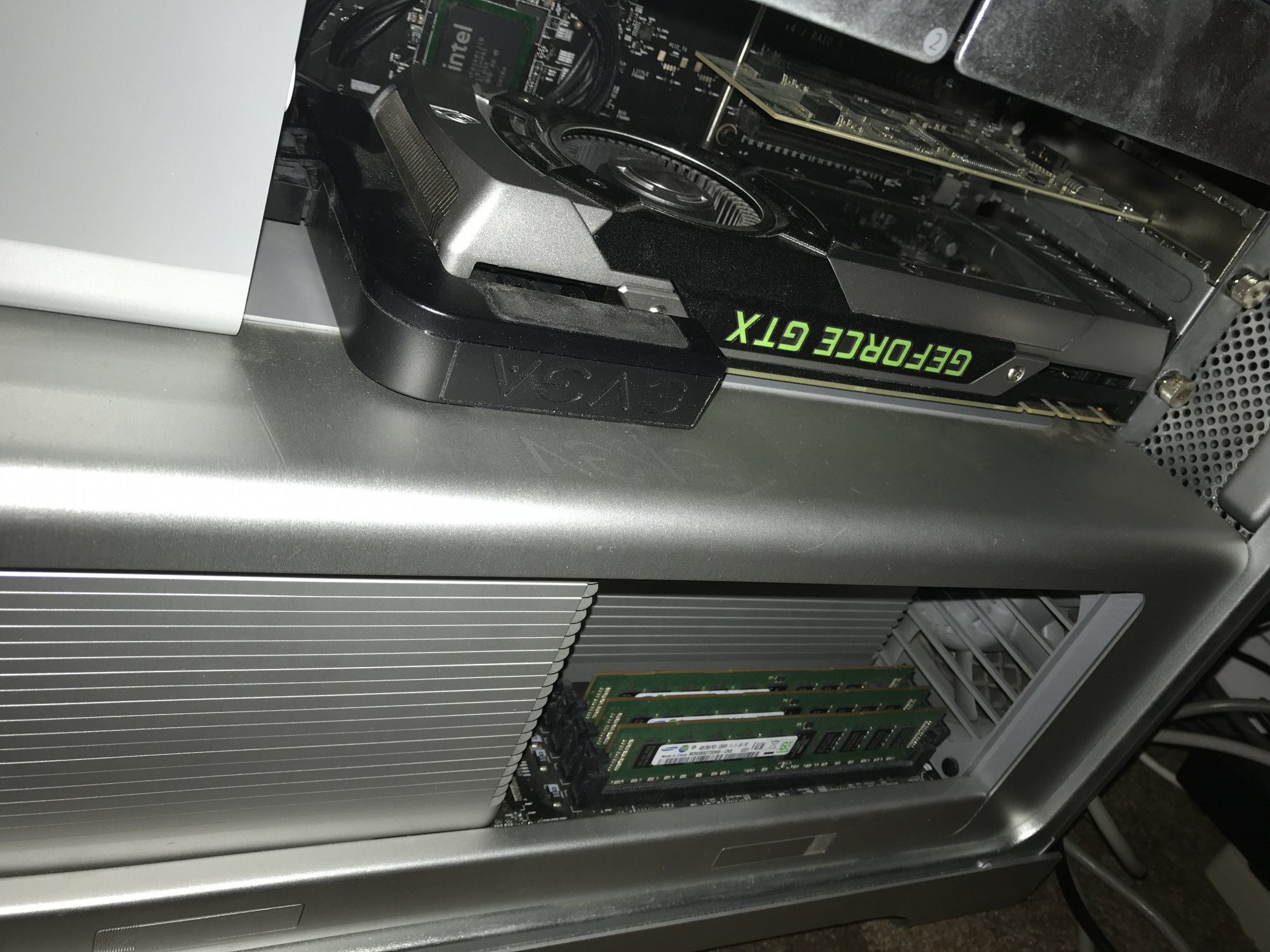

He’s right. Here’s a picture of my 780 Ti for reference.
Mine is the common EVGA blower style card, even if you had a different cooler from a different brand, a 780 of any kind will have external power.

That's a GTS 450 4GB card, belongs to Fermi (GF116-200-KA-A1), not Kepler. That's why it won't work in Mojave.
There are plenty of "names" for this card (all fake) from China, GTX780, GTX780Ti, GTX960, GTX1050Ti...... All from this same GTS450.
All these cards can ident themselves "correctly" (according to the fake names) in the OS, but of course because of the ROM is hacked / modded.

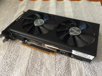

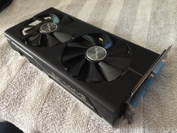

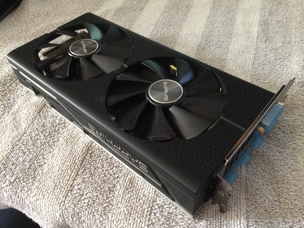

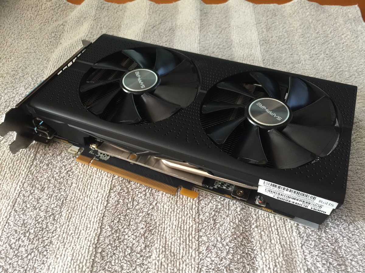

Hi again, and thanks again for help (and patience).
Just to be sure I'm getting what I ordered, this is the GPU arrived today from Amazon. It should be a Radeon RX580, I hope.
Now, looking on the web, I saw they mount it using a 2x6pin to 8pin adapter cable, not included in the box. The specs say that MacPro power supply should go out with a 900W, and I suppose I need that cable to get the card properly running, right?
I found this adapter on Amazon,
Is it what I need?
Thanks again

Yes that is the correct cable, two 6-Pin to One 8-Pin. Congrats and enjoy your GPU
Ok, everything's working like a charm:; Super easy installation, and voila, Photoshop's GPU acceleration in action, no more disabled features and most of all my graphic tablet now really follows my hand with no delay at all. Super!
Thank you all for invaluable support and hints.
